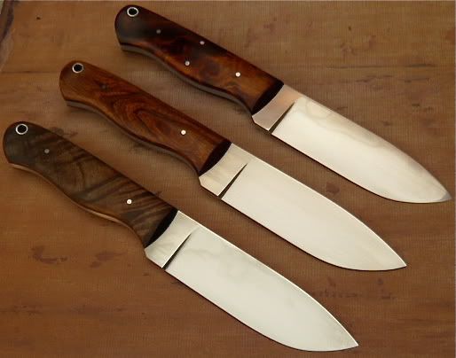

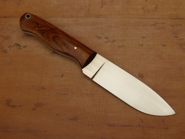

Hi guys,
Just finished an order for 3 simple utility knives. The customer is going to have his 3 young sons' initials and birth dates engraved on the ricasso (opposite my maker's mark.)
Thanks for looking!
Steel: 3/16" 1080 from Kelly Cupples w/ full height flat grinds
Finish: Hand-rubbed satin
Handle Scales: Desert Ironwood (2) and Stabilized Koa (1)
Fittings: 3/32" stainless pins, 1/4" stainless thong tubes
Blade Length: ~4" from tip to plunge
OAL: ~8 3/4"

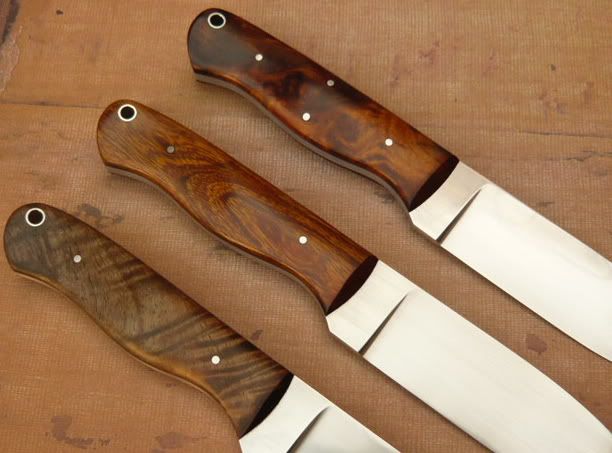

I keep coming back to see these, especially the one with the extra pins. If I may, to what grit did you take the handles, and how did you seal them? Whatever you did, it's really beautiful.
Thanks chainring!
I hand sanded the handles on all 3 to 1500 or 2000 grit (can't remember now!), and did a very brief buff with white compound...just a few seconds worth. I sometimes apply Danish Oil to Ironwood, but in my experience it tends to darken the wood somewhat and in this case it was already pretty dark to start with, so skipped it this time.
Hope that helps; let me know if you have any other questions.
