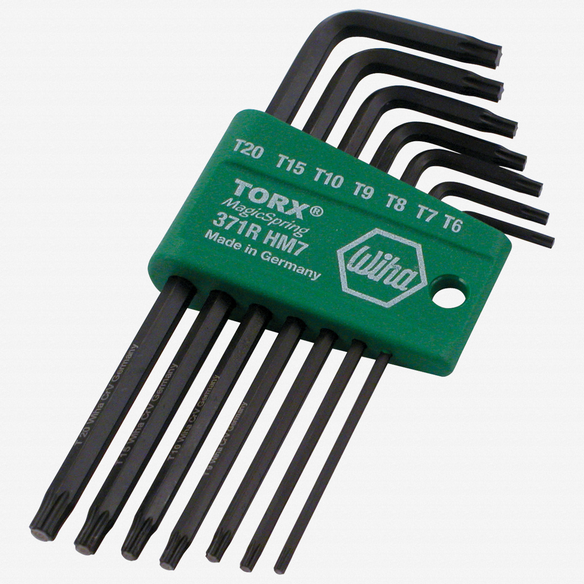

Great tip, thanks for sharing. I have a set of Wiha Magicsprings that work well with SS screws, but this should work with everything.
What is the smallest size TORX bit that utilizes the “magic spring”? Thanks!
I have the "371R HM7" set, basically covers all the torx sizes I needed for my folders. T20, T15, T10, T9, T8, T7, T6. Not sure if it comes in any torx sizes smaller than a T6 though.
