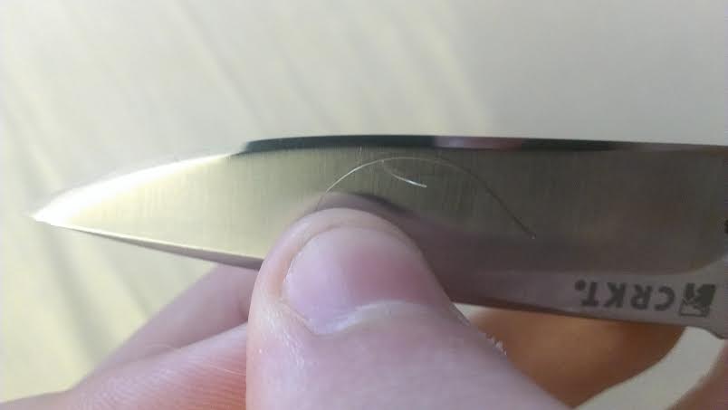

Mine came with a relatively obtuse edge, and it was very thick behind the edge. I had to remove a good chunk of material to get the bevel down to a reasonable angle, but after doing that the edge is fairly sharp. Sorry for picture quality, I have dropped my cell phone directly on the camera lens a few times :o
If I were betting, I'd first suspect a wide/thick factory edge angle. That's real common, especially among mass-produced and less-expensive knives in cheap stainless steel. Combine a wide/thick edge with steel that may be somewhat soft (again, common with cheaper knives), and the apparently 'sharp' factory edge may just be essentially a burr sitting atop edge geometry that's too thick to cut well. The 'sharp' burr folds over quickly, and cutting performance drops off a cliff. If attempting to 'fix' it by re-sharpening to the same factory edge angle, and following by stropping off the 'sharp' burr, not much may result in improvement.
First thing I'd do, is re-bevel to 30° inclusive or lower (make sure of the angle). At this angle, the edge geometry should always cut well, assuming the steel itself is decent (grain size fine enough, and heat-treat good enough). Bad steel or bad heat treat can't hide anymore, if the variable of the wide edge angle is first eliminated. At the very least, cutting performance should improve in the short term, leaving only the durability of the edge (steel, heat treat) in question; using the knife for a while will determine if the steel quality and/or heat-treat is good enough to keep it durable.
Heck bpeezer, I think that is a pretty good pic, my standards aren't super high though.. My ripple came the same way, and I had to reprofile it, widening the bevel a lot in the process--it's been a great slicer since I took it to 15dps.

Thanks Fish! This is really my biggest issue with CRKT, they seem to consistently make their knives too thick behind the edge. I'd like to see a shot of the ripple at 15dps, I bet the bevel looks pretty wicked now.
