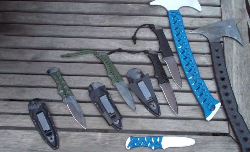

I have an M48, which I was contemplating how to re-wrap the handle in a better way, and was wondering--has anyone ever sprayed truckbed liner onto handles of hawks, knifes, or any other weapons? Results? The M48 handle is so slick. It'd be nice to make a better grip without necessarily using paracord.
