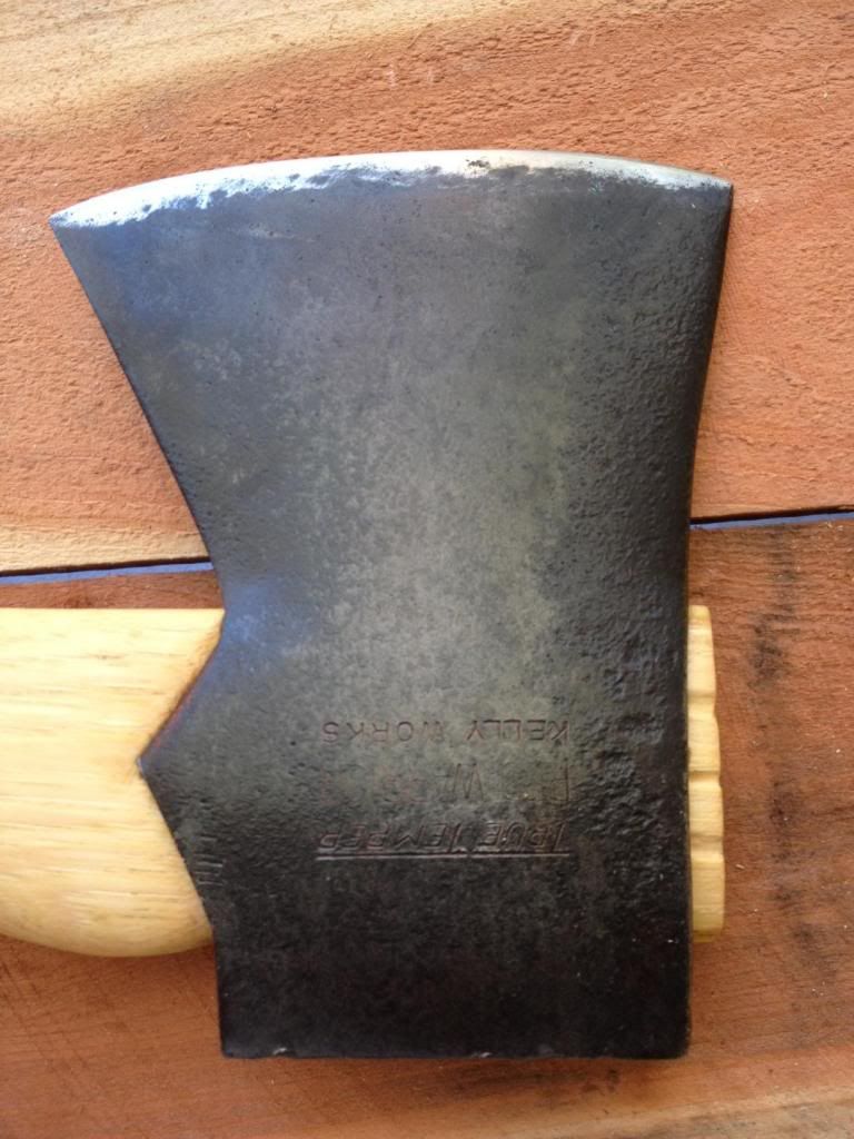

Ok, I must say I now have a thing for Jerseys.
I just scored this off ebay, and now waiting for new 32" haft.

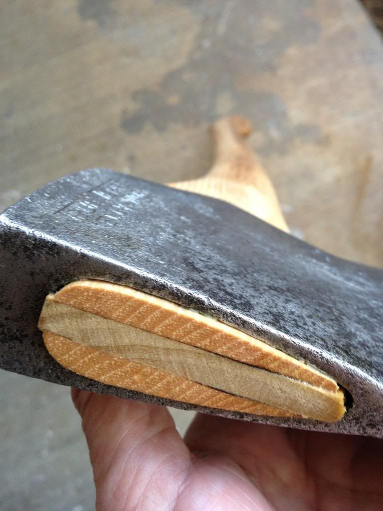

I'm really not sure where to get "good" handles, so I just ordered one off of Amazon, and that's what came in the mail. I really like the combo too.
When I order from Amazon I'm just hoping not to get a handle that's too "thick" like a baseball bat. I was happy with this one, just needed a little work.

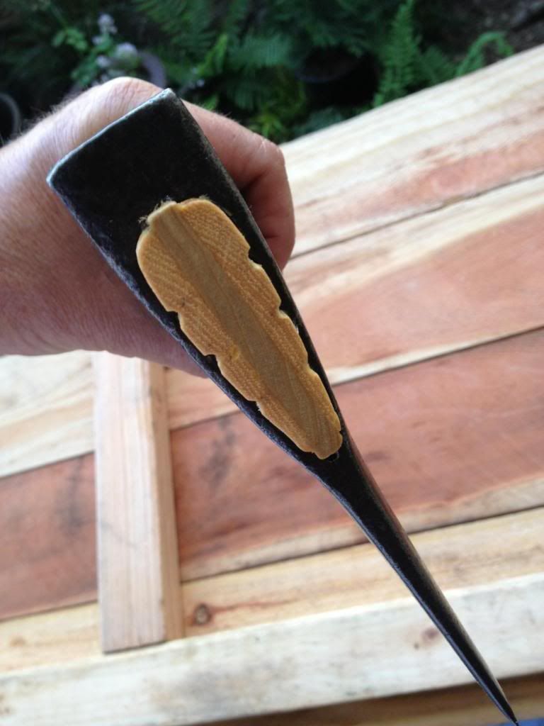

Nice! Have to agree on the Jersey love... I'm up to 3 of them now (bluegrass on a 32" curved octagonal, keen kutter on a 28" straight octagonal, and a TT kelly perfect on a 35" straight)
Your True Temper head is actually closest to my Keen Kutter oddly enough (my favorite of the 3): a very thin bit with just a slight convex/high centerline. My other Jerseys have a much more pronounced centerline, requiring a banana grind and a good bit of cheek filing to thin out. The profile lets it just bite incredibly deep into softwoods (what I mostly deal with) and it has just enough of a centerline to prevent sticking.

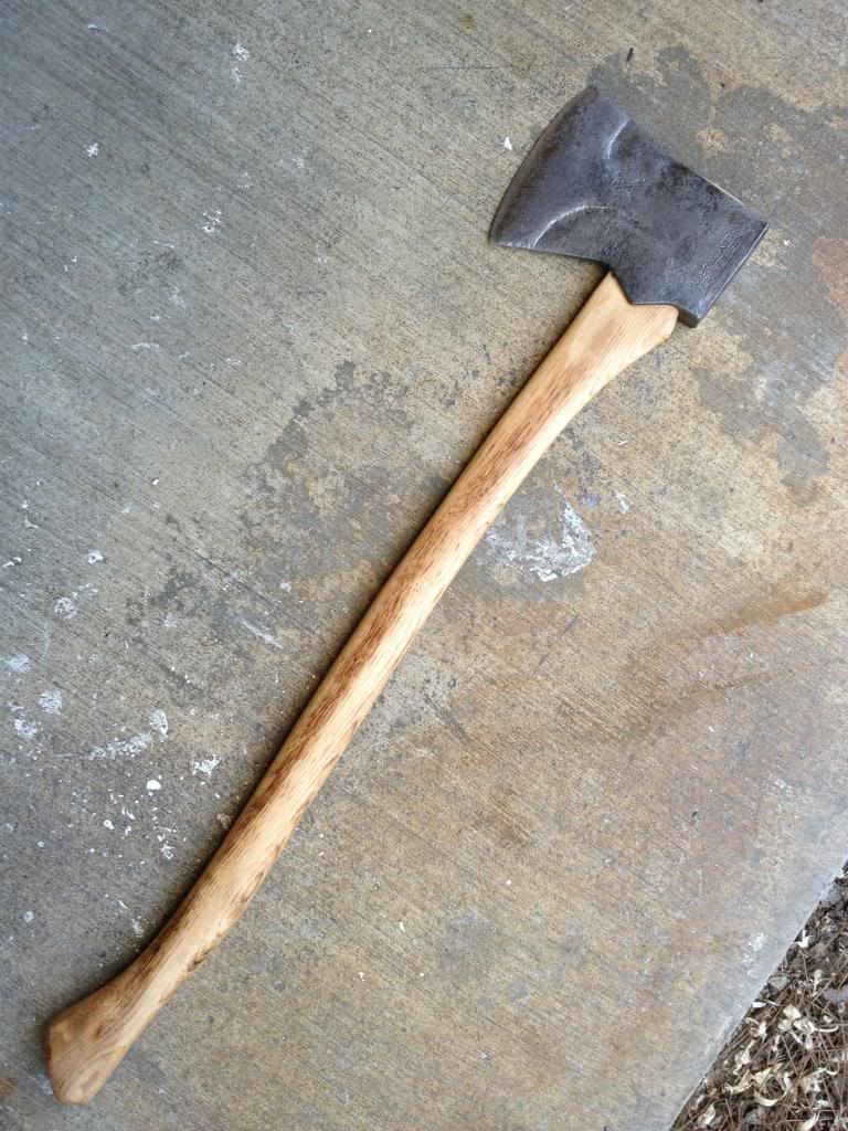

NICE! Here's my other "jersey", my first hang and the head is a little rough...4lb. True Temper Kelly.
