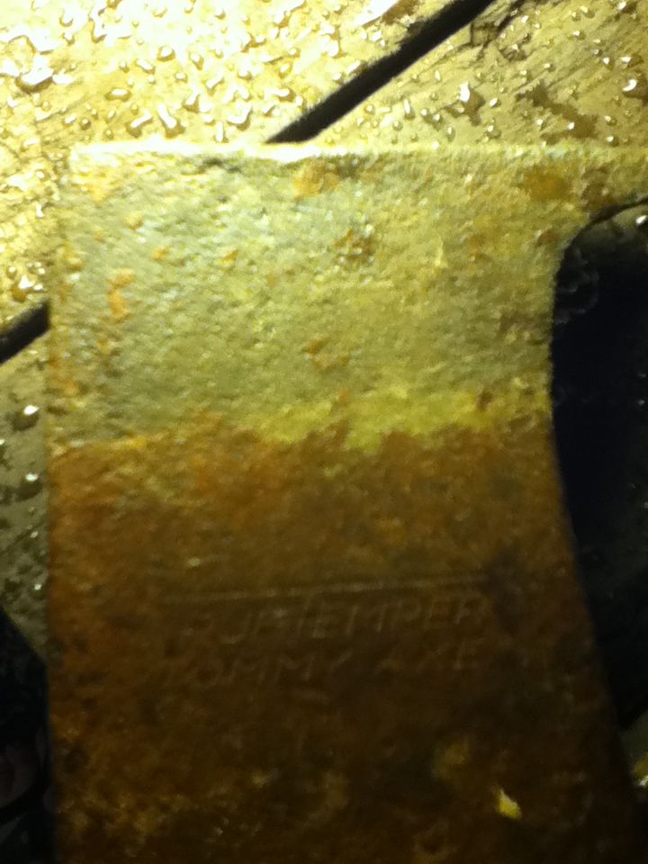

Or maybe a Dynamic? I'm not sure if the have hardened polls. And their poll surface is smaller than the Tommy. Cooper modded a Tommy and removed the puller fangs.
de-fanged Tommy axe which is the same as a TT Tomahawk.
