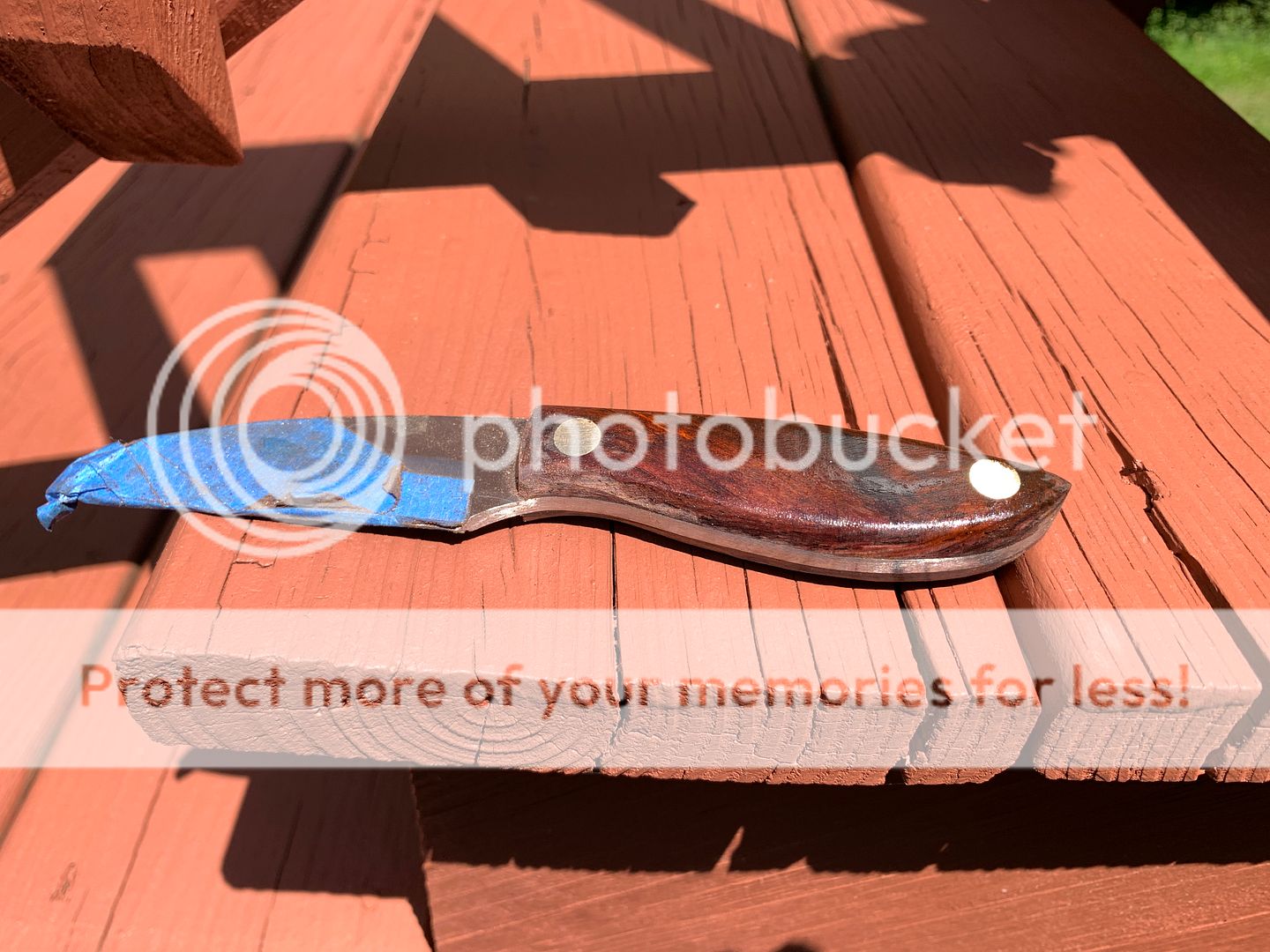

This is todays cocobolo wharncliff. I’m trying to stay down to one but addiction has me bad
This is just spit. Its still hot from grinding. The heat sets up the epoxy too.

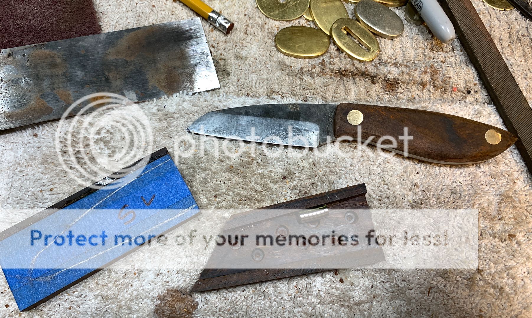

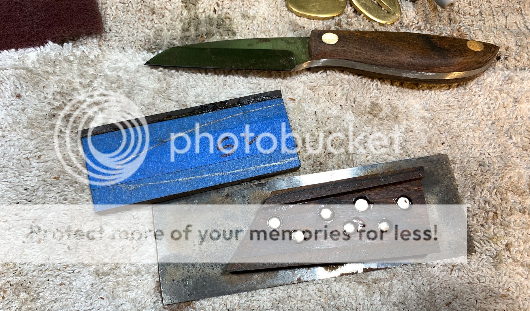

Coming together. Cocobolo. So dense it won’t take any sealer. Only thing that works is white buffing compound and bring a chair
Cocobolo is easily polished by hand sanding to around 800-1000 grit and then lightly buffing by hand with a soft cloth, or on a slow dry buffing wheel ( maybe just a tiny charge of matchless pink).

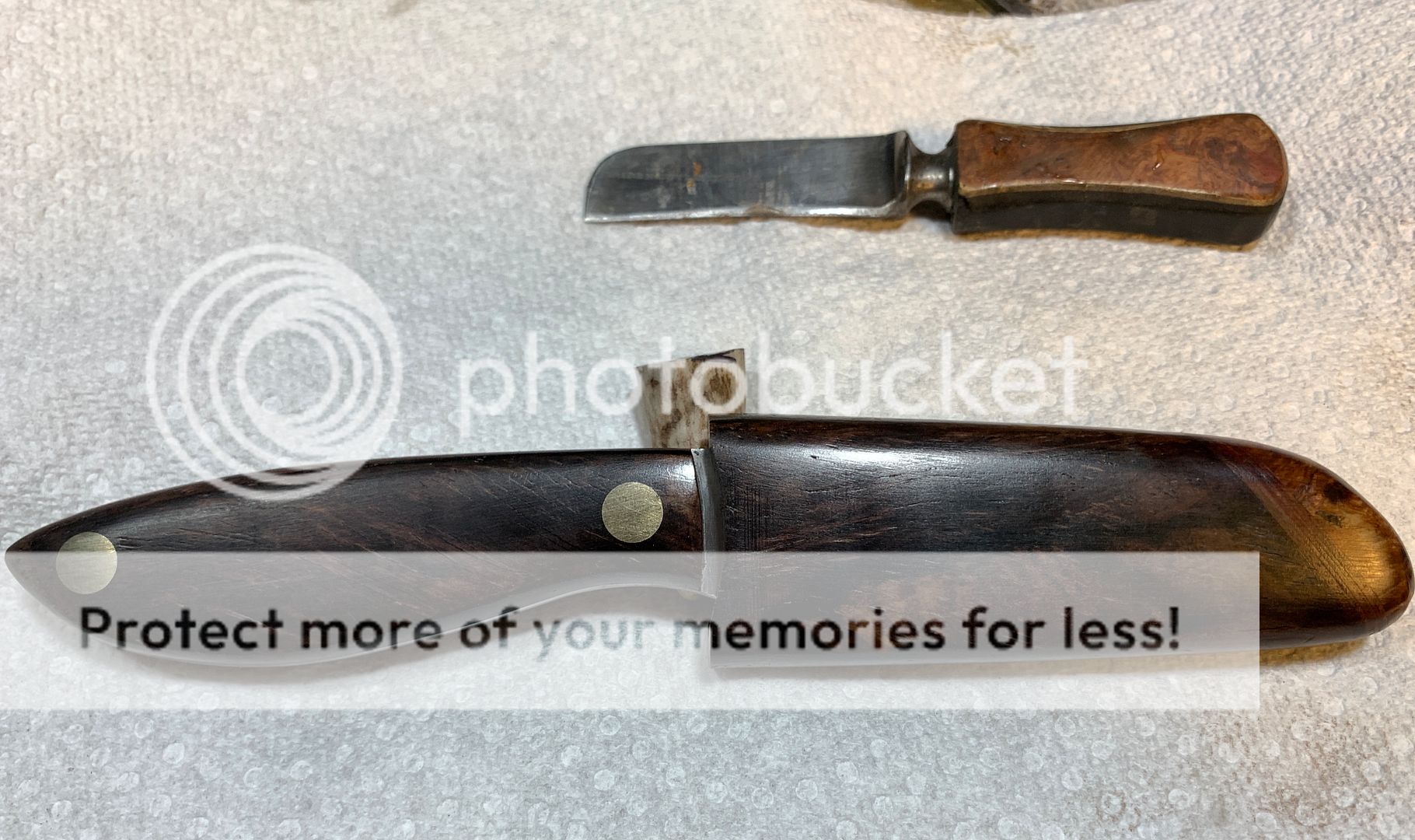

Still needs a few hours of hand sanding and buffing. Made the scabbard tip out of Amboyna burl. Trying to darken it up to better match the cocobolo. Going to try burgundy aniline dye next. Also need better radius on scabbard where handle sits
The only word that comes up is stunning. Absolutely stunning
