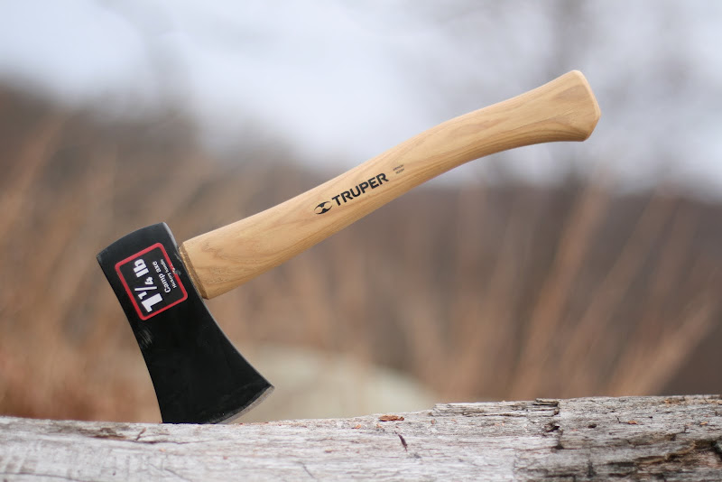

This is yet another low cost axe that I have been waiting to review for a while. It seems to be available at every Home Depot that Ive seen, so I thought people might want to see something about it. This hatchet exemplifies what people mean when they say hardware store axe.

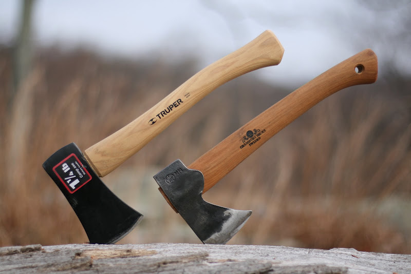

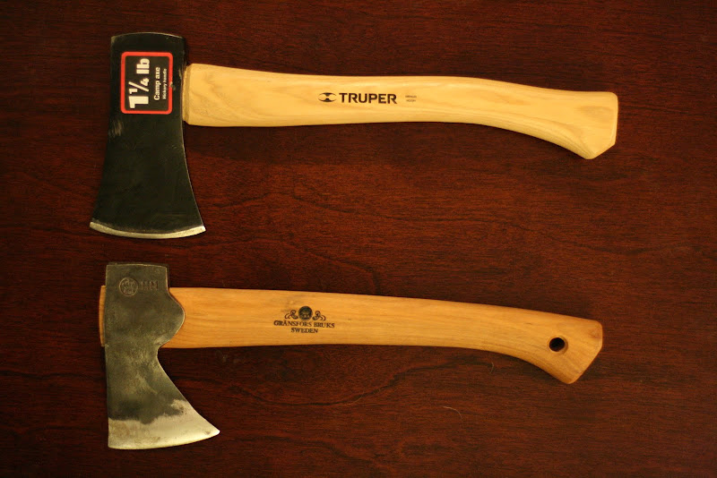

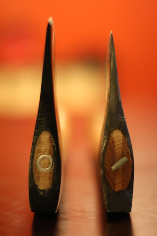

Like with my other hatchet reviews, I will be comparing the Truper Camp Axe/Hatchet to the Gransfors Bruks Wildlife Hatchet. Here you can see the two of them next to each other.

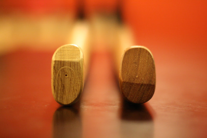

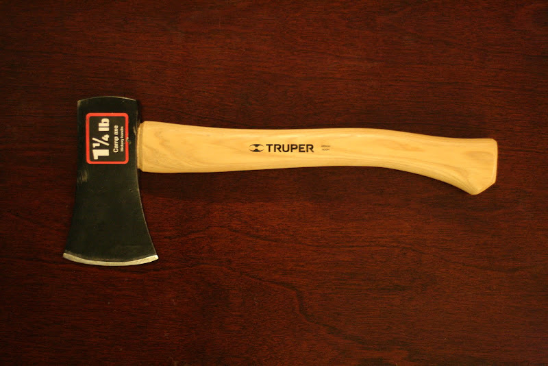

The handle is the same length as the Wildlife Hatchet, bringing it to about 13.5 inches. It is comfortable and well shaped, although it has a bit too much polish on it. The grain of the Truper hatchet was perfect. It is as good as the gain on the Collins axe was bad.

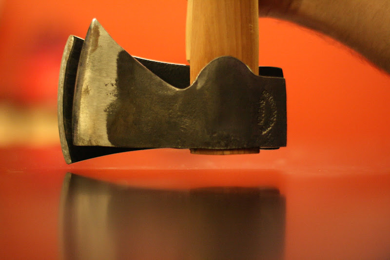

The head of the Truper Camp Axe is heavier than that of the Gransfors Bruks Wildlife Hatchet by a quarter of a pound. The overall shape is not bad, but the convex of the cutting edge is way too thick. With a lot of time and effort it can be reworked since the cheeks are not too thick, but I am not sure it is worth it.
The head is attached to the handle using a wooden wedge and a circular metal wedge. It held securely during the testing. For the tests I sharpened the hatchet, as it was completely dull when I bough it, but I did not re-profile it in any way.
When it came to performance, the Truper Camp Axe fell far behind the Wildlife Hatchet. The thick cutting edge limited the ability to penetrate the wood, and copping ability suffered even though the Truper hatchet has a heavier head than the Gransfors Bruks one.
With respect to splitting, the Truper did quite sell. The same characteristics that limited its chopping ability, made for a good splitter. The thick edge and added weight, put it in the lead as a splitter.
Overall, this is what I would consider a hardware store axe. It is not good, but its also not particularly bad. If you are looking for a hatchet that you can abuse around the backyard, and can double as a hammer in the tool shed, then this is a perfectly good choice. With respect to bushcraft however, it leaves a lot to be desired. Even for this money, there are better options out there. The thick cutting edge, makes this tool hard to use as an all around hatchet. It is not an easy fix either. You would have to remove a good amount of metal before you can get any kind of performance from this axe.
