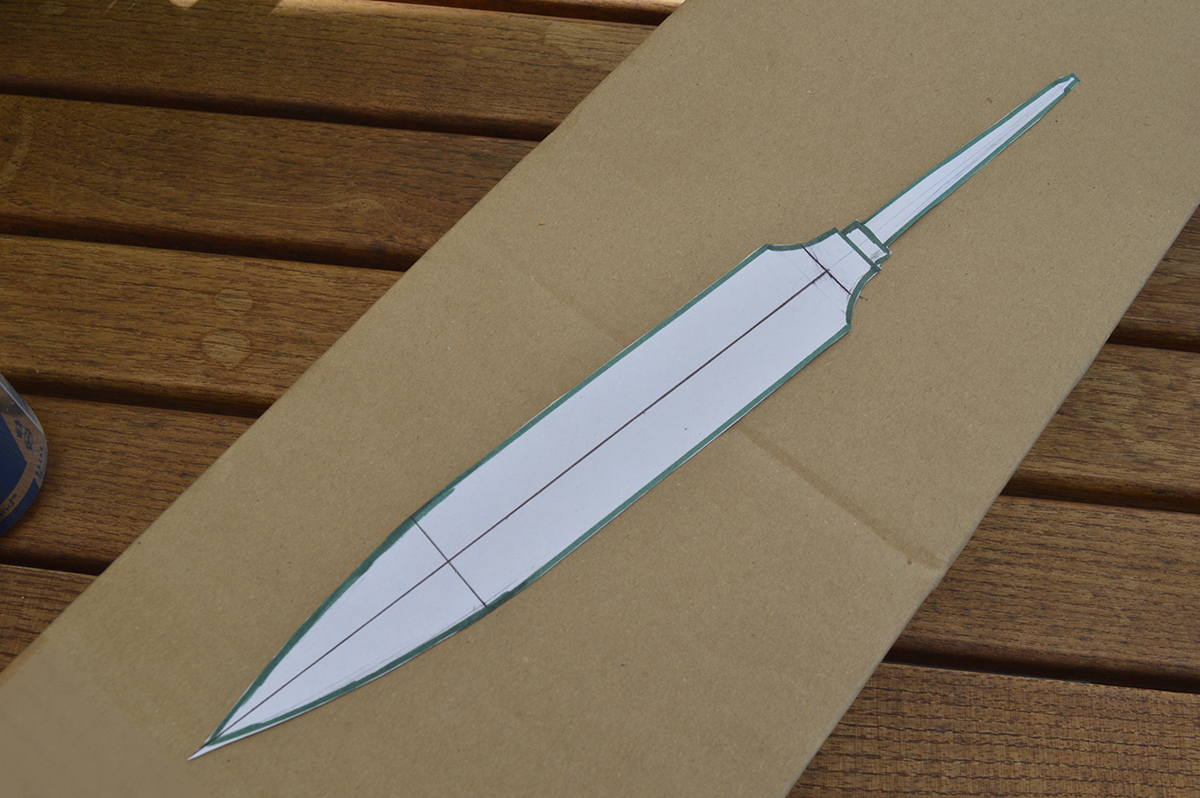

First of i started with a skecth and traced out what i need to cut
making it out of 1095 steel because i wanted to give it a nice hamon at the end

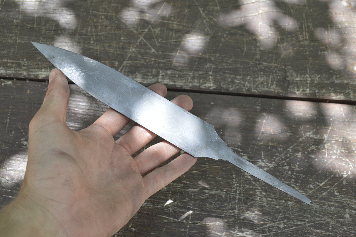

Blank is cut out and ground do shape
I really wish i could forge my own blades and hopefully someday i'm able to, but for now i gotta do the stock removal method

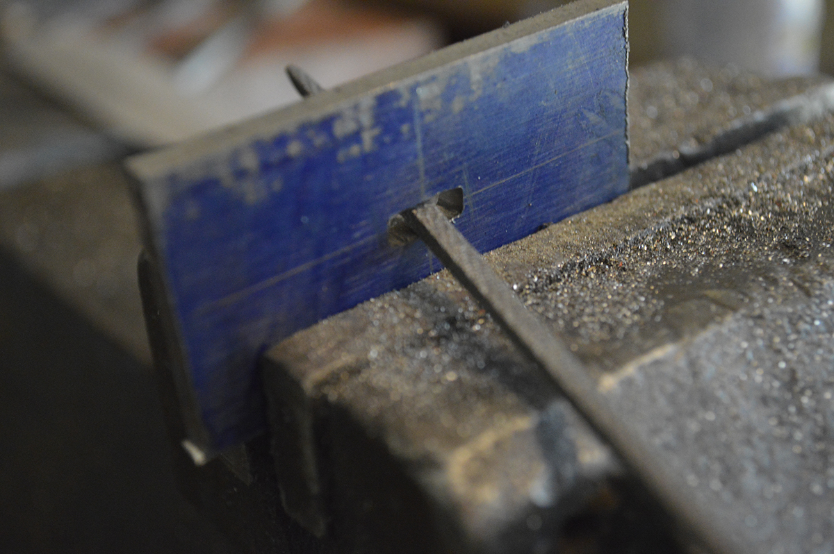

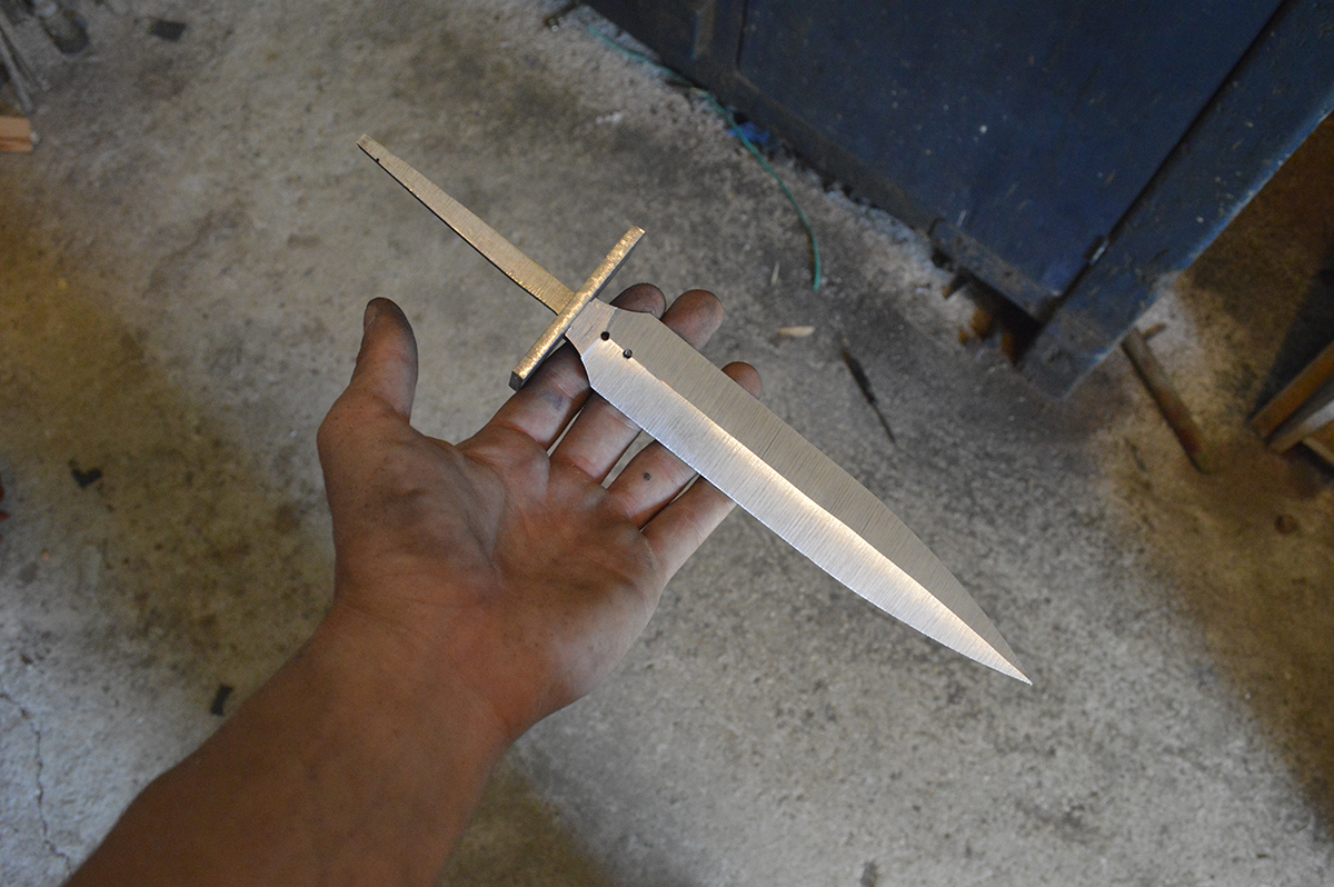

Here i'm making the hole to fit the guard
going with Titanium
decided to do this process before the heat treat
Fits nicels

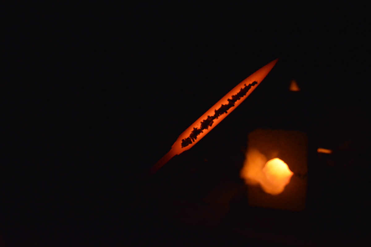

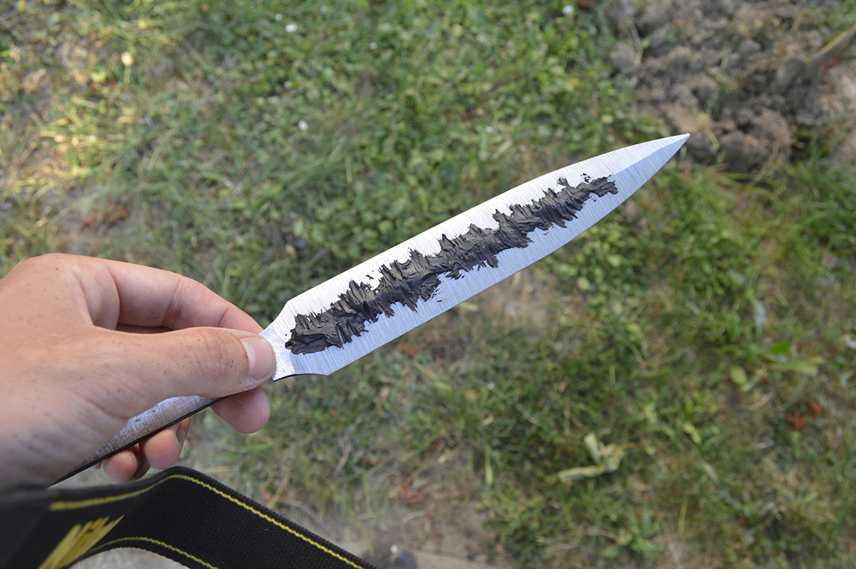

Ready for heat treat and hopefully a nice hamon is gonna turn out
(fingers crossed)
