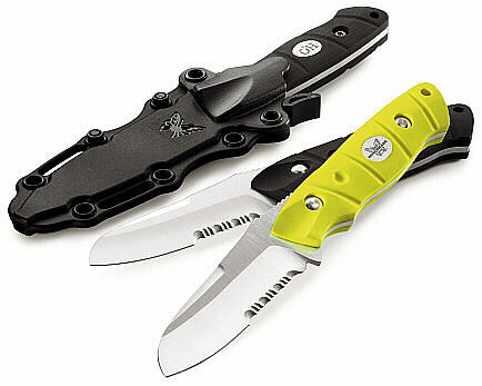

Looking for a good saltwater knife and came across this one , the yellow folder from BM. Can anyone tell me if it is still being made? Went to website and did not see listed. Thanks.
The knives in the pic are fixed blades. If you want a folder look up benchmade 551H2O or benchmade 111H2O. Or google benchmade H2O and you should see all their marine environment offerings.
Sadly the fixed blade no longer comes in this style. Only a big hook. Thanks, though.
