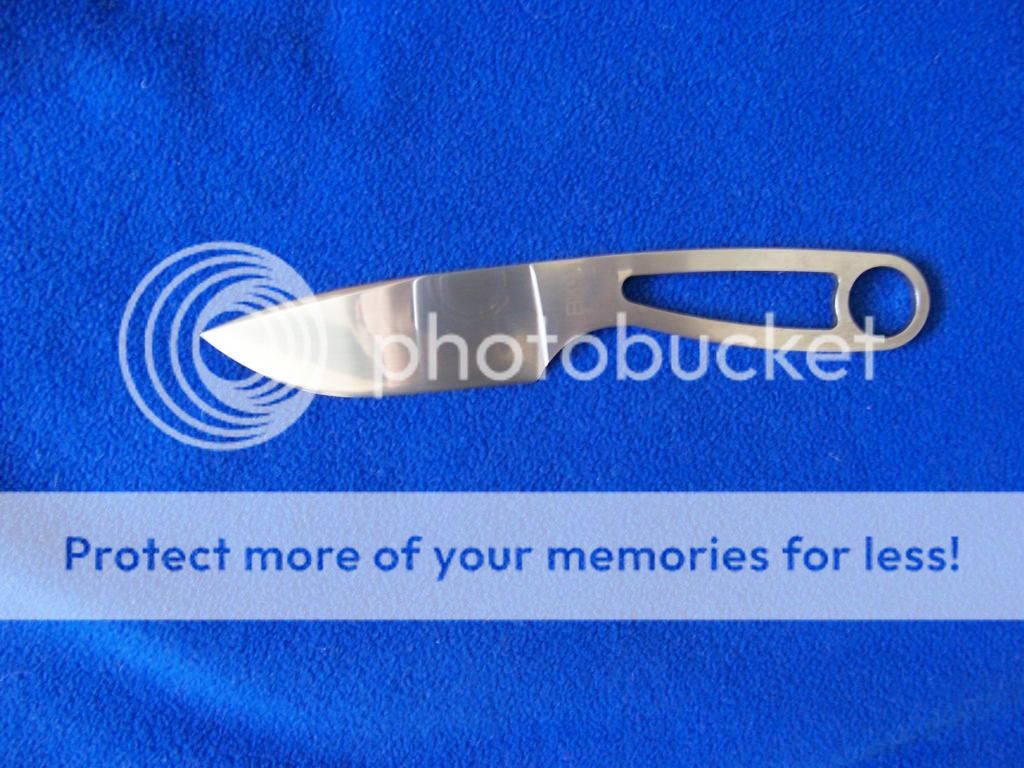

Here's my BK11 way back when....
Just follow the guidelines posted by Jonny1280 and you will be fine. I would add something I learned from Nick Wheeler's videos about sanding. I sand in three directions. Lengthwise from the plunge line to tip, at a 45 degree angle from the spine and lastly 45 degrees from the edge. I start from the plunge and work my way to the tip. My final polishing is only lengthwise from the plunge to the tip. Be certain to mount the knife securely and work carefully. You don't want to round off any edges or the tip. The sanding block insures the polished surfaces will be true. The goal is to remove highs and lows as well as all tool marks and then impart the satin luster or high polish.
