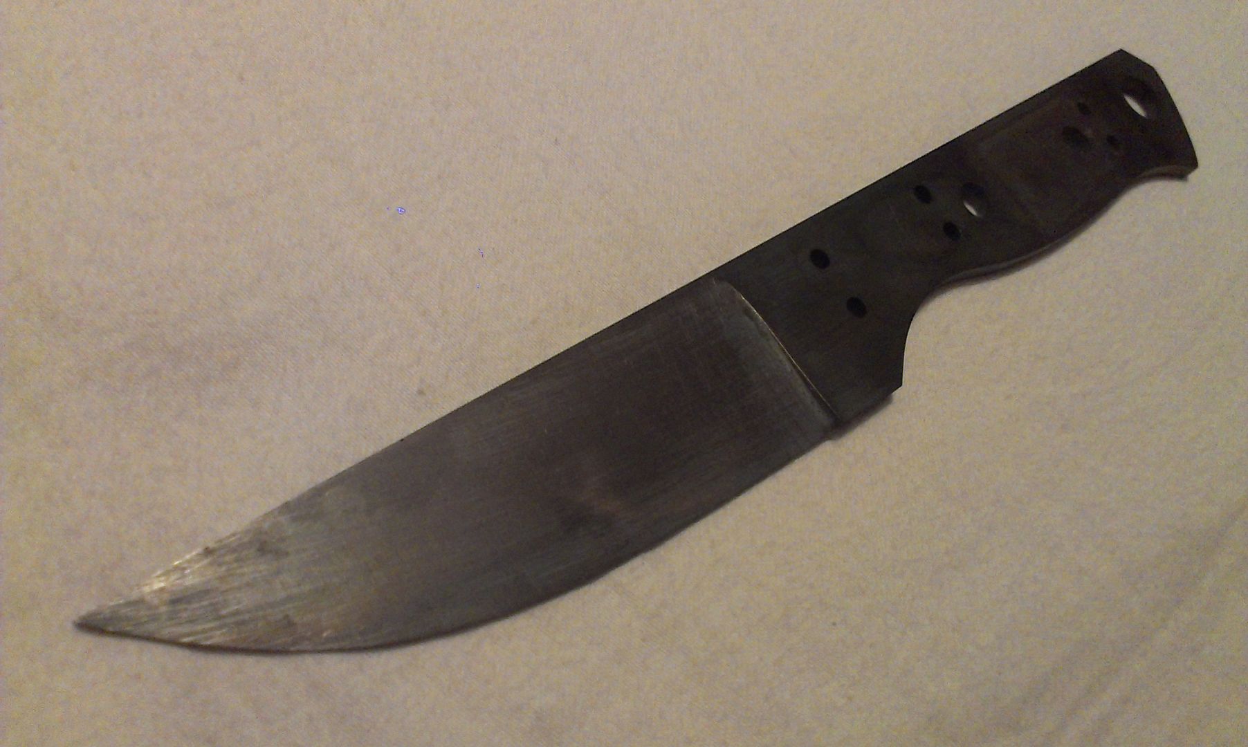

I am not sure how this happened. I have a ten yr old daughter that loves my knives so maybe that explains it. There is rust ( from hand oils ) and scratches on the side of the blades. I've taken 2 different grit buffer wheels to this thing with jeweled rouge ( it sure did shine up) but the scratches are still there. Any ideas?image.jpg

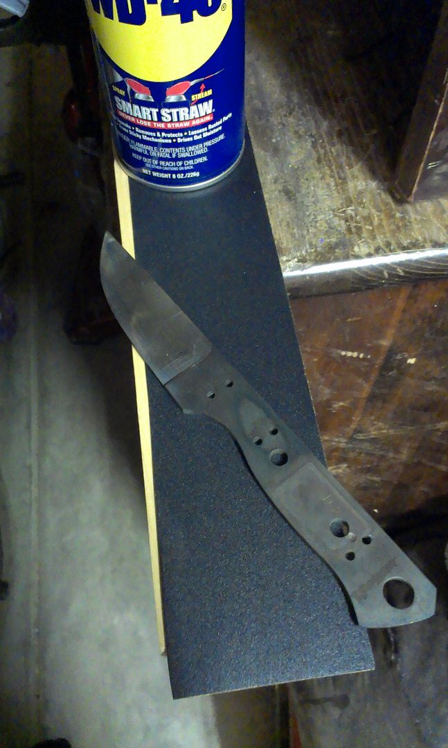

Is that a flat grind? If so light spray glue (on the back of the paper, just for tack) or otherwise secure 400 grit wet/dry sandpaper to a bar of steel or hardwood (flat!) then rub the blade flat against the paper. Be careful at the plunge. Use a bit of wd-40 for better cutting on the paper. Use fresh paper.

Picture is not very good, but it appears that the blade was originally finished in a cross-wise direction, and your attempt to remove the rust was in a length-wise direction. That contrast made it worse instead of better.

Well I attempted 400 grit wet/dry paper. Didn't do anything to the scratches. Went to 220. Same thing, no dice. Scratched the $&*% out of the blade. But the scratches are plainly there underneath.
