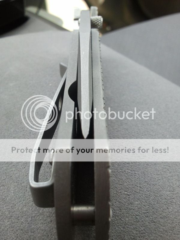

Been really enjoying this one the last few weeks:
The thing is that it is not perfectly centered and I would like it to be. What to do?

Loosen the screws on the handle just a tad then flex the handle each way till you get the blade dead center. While holding the handle flexed you tighten the screws. Should be perfect now
So loosen all the screws, not just the pivot? The shimmy the blade over? Then tighten all screws while holding blade in place?
Is this all while the knife is open or closed? and how do you use two screwdrivers and hold the blade in place at the same time?
Sorry, I am still new at all this....
