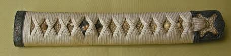

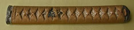

Possum, If you think wrapping with traditional ito or paracord is a bitch, give string wrap a shot. Probably 10 times more frustrating than any other wrap. Check with any Tsukamakishi and price a string wrap compared to any other style, it will give you an indication of the difficulty.
It is a beautiful wrap, but generally only seen on higher class blades or the owner was very fond of the piece and or wealthy.
Here is a closer photo of one, look at the detail and imaging keeping all those threads in perfect order.
I bought some jabara-ito to do such a wrap as it's truly the most elegant. It's got two strands that are in opposing twist. You are supposed to sew the two strands together. You have to make 4 of these pairs (3 pair in that tanto)...!!:eek: I got about 4 feet of sewing into the first pair and thought... geezz.. I can't afford to so this just for beauty and interest's sake and I'm sure no one would pay me enough to do this so I put the silk away..
It's incredibly ornate and I am more amazed at this style now that I can see the immense effort put into it...
