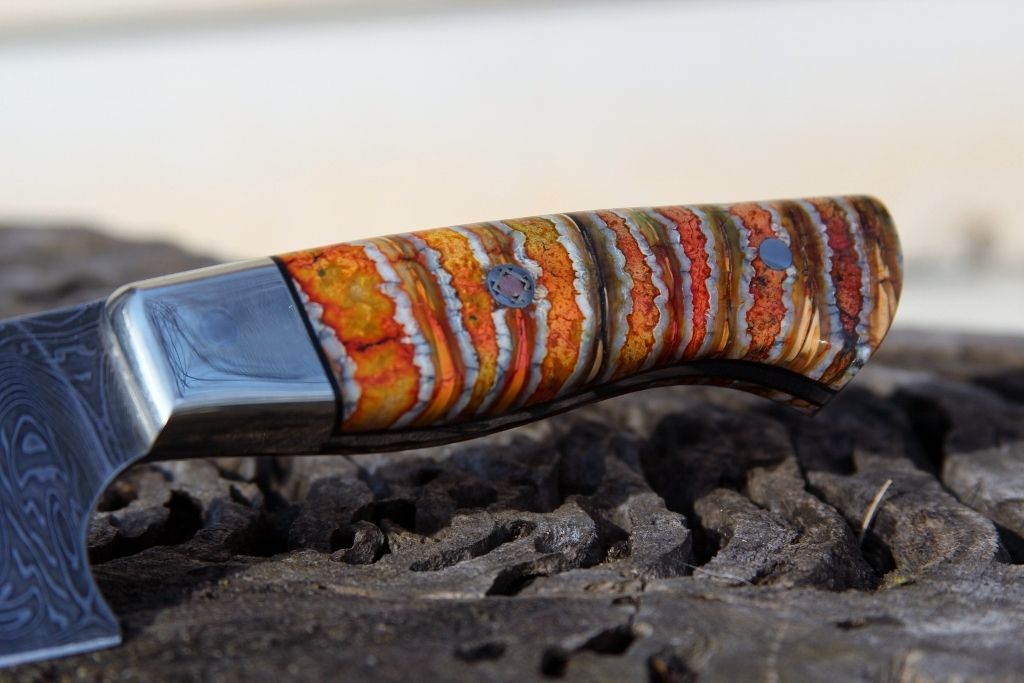

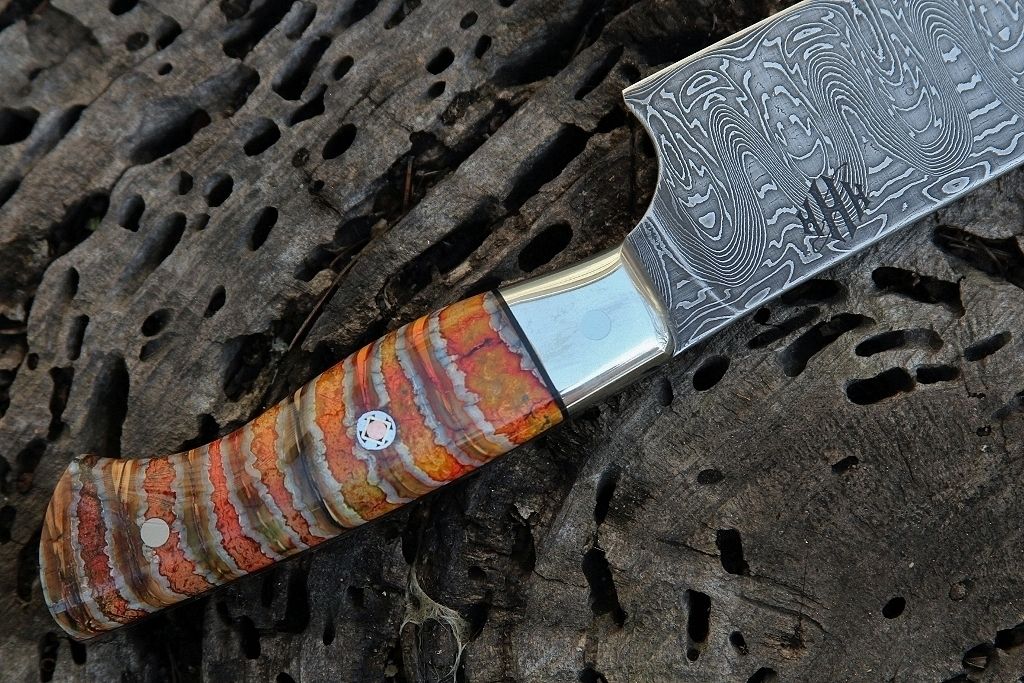

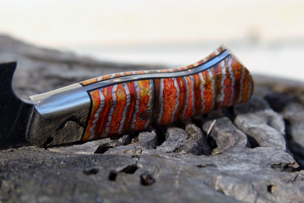

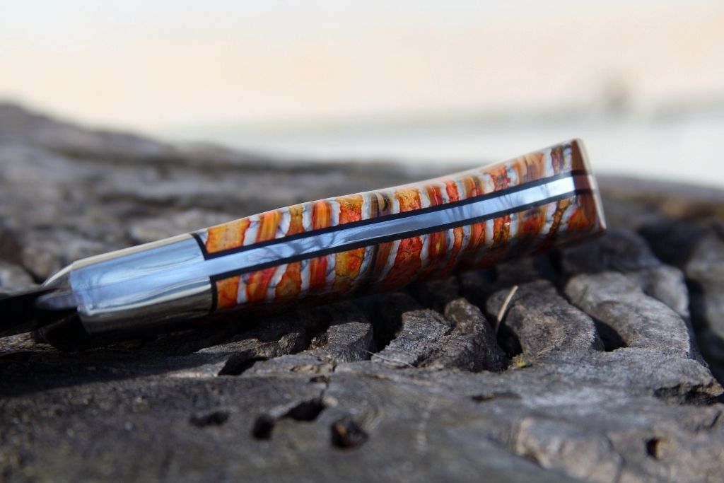

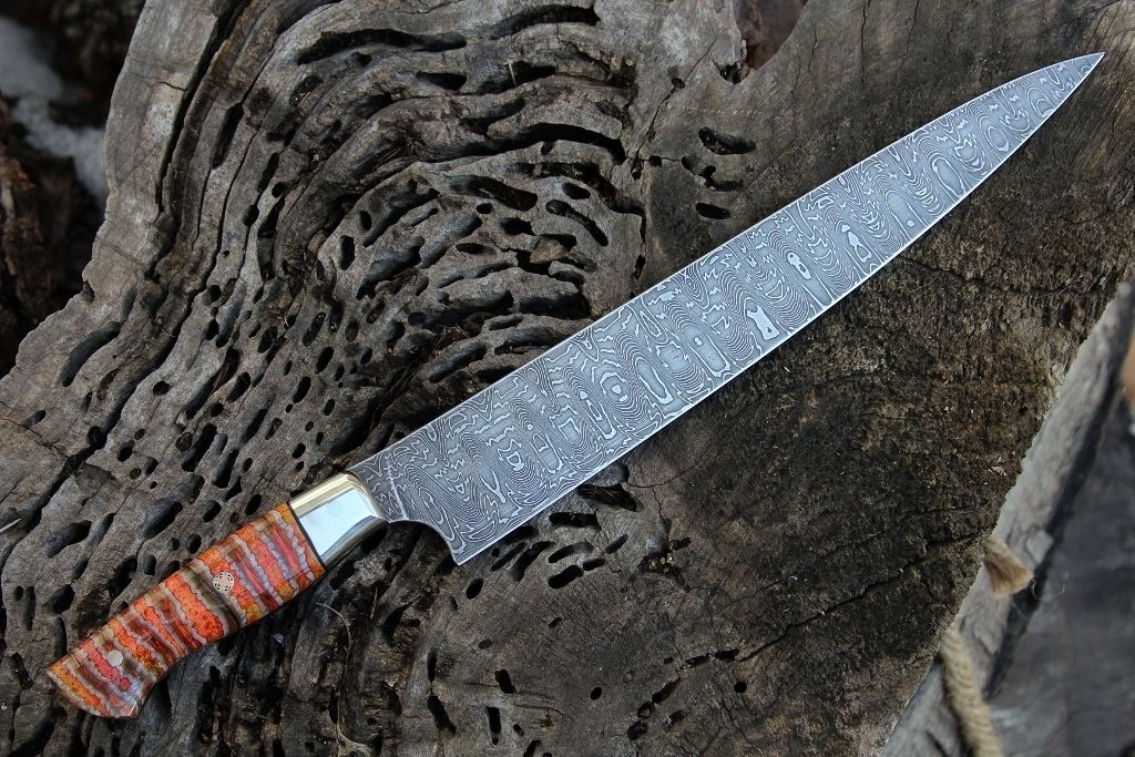

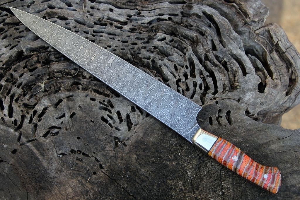

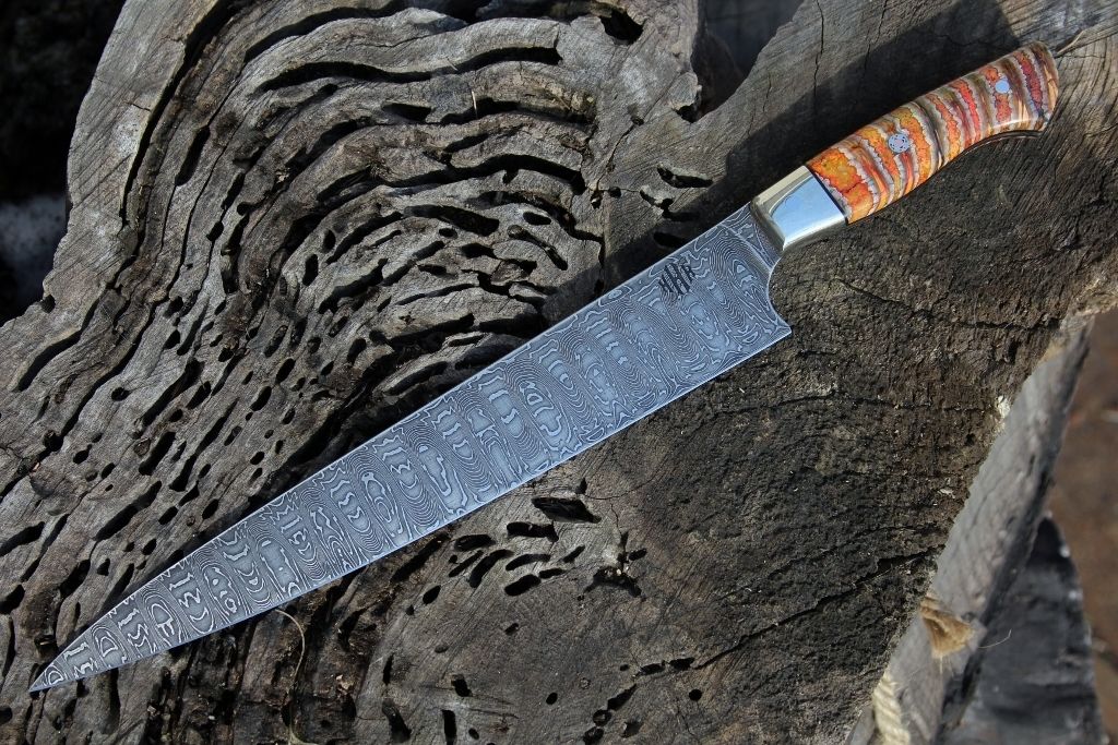

Hello and thanks for checking out the post! This one just loved the camera and I was able to get some great shots so I loaded a bunch for ya all to look at.

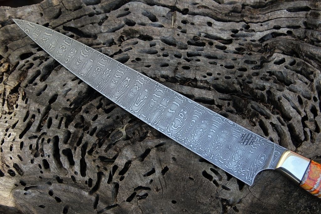

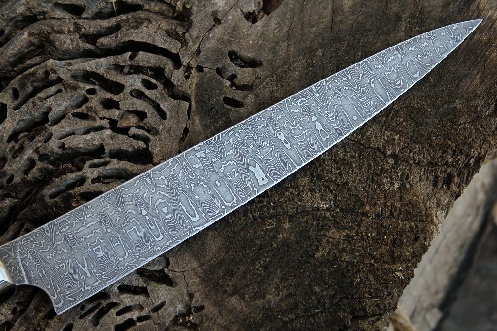

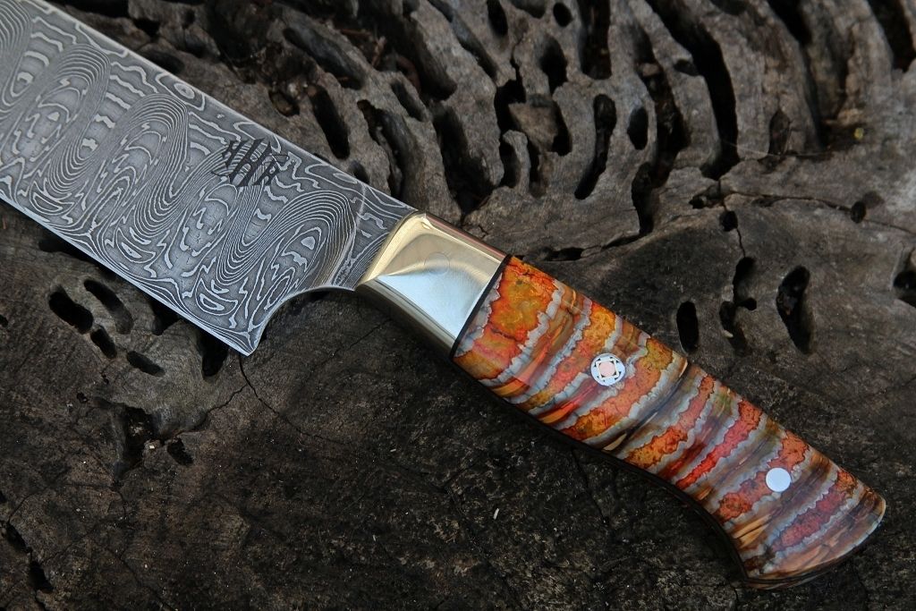

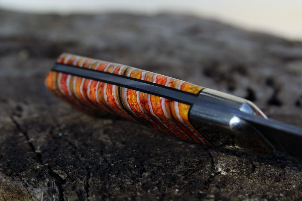

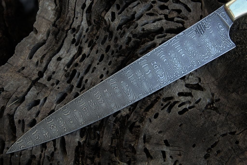

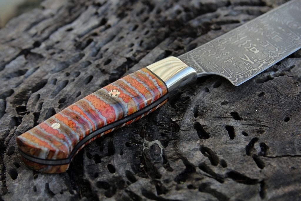

This 270mm Suji has a beautiful Tsunami pattern damascus blade.. Its sporting Nickle silver bolsters, with some very cool orange and yellow. stabilized mammoth mammoth tooth.. I used stainless pins, both on the bolster and the rear of the handle, and added a single mosaic pin.
As the bolster ages the stainless pin will be more and more visible.. Which I'm sure will be sweet looking after it gets some love!
The specs are as follows.
270mm blade tip to heel.
45mm tall at heel.
2.3mm thick tapering to the tip.
OAL. 15.5" or 394mm
Weight 9.5 oz.
Balance point is right at the plunge line. just in front of the bolsters approx 1/4"
As always, comments and critiques encouraged and welcomed.
God Bless YA
Randy
Another beautiful piece, Randy. I might be concerned a little about the mammoth tooth in the hostile environment of a kitchen. I find kitchen cutlery gets dropped more than others. Not a problem if the user is careful.
Gorgeous, just the same. Thanks for sharing.
