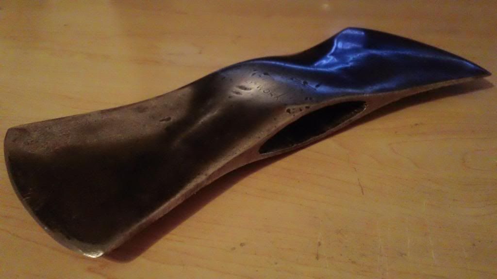

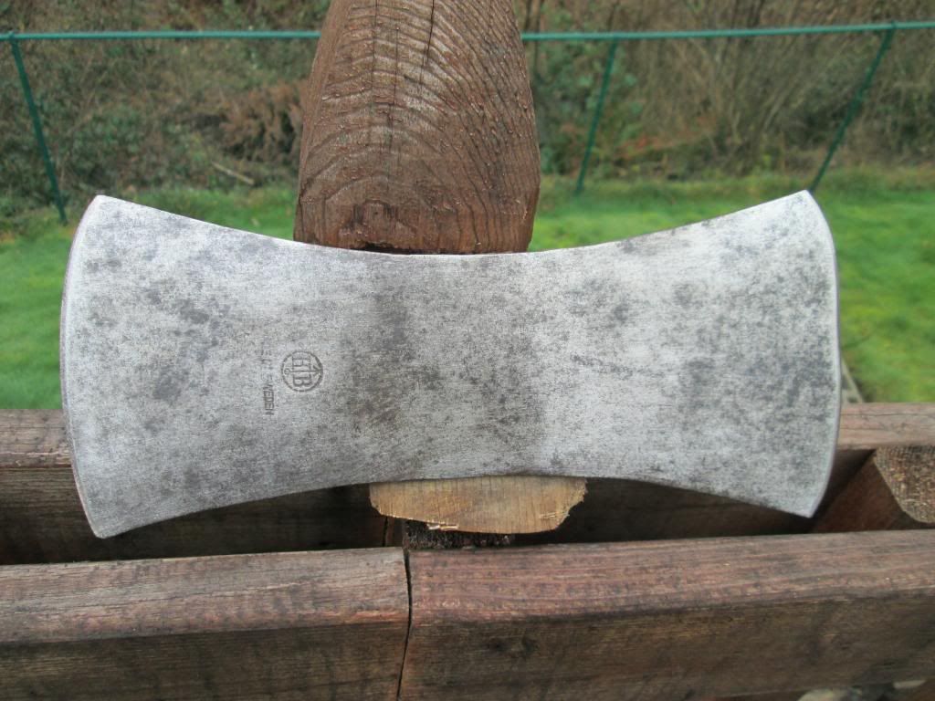

I got this axe head off of ebay and I'm putting it on a handle...
When I tried fitting the head on the handle, I thought that the way i put it on looked like it was upside-down...

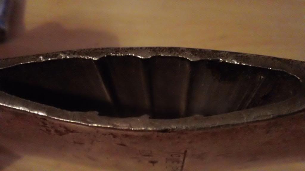

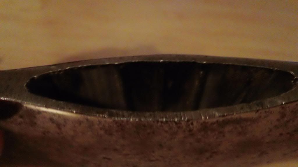

There are ribs in the eye that seem to protrude out a little more on one side, then they tapper down to the other...
Can someone help me figure out what side is right side up?
Although they do look pretty similar, I believe you have that upside down. The T in TRUE should be on the bottom

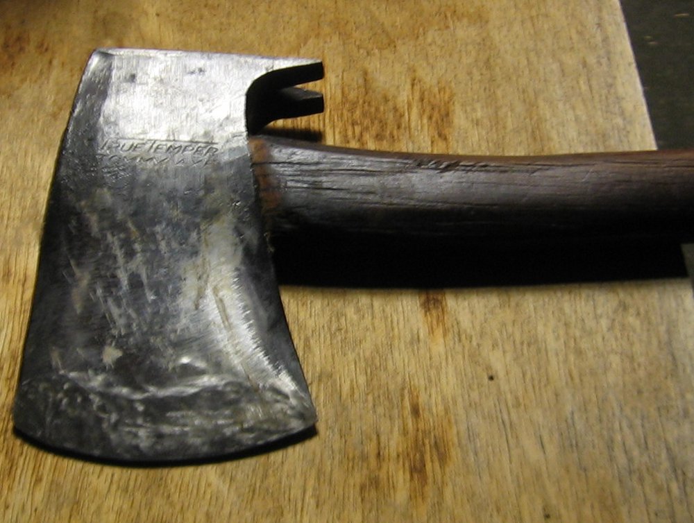

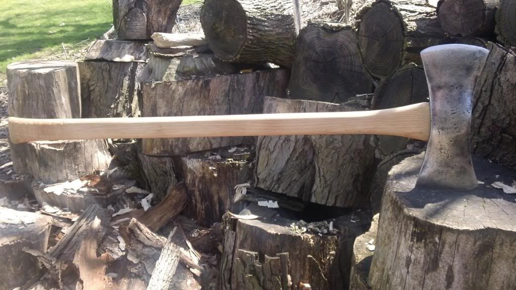

I agree, but from pictures and videos that I have seen, the lettering orientation has always been they way it looks in the third picture. Could the lettering be backwards?
Nope - that's the right way I think. The bigger rib protrusions should be at the top. You can measure the eye if you want. The top opening will be ever so slightly larger.
I actually had this same issue with an HB double bit I restored about a week or so ago. After I seated it (but before driving the wedge), I thought I had it on upsidedown since the "wings" stuck out more at the top. But then I looked at the pictures of it from **unnamed bidding site** with the sawn off original handle still intact and noted that I had seated it the same way. I'm pretty certain that the sawn off handle was factory original since it had an epoxied eye and I know from experience that's how HB used to do things. Also, I measured the eye and saw that what I thought to be the top opening was in fact a wee bit bigger.
Yes, I only have a few with in reach at the moment and the lettering is as you say. More than likely that eye is tapered also.

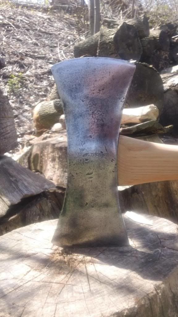

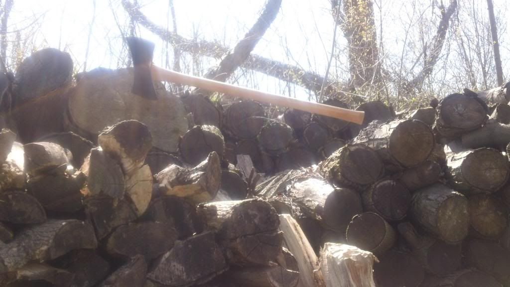

I hung it like it is in the third picture. The more protruding ribs are on top and the eye is slightly larger on top. I hope its right, but if not, whats the worst that can happen :rolleyes:

Kelly True Tempers.....T is at the top. The Perfect has an original handle. It was factory hung.
Kelly Perfect and two 4 Lb. Kelly double bits.

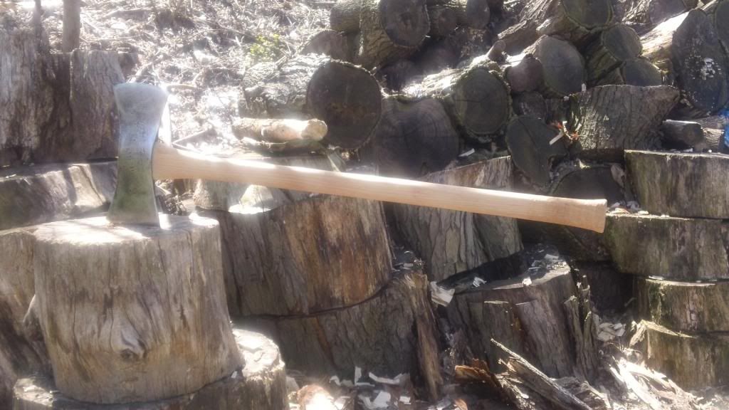

It DOES do well on fire wood. It was our only axe on 2 Bob Marshall horse-packing trips and performed very well.
Great job, that looks great. Looks like a reversible swamper to me. Unless there is a significant difference in the size of the eye from one side to the other, I hang swampers whichever way looks best regardless of stamp.

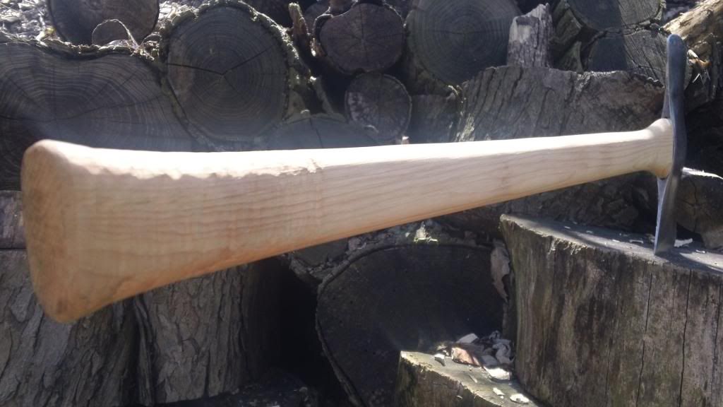

I like your grip ribs you added to the handle. I'll have to try that.
Thanks, I just roughed up the end with a flat blastard, then took a round one to make the defined/deeper lines. It feels pretty good when using it so far. There was only a minor difference between the two ends of the eye on the head. The opening with the thicker ribs was generally a little larger.
With that in mind and looking at the lettering orientation, I think I have it correct.
