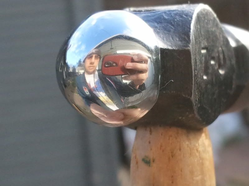

Peening rods is much easier with smaller pins, but in th simplest terms its just hammering the ends to smash them out latteraly. For 1/4" brass rod I would use a 20oz ball pein hammer (use the ball side) and not worry so much about turning the edge over, like a mushroom, but just enough to flair the shank to fill the hole. Take the hammer an put your thumb on the anvil, hit your thumbnail around the cuticle, if it hurts your hitting to hard. That's all the force you need, maybe just a tiny bit more. Just tap the rod 10,000 times in circular patterns.
Polish the ball on the hammer to a very high polish and it will leave polished marks on the pin. Here is my 7oz ball pein I use on 1/8" pins...

10,000 times is an exagerration, but only to make my point. Lots of light strikes are needed. Hitting too (very) hard can cause a secondary bulge further down the pin and possibly crack your scales. 1/4" pin is big pin stock and requires more force when striking, but not as much as you may think. Stainless is fine. I think one diameter sticking up is too much generally, I use about half a pin diameter.
