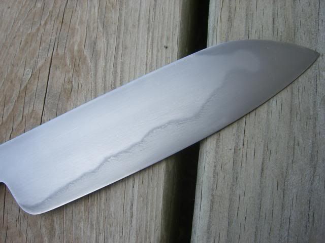

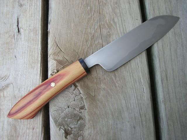

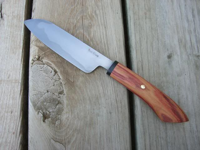

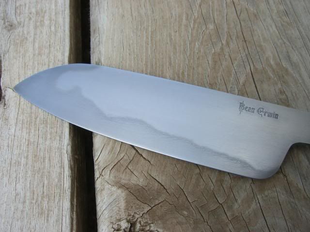

Blade - Tremblay W-2 with hamon
Spacer - Water buffalo horn
Handle - tulipd wood with mosaic pin from Jantz
Japanese style santoku
Got this done the other day so figured I'd post it, all that's left is to sharpen it up. It may end up being a gift for a friend.
Quite pleased with how it turned out, so feedback is welcome.
Going to try to get the hamon a big higher on the back end of the blade next time.
Blade was taken to 600 grit etched and then polished with red iron oxide in mineral oil, repeated a few times.
Any questions feel free to ask...
Comments and critiques are welcome.
