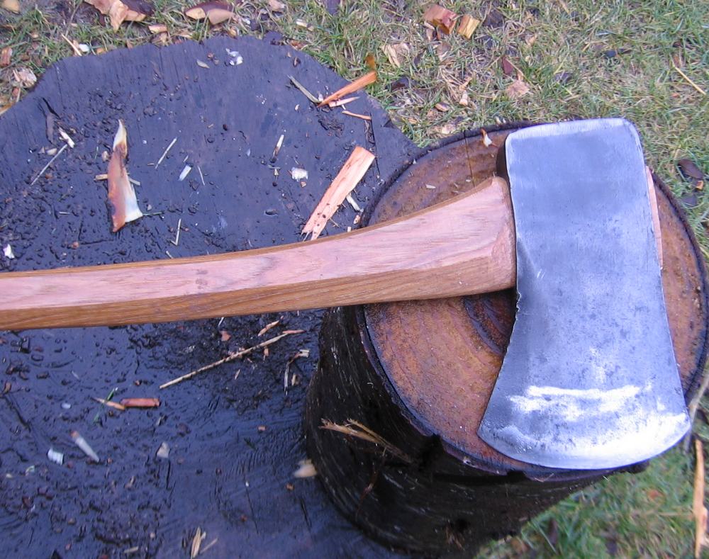

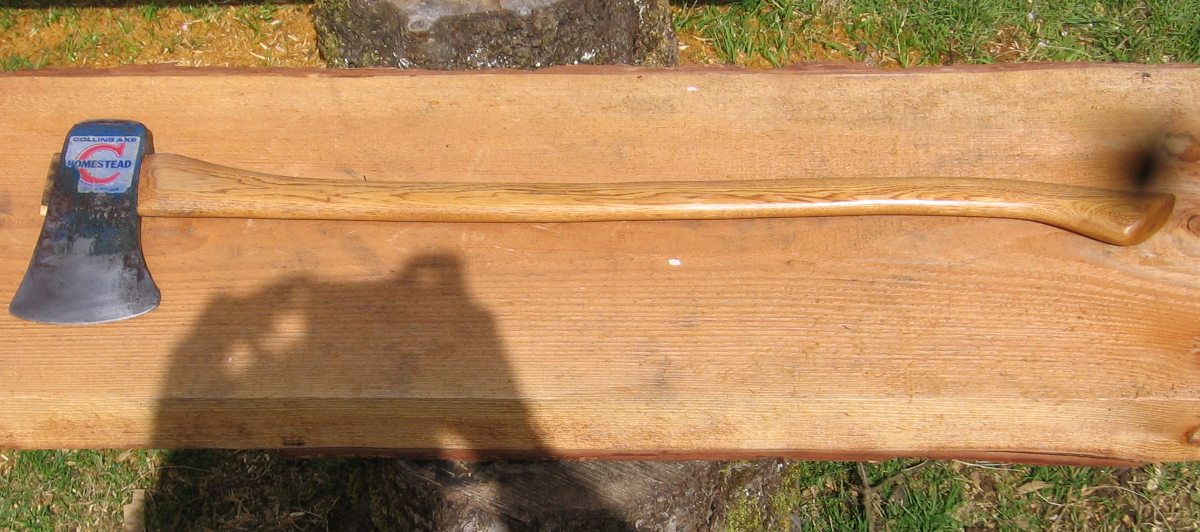

Indeed, I do that. I start with a couple coats of BLO because it soaks in better. I think it nourishes and protects the wood better than tung oil. With new hafts I'll often cut it with a little bit of mineral spirits to get it to soak in better. After 2-4 coats of BLO I switch to tung oil. I'm using some old Formby's Tung Oil Finish. Picked up 3 bottles at a yard sale for 25¢ apiece. It's old stuff - no UPC symbol on the cans. It's thickened a little but it still wipes on fine. I'd bet it's at least 30 years old to have no UPC. I use 2-4 coats of tung.
Tung oil forms a waterproof finish on the surface of the haft. But it doesn't look like it has varnish or polyurethane on it. It's a more natural look. And it leaves a noticeably gripper finish than BLO leaves.
Here's what it looks like.
