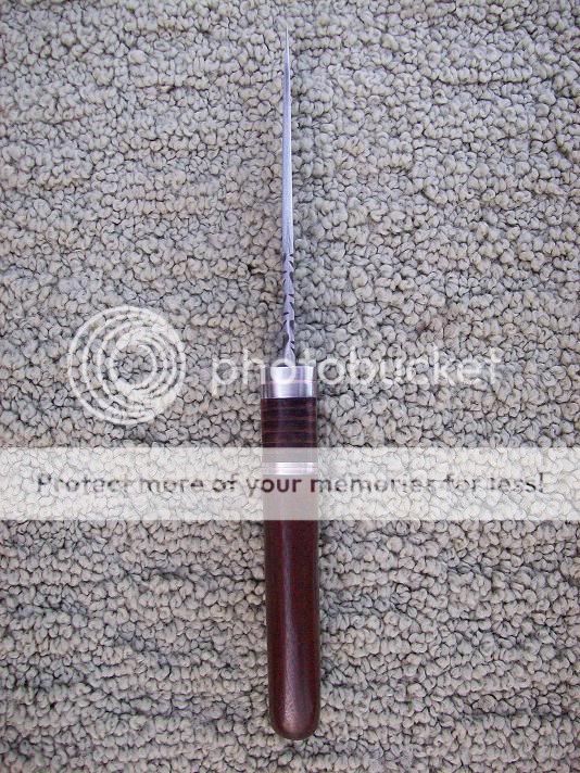

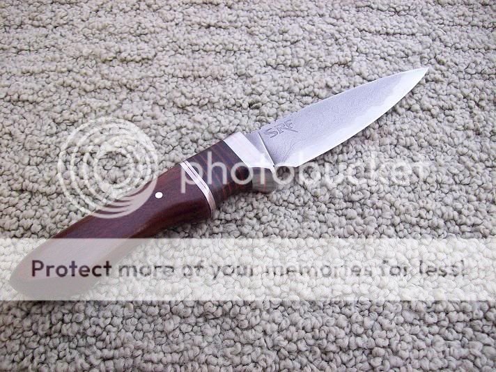

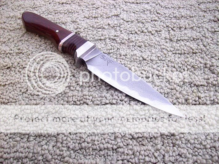

S S R Floyd Joined Feb 28, 2010 Messages 84 Apr 3, 2010 #1 There are alot of Bird and Trout knives out there, I wanted this one to be bird specific. 10" OAL 5 1/8" BL Forged W2 Etced and 1000g hand rubbed finish 1018 and copper gaurd and spacer brass pin Leather and Ironwood handle Thanks for lookin S R Floyd

S Steve Nuckels Joined Aug 18, 2009 Messages 1,915 Apr 3, 2010 #2 Scott, great looking knife! Now, go kill a big Gobbler! Did you epoxy or solder the guard ? BTW Mr. Moran's shop is open 10 April maybe I'll see you there! Steve --------- Potomac Forge --------- IN GOD WE TRUST

S S R Floyd Joined Feb 28, 2010 Messages 84 Apr 15, 2010 #5 Steve Nuckels said: Scott, great looking knife! Now, go kill a big Gobbler! Did you epoxy or solder the guard ? BTW Mr. Moran's shop is open 10 April maybe I'll see you there! Steve --------- Potomac Forge --------- IN GOD WE TRUST Click to expand... Sorry it took so long to respond just recovering from a computer crash! I have a group of birds eyed up for next week, been scouting them since February. The gaurd is soldered on and the gard and spacer sandwiches are soldered together. Thanks guys Scott
