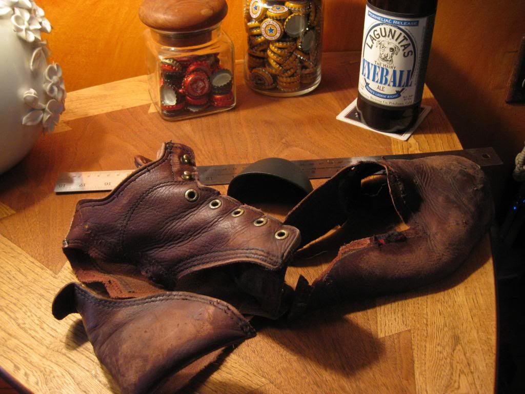

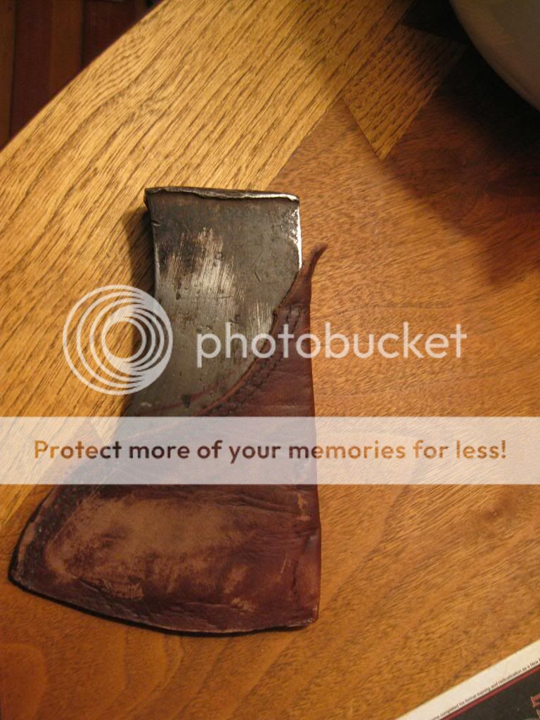

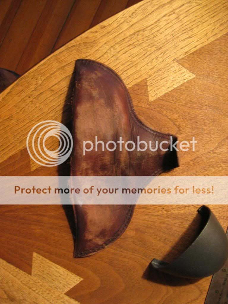

My redwings were totally shot, I bought a new pair but couldn't bring myself to throw away the old ones even though the sole was worn through. I've been wanting to try wet forming a leather hatchet sheath but didn't have any leather. So I grabbed a beer and a knife and went to work.
The heel/ankle piece looked about perfect

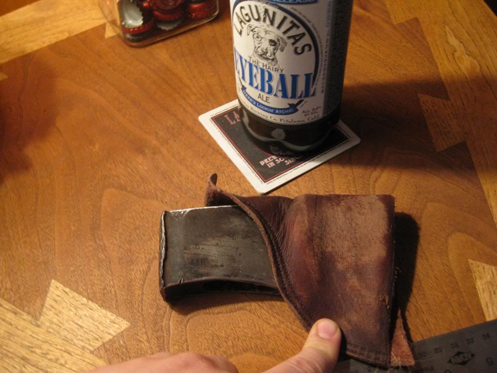

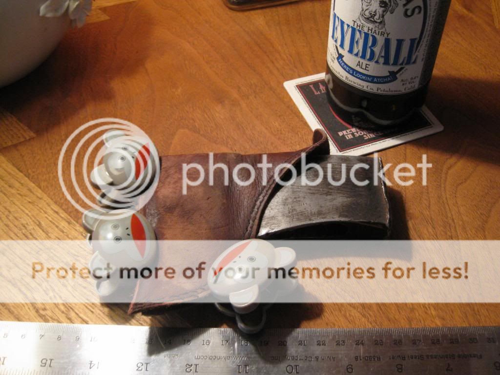

The first round of wet forming. I don't have clamps, so I used these super hardcore chip bag clips… I know what you're thinking "Badass".

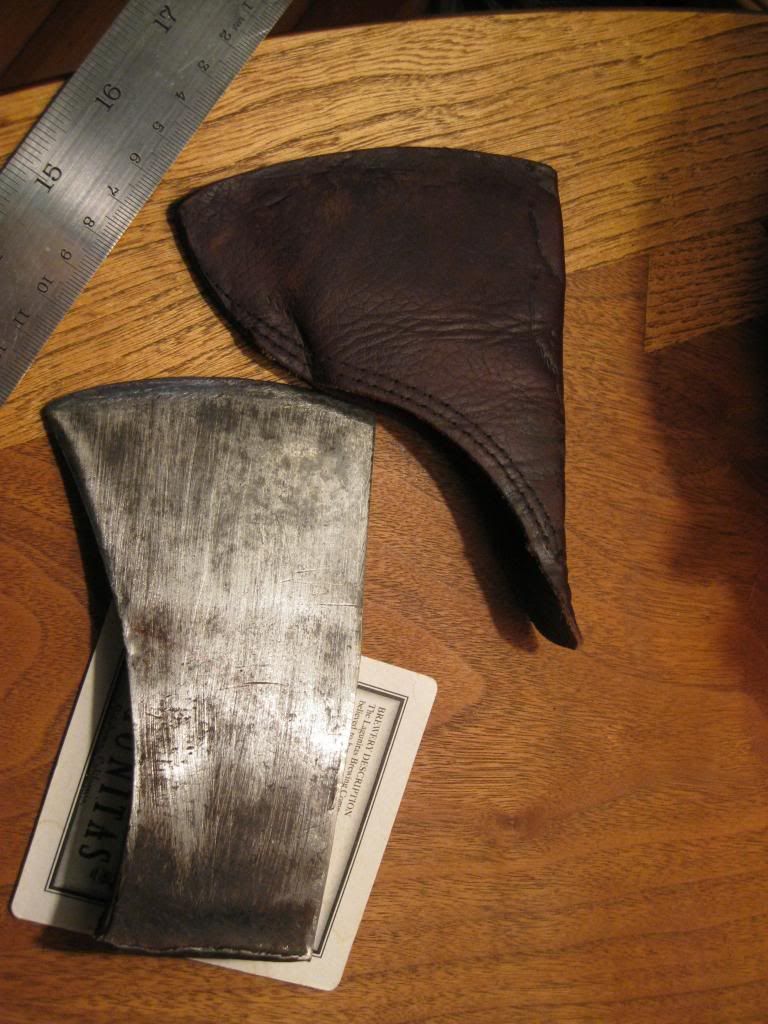

After 3 rounds of wet forming, I glued the front and trimmed the excess leather.

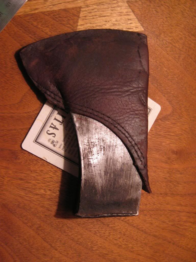

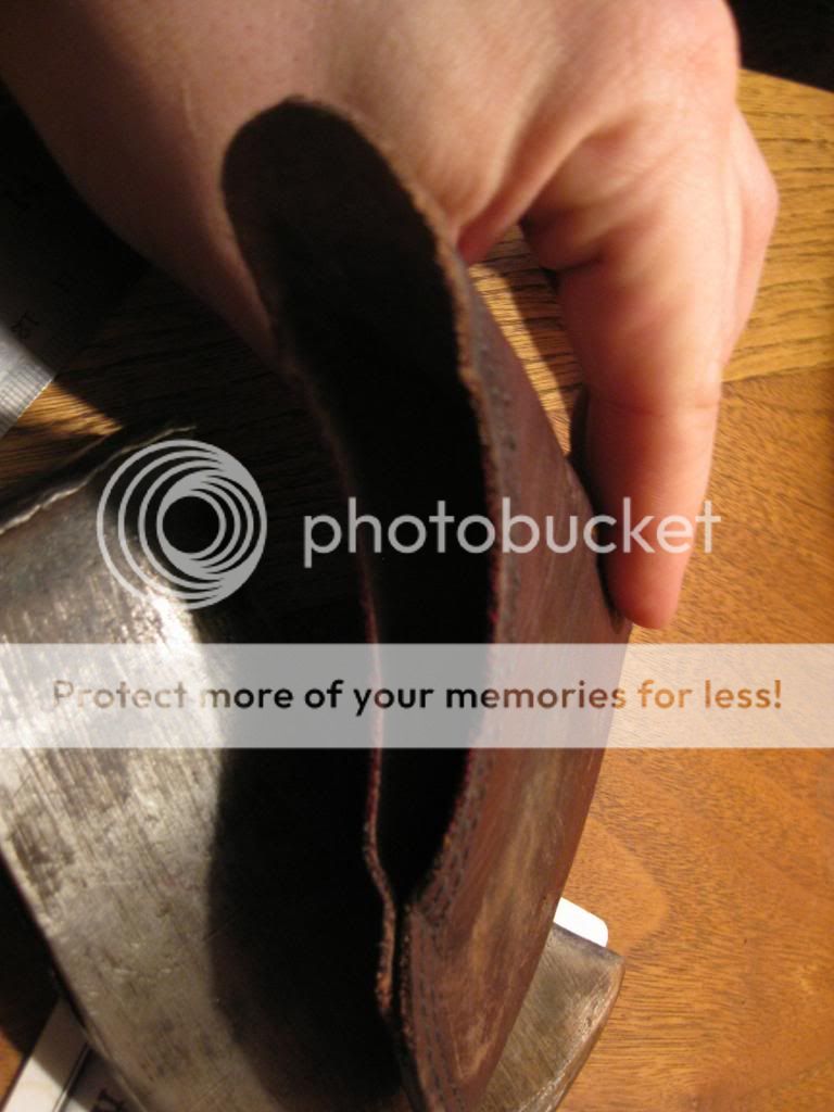

Put some boot oil on it and it's finished, it has a good friction fit but I'll probably end up adding a retention strap. Unfortunately those clips left "bite" marks in the leather that i couldn't massage out.

I love it. (especially the monkey clips) Now you and your axe can both go out well heeled.
Thanks for the comments guys. I'm pretty sure its an unmarked true temper tomahawk head, it's a 1.5lb.er, has a big poll and ridges in the eye. I just fitted it today to a 19" octagonal house axe haft, I'm hoping it will be a good in-between. Bigger than a hatchet and smaller than a boys axe, similar to Gransfors bruks small forest axe but for much much less money.
