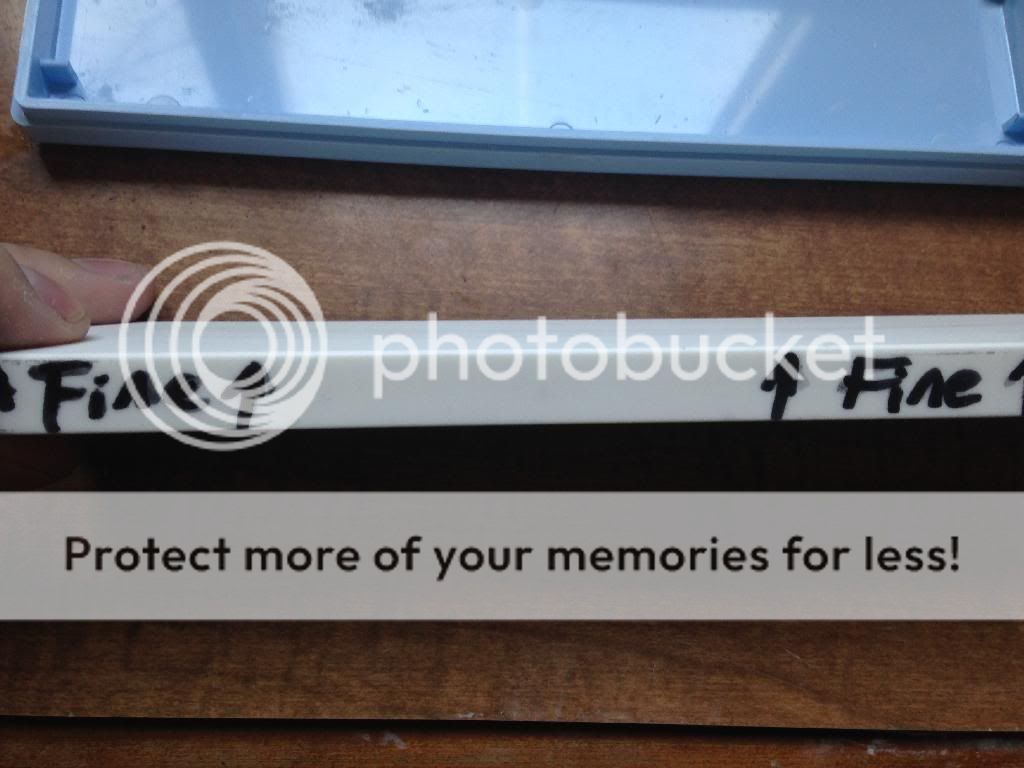

Last week I read a post and then started doing research on how some people were lapping their ceramis stones [SM rods] to effectively make them higher grit. The material is the exact same between fine and ultra fine (confirmed by Sal) the only difference is the surface finish. Being cheap it got me thinking, do I really need to buy another $50 stone? Can't I just make my one fine ceramic stone into a combo-stone?
Well yes, I could!
I had planned on this taking all weekend working a few hours a day but I found it actually wasn't as hard on my hands as I had thought and I was able to accomplish the task in just two days. I started out buying a set of lapping plates from harbor freight and flattening them with careful attention to detail, a punch and rubber mallet on a piece of wood (these arnt as wavy as some of those 4-sided Harbor Freight diamond sharpeners but still needed work). The plates were 180, 220 & 360 grit. I also used my fine (600) and EF (1200) DMT plates.

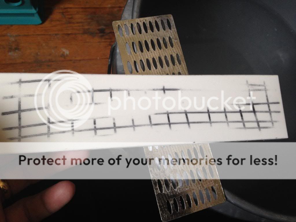

First I started off by flattening both sides of the stone with the 180 plate, draw a grid so you can tell when its flat.
I got setup with a perfectly flat block of wood as my base, a 5-gal bucket of soapy water and a comfy position to sit down over the work.
Do both sides like this till your satisfied they're flat. You'll want to dunk both the stone and the plate in the bucket pretty often and don't use much pressure.
That's that, stone is flattened, note this part took me a day by its self.

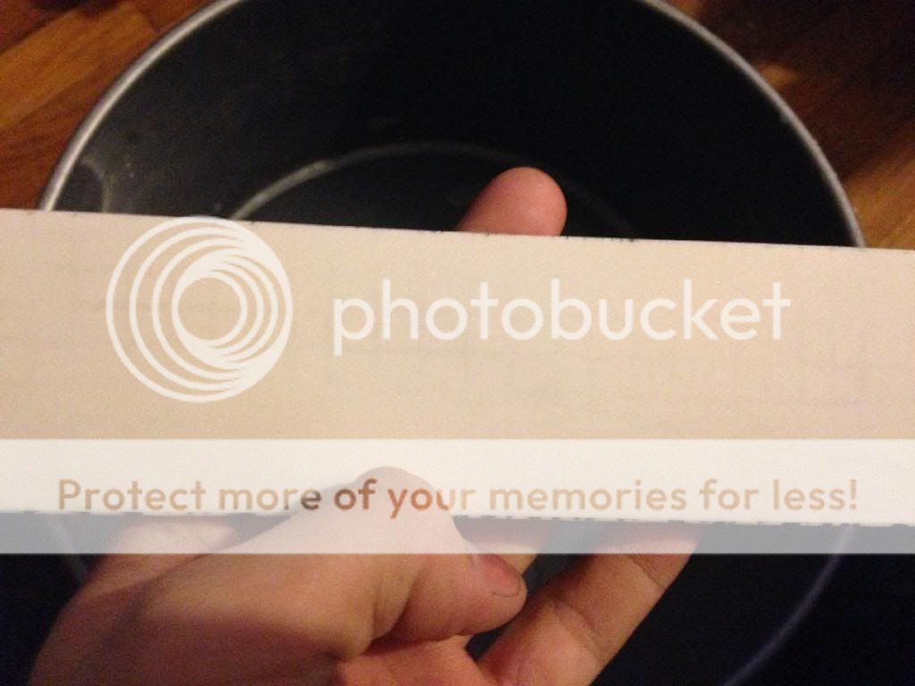

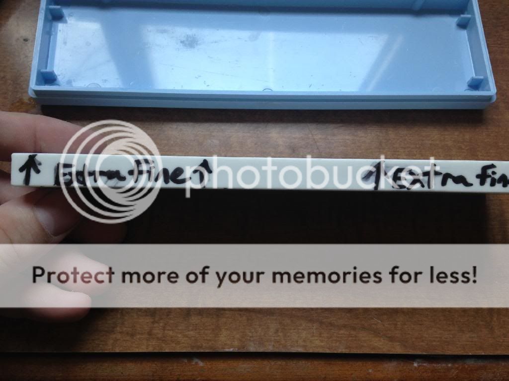

Next up pick a side to be the extra fine side and mark it, once your done its simple to tell but you don't want to mix it up while your working. Now that it's finished I can easily tell the difference just by feel, even my wife can tell which one is which in a blind test.

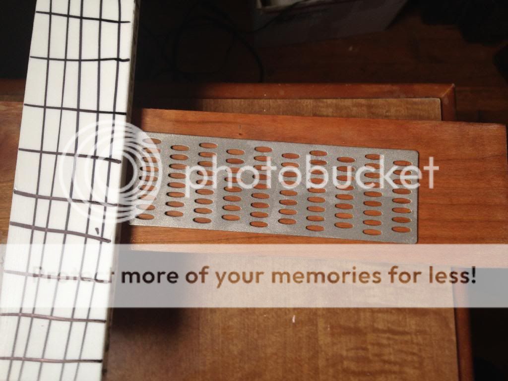

Now we start in again, draw a grid to make sure your staying flat and to monitor progress, I spent about 90 minutes with each of the 220, 360 & 600 plates (redraw grid when needed).
After that I moved on to the EF (1200) DMT, this final one took about 2.5 hours of work to get to a point I was happy with it. Same process.
The final outcome is amazing, these are not very good pic's but hopefully they will show enough.

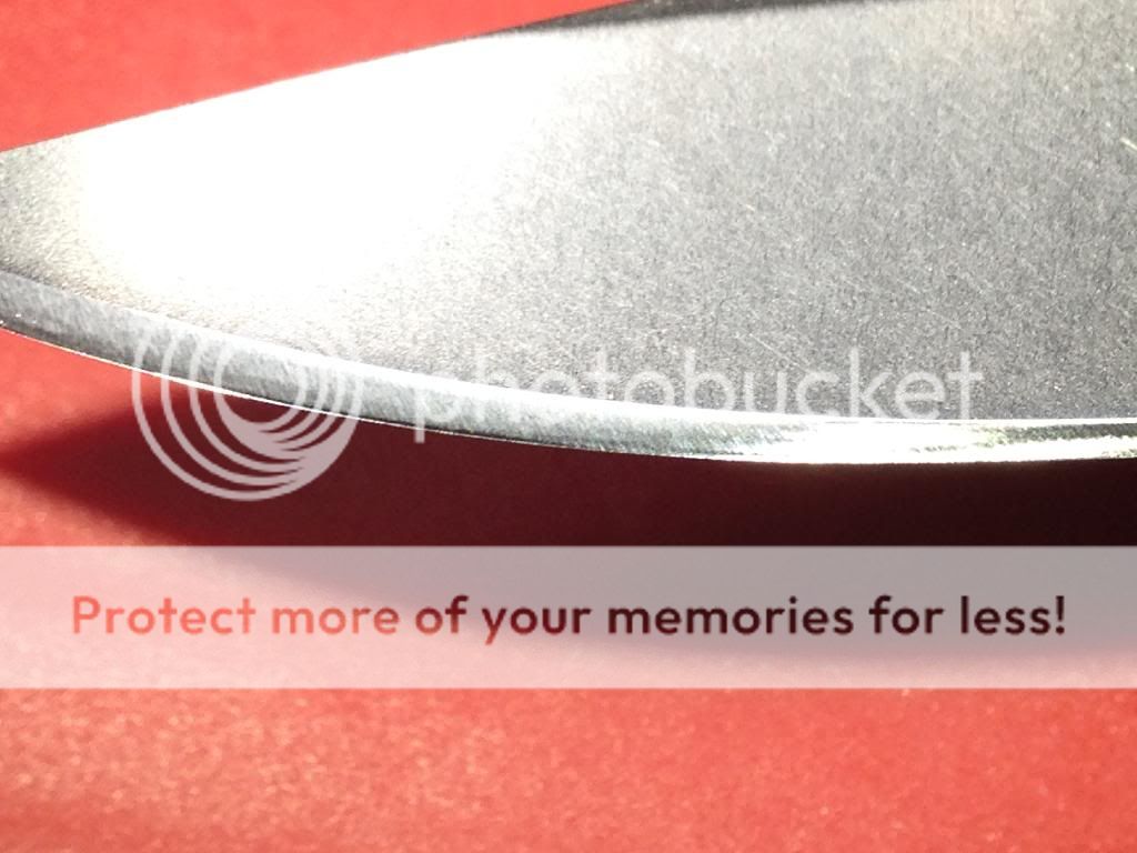

This is my Sebenza off the "fine" side (at >2500 this is already very refined and very sharp, I was able to get the light just right to really show the scratch pattern) notice the burr.

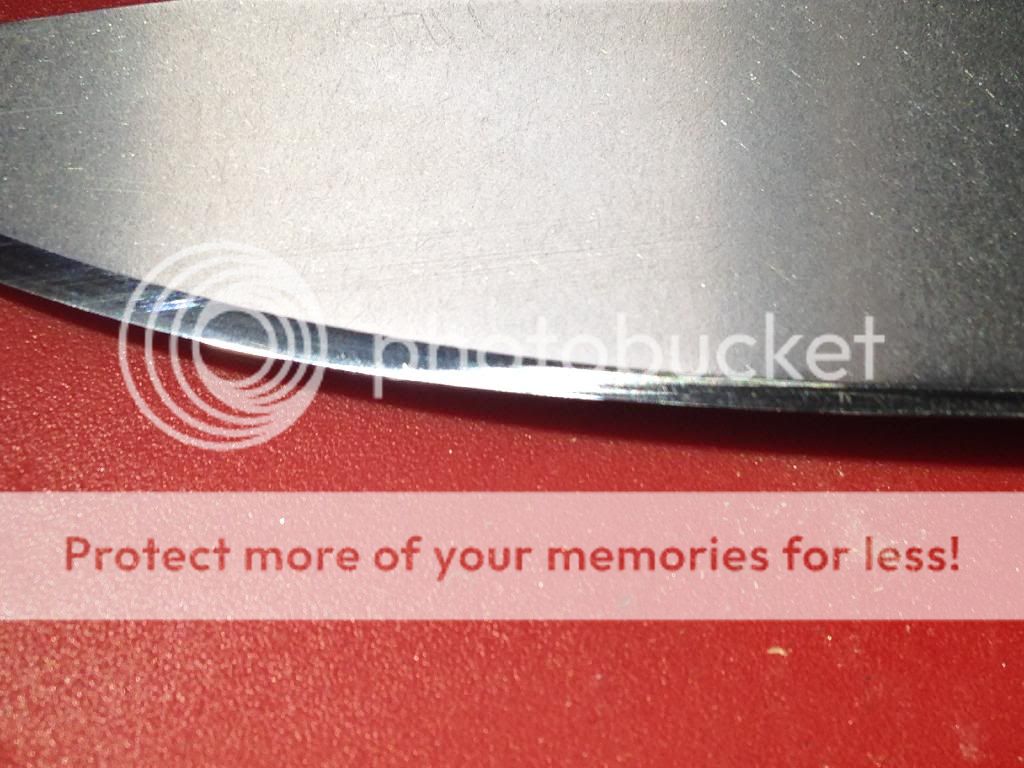

And the after the "ultra fine" side (here there is almost no visible scratch pattern to the eye, only under HCRI light held at a low angle was I able to even get this pic)

I'm not able to give a good estimate, I'd put it somewhere around 10k but I'm not sure. I plan to do some experimenting here soon to try and figure out a smaller guess. Also the "fine" side went up in grit after lapping, I'd say its pretty close to 3-4k.

The material is exactly the same, the abrasive size and the distribution in the matrix is the same, this has all been confirmed by Sal. The only difference between the two unaltered stones is the surface finish put on them by the factory. Did I not accomplish the same thing the factory does effectively changing the grit size?
The ceramic particles are so hard I didn't abrade them away, the diamonds sharpened each individual particle making them smaller/finer.
