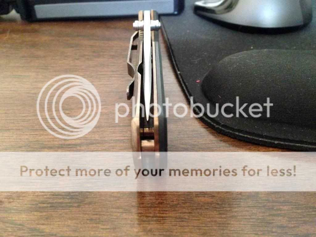

Knife in question: Navy K-507
Price paid per knife: 15 bucks, with shipping.
Things you can't see in the pictures: all moving parts polished, edge sharpened to the point that it can split standing hairs.

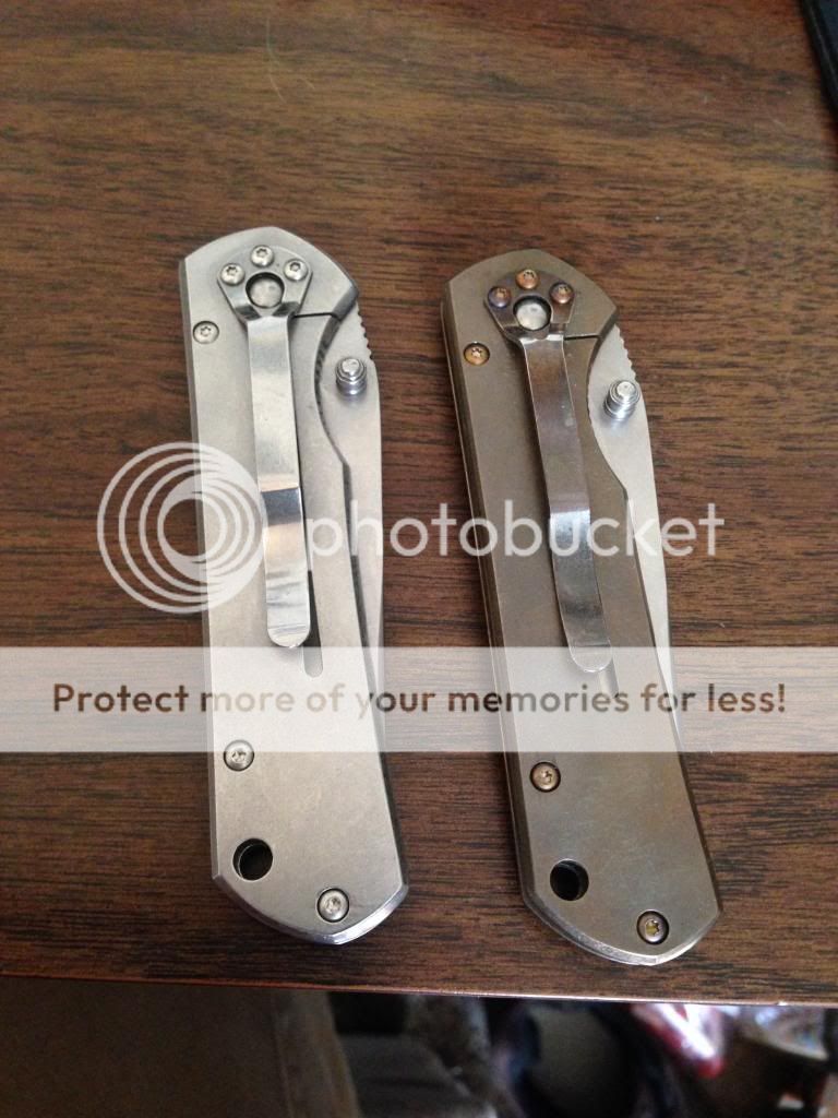

Original vs Finished product:

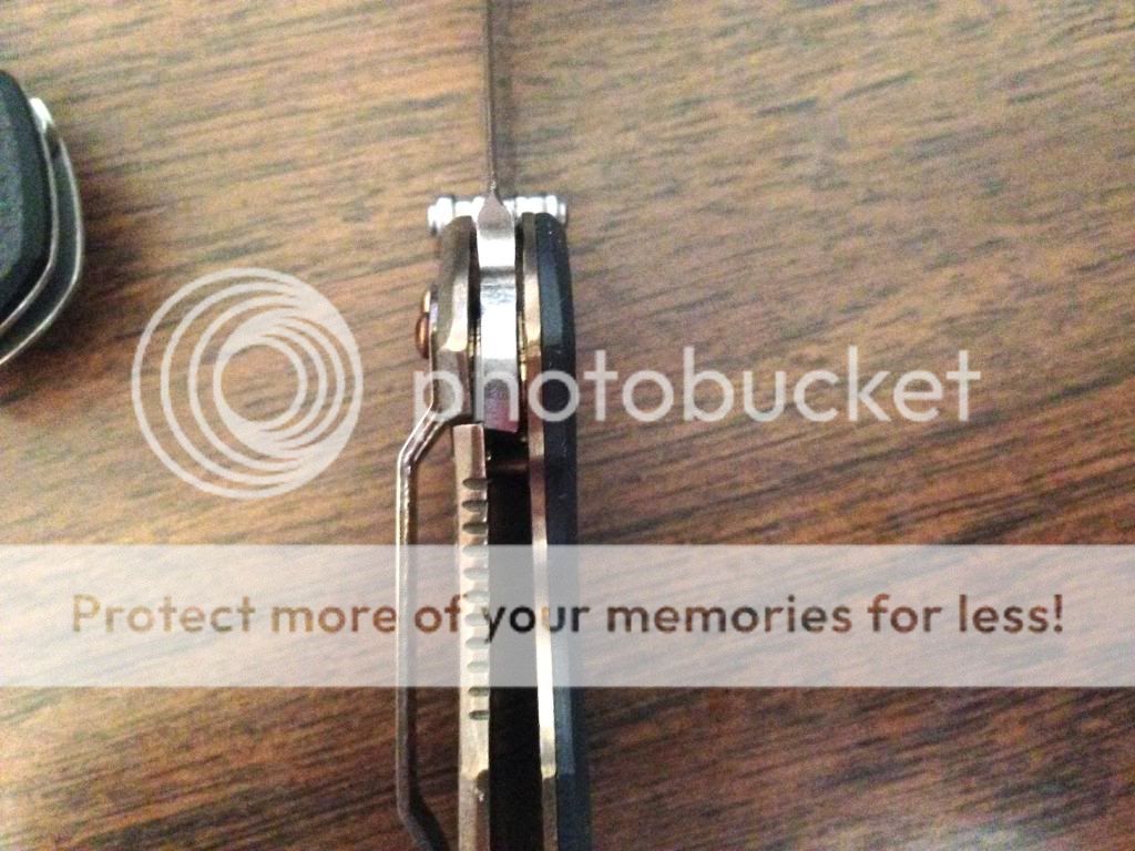

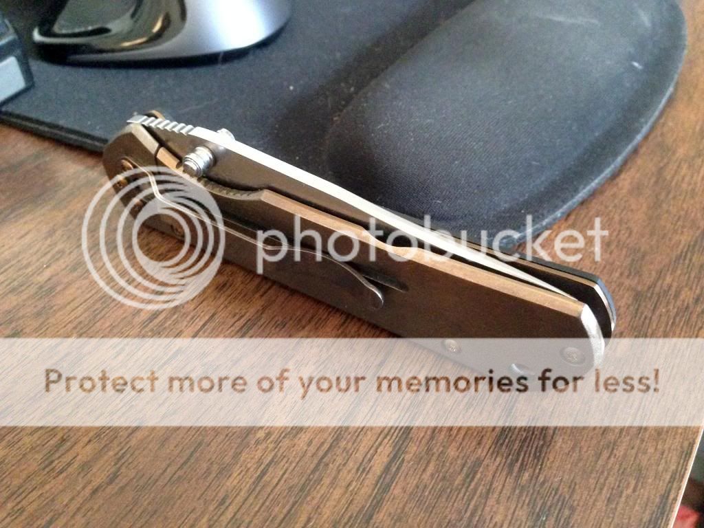

I tuned up the lockup so it is as absolutely early as possible while still being rock solid in all directions. Yes, the lock is actually engaged in this picture.

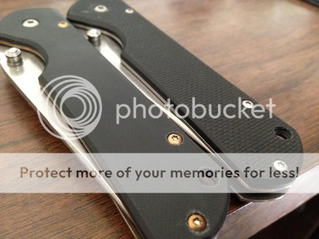

Polished up the G10, made some discreet bevels in the G10 for comfort.

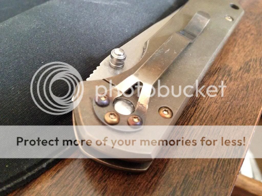

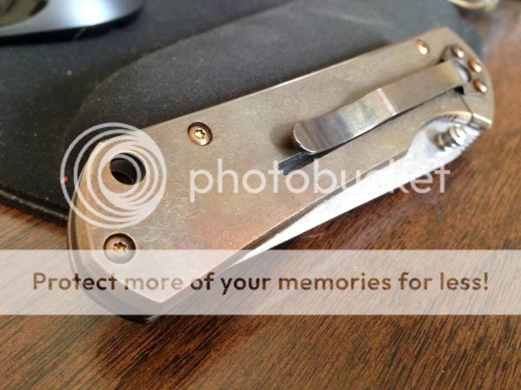

With the stonewash, there's a slight electric blue crackling effect in the right light.
Boredom and a blowtorch, my friends.
Nice work. Not sure that I'd like the lockup "quite" that early...
Can't do any harm when you pay that for the knife...
The angle of the picture, in hindsight, gives the wrong impression. The lock makes flat contact, but just with an absolutely insanely small amount of the tang. Rock solid, though. Can't force it to close no matter how much force I apply.

How did you tune the lock-up?
Navy has really spotty QC, so I bought two to make sure I got a good one. Sure enough, while one was fine, the other had a lock that didn't engage. That was this knife.
So, I very carefully wore down the lock bar with a fine ceramic stone until the lock juuuuuuust barely engaged.
