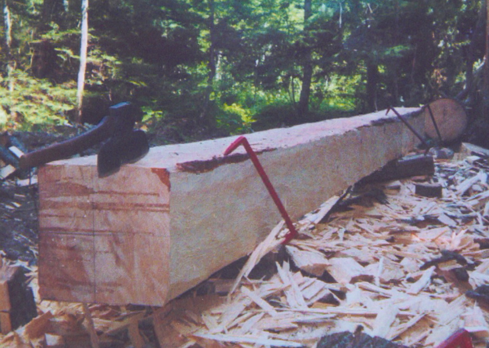

Just found a great blog by Mike Beaudry called "Mud Pond Hewing and Framing"
http://mudpondhewing.blogspot.com/
with lots of interesting reading, including a four-part tutorial on how to hew with a broad axe:
Part 1 http://mudpondhewing.blogspot.com/2012/05/font-face-font-family-times-new-romanp.html
Part 2 http://mudpondhewing.blogspot.com/2012/05/hewing-with-broad-axe-part-2-layout.html
Part 3 http://mudpondhewing.blogspot.com/2012/05/hewing-with-broad-axe-part-3-scoring.html
Part 4 http://mudpondhewing.blogspot.com/2012/05/hewing-with-broad-axe-part-4-hewing.html

well, I have to say that the mudpondhewing blog is the best hewing site I've ever seen. let's call it........inspiring.
-step-by-step. the scoring and juggling process takes off so much wood!
above after juggling, below after making the first pass hewing.
the "finished" side, after two passes hewing. of course, I'll have to go back over this one more time to make it smoother......
I quite obviously have a long ways to go before becoming anything approaching proficient, but I finally get the marking-scoring-juggling-and-THEN-hewing bit. I had tried this waaaaay back when (maybe a year and a half ago?) after buying a gransfors 1900 double-bevel. but, I was too stubborn to go seeking out instruction. hewing dry aspen without scoring and juggling turned out to be quite the disaster, and I haven't tried until today. I've got a pile of logs (the start of 2013-2014's firewood) drying out, so I pulled down a nice piece of beetle-killed (but still green/wet) spruce. worked much better doing it the right way.

Good job, Ben. It more work than it looks like in the videos, ain't it?
heck, I could drop that line into just about any thread in any message board in the whole of the interwebs.
it's ALWAYS more work than it looks in the video!
-ben
When I was hewing the 6x6 beam that is still laying in my yard, I used only double bevel axes. I scored really close to the chalk line because I wanted to split most of the waste off and not bother hewing a significant amount off to get to the line. I did screw up in a spot or two scoring too deep, especially working about a big spike knot.
