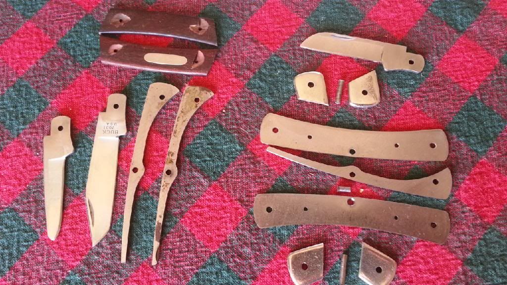

Here is a deconstructed 703, very similar construction to 300 series knives.

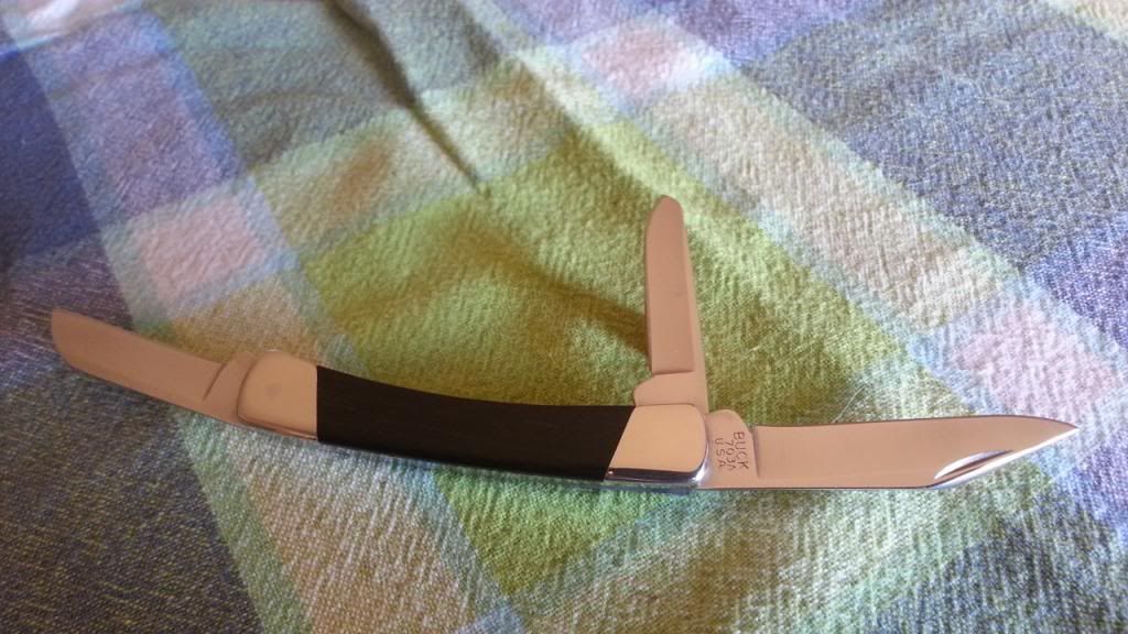

Here is the same knife after rescaling with ebony, and swapping out the well used spey blade for an almost mint spey blade.
Whoops, looked again, that previous photo was the donor knife.....

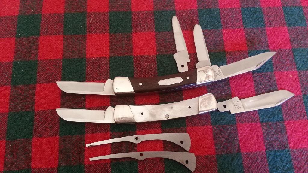

Here is the donor knife being turned into a single blade sheepsfoot, with the recipient knife before anything was done to it.
Anytime you do a blade swap, you have to put in a new pivot pin, and peen the pivot pin to secure it in place.

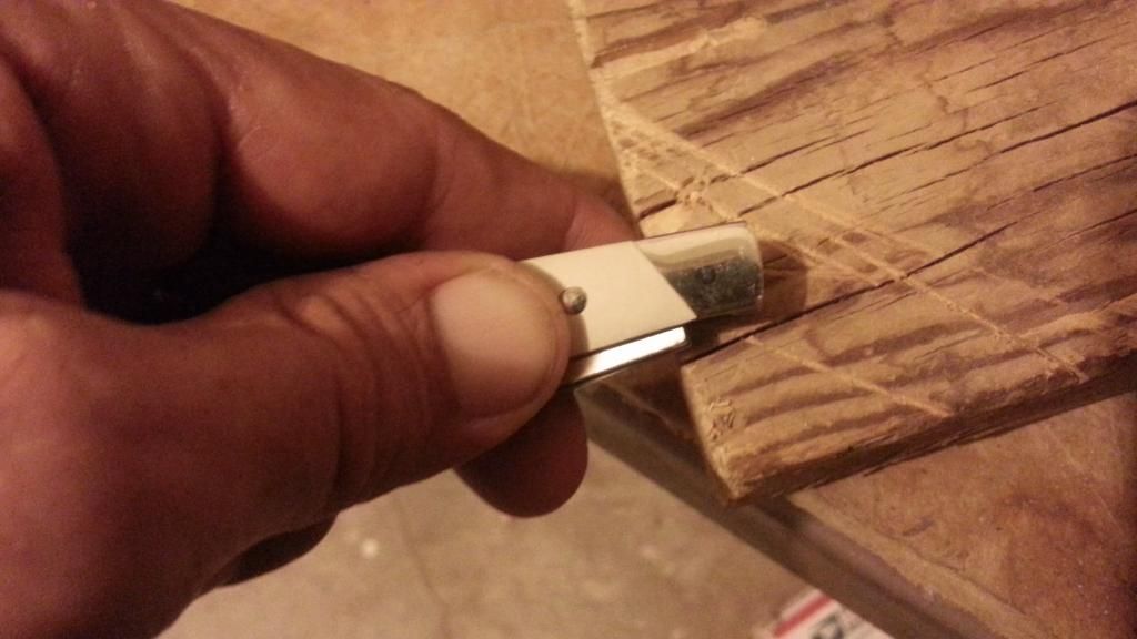

Here is my high tech 2x4 I use, notice the hole to the right, in the second photo...... when I use a pin punch to tap out a pivot pin, I do that over the hole.
Also notice the pivot pin, unless the bolsters are super polished, it should be easy to see.
