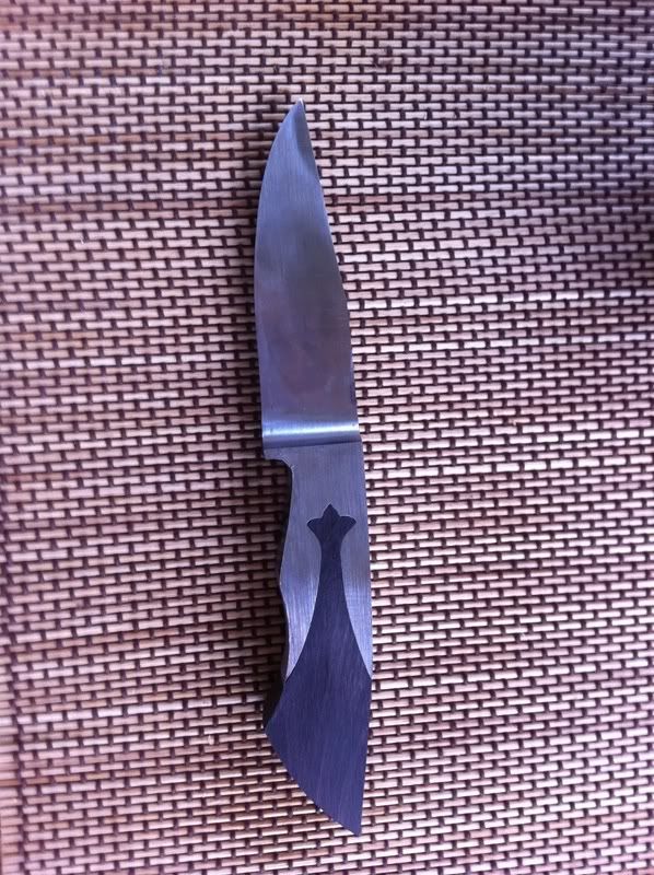

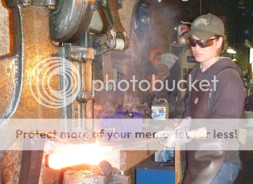

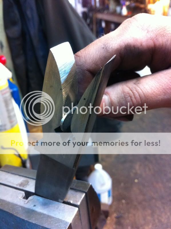

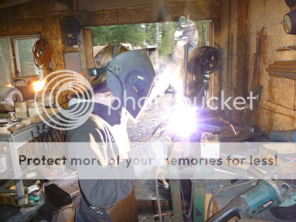

This was a treat to myself for finishing my JS test knives. I've had to stick to carbon while the boys had all the fun twisting damascus. This is my first twisted metal and try at the keyhole handle method. I've had this knife in my head for months...or one like it anyhow, this one pretty much had it's own way due to my inexperience but I hope to get feisty with the next one and make it behave a little better. I'm including a few work in progress pics Adam took for fun.
6 bar Merovingian Twist
1084/15N20
African Blackwood
3 7/8" Blade 8 1/4" OAL
Thanks for looking!
-Haley
This took alot of hand filing...something we learned all about in Brazil.

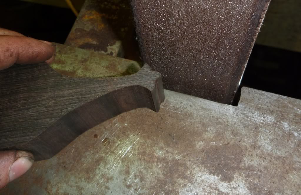

Shaping the African Blackwood as close as possible

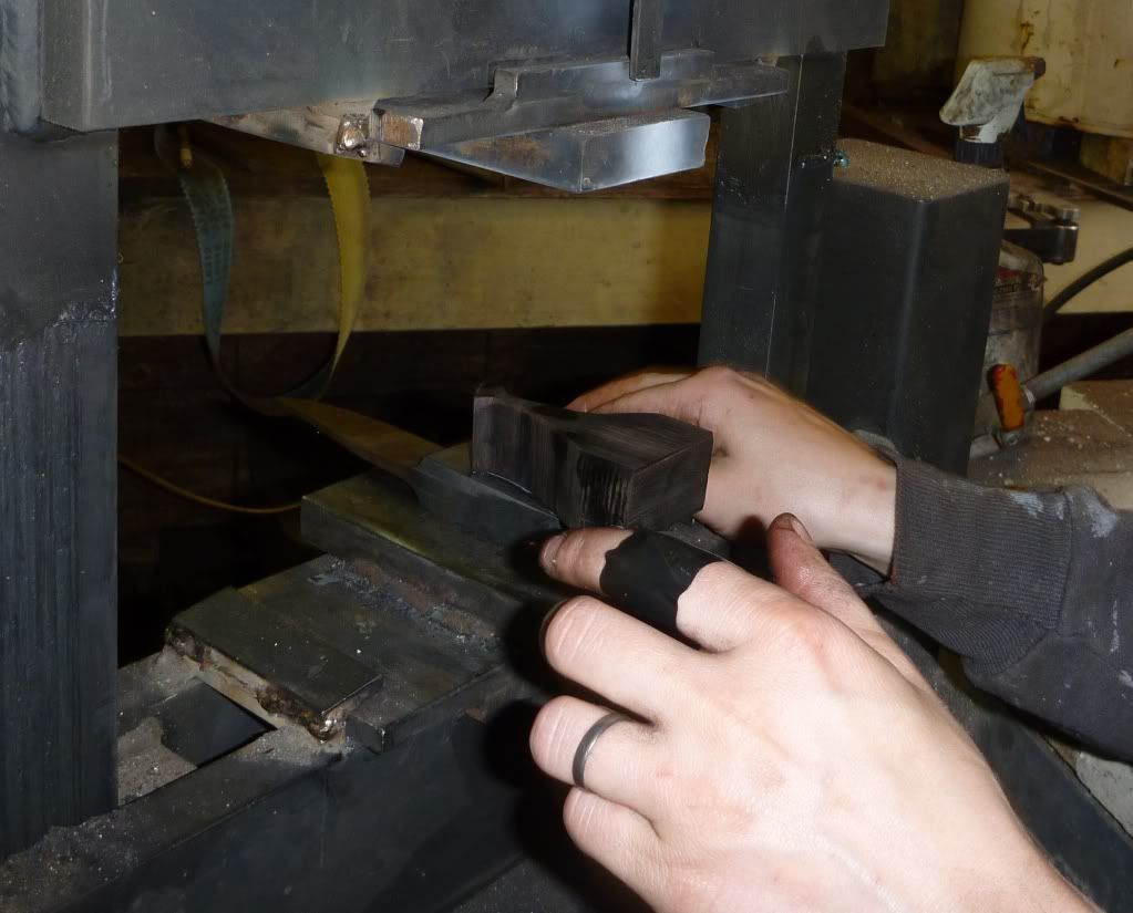

The moment of truth..

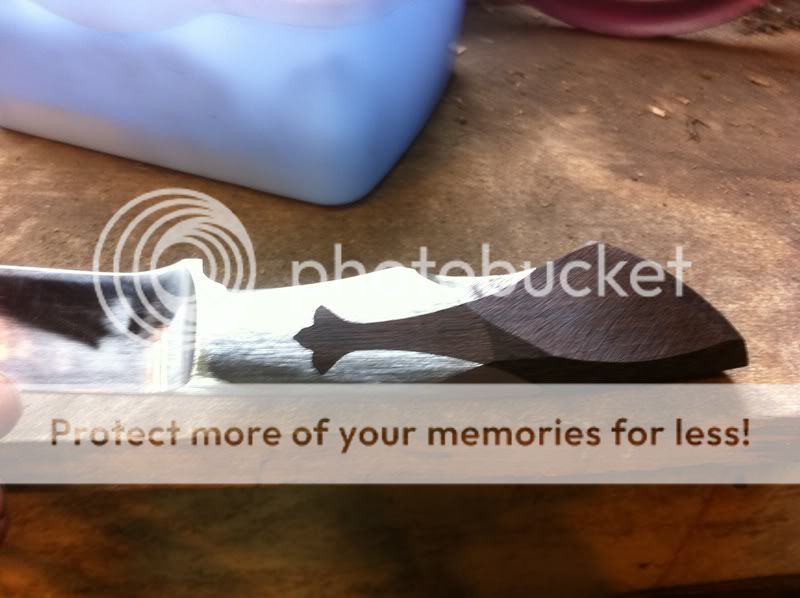

Third time's the charm!
The wood and metal handle gets a few contours

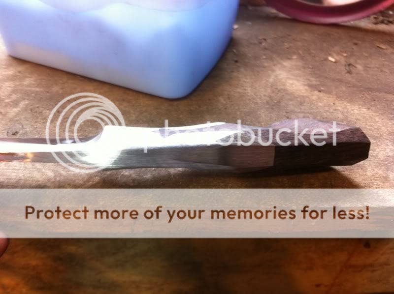

finally after fileworking, etching and parkerizing -
