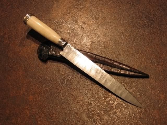

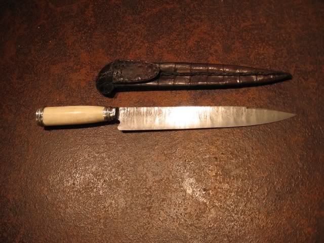

Hello,
I've just finished this two criollo style knives. Both have 10" blades, the first one blade material is a 120 layers damascus steel (1095+1018), random pattern.
The second one has a ladder pattern of 230-300 layers (1095+1018).
Handle material, first one, itin wood, with 925 silver butt cup and fitting. The second one has an axis deer handle also with 925 silver butt cup and fitting
Sheath, in both knives is cow leather wrapped in yacaré leather (our native aligator).
