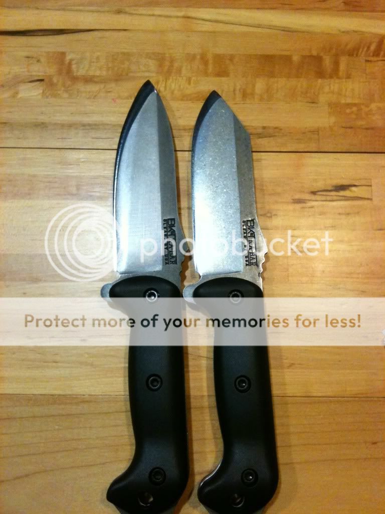

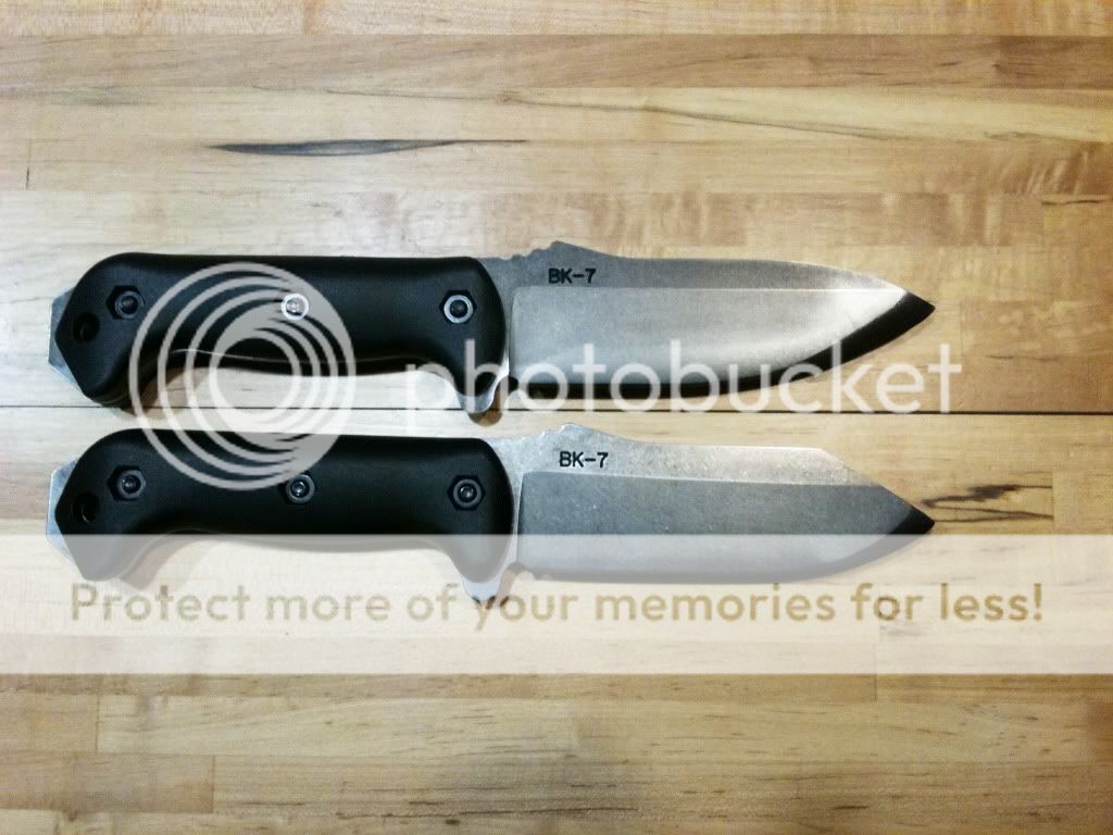

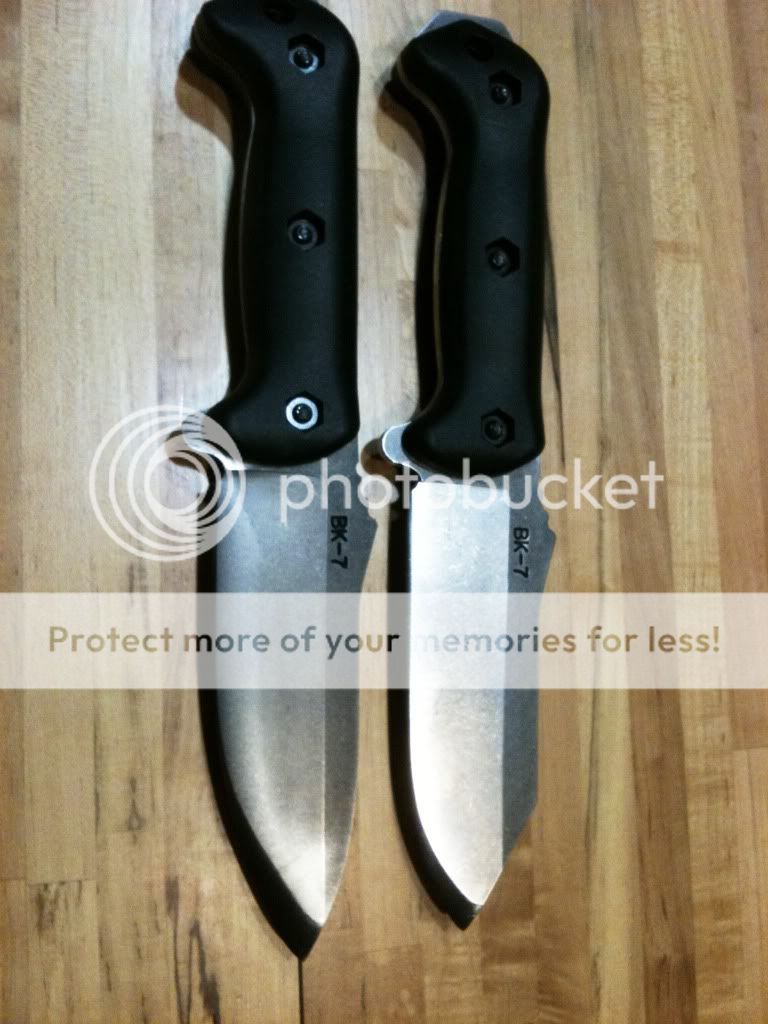

I just finished these two customs for a forum member today. I think that now I need to make another for myself in the BK10 style. Never really cared for it in pics. But now that a BK7 gave his life to start over as a Bk710 I really like the sturdy tip and light weight.

Yeah 1/16 thick air cutoff tool blade on my 4" makita grinder and going slow to not build up heat. Then 6x48 beltsander and 1x30 beltsander and finally sharpen and polish.
