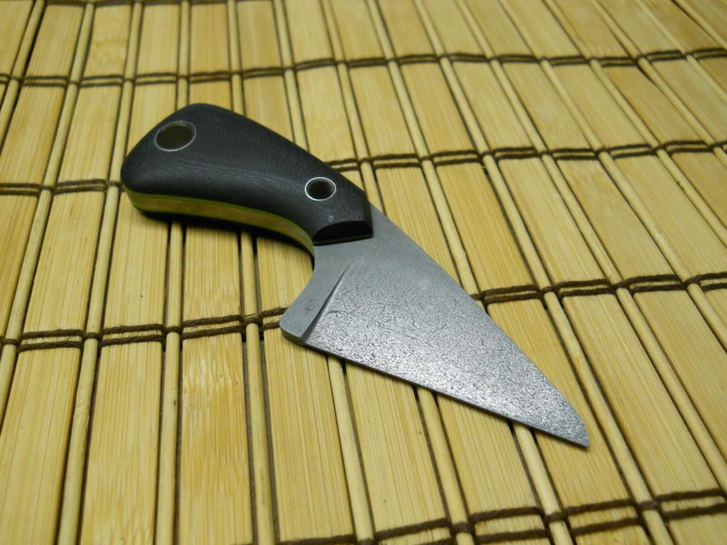

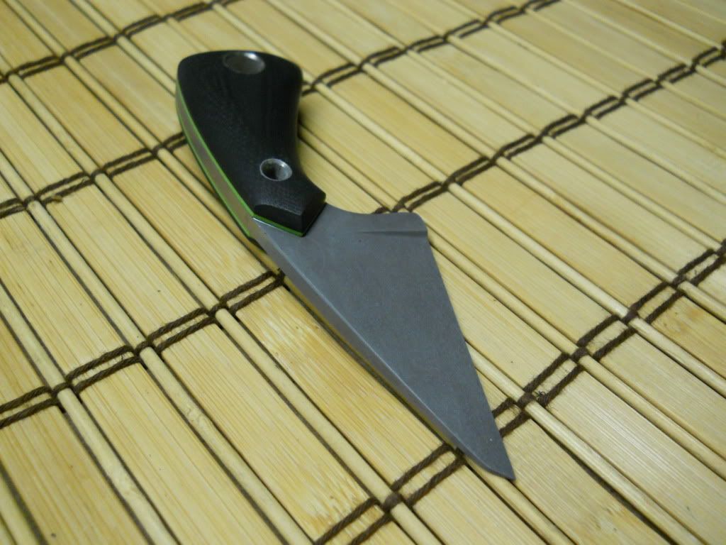

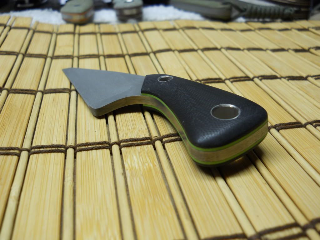

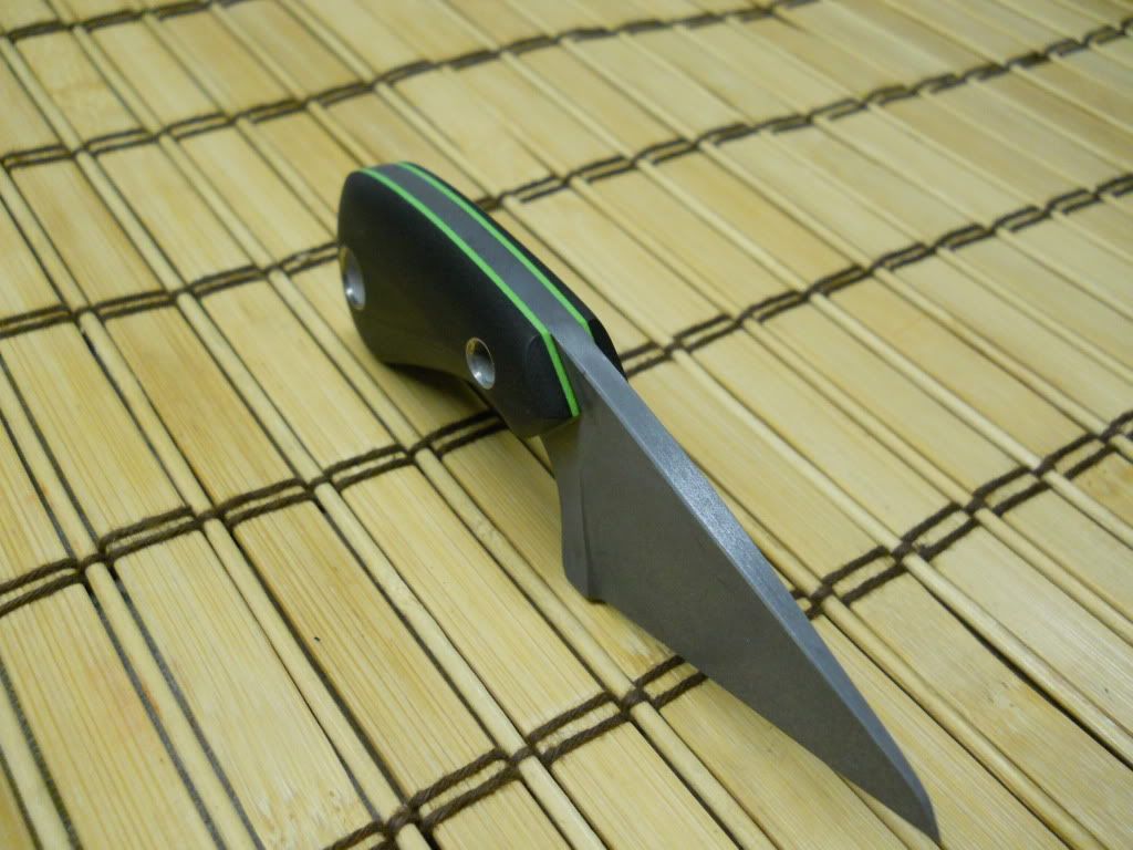

Here is one I just finished up Friday night. I carry the first one of these little buggers I ever made every day. It's a handy little knife I think. This one was ground from .176" D2 and then acid washed with muriatic acid. Handle is black g-10 with toxic green g-10 liners. These are just about 4.5" overall with a 2.0" cutting edge. This one hasn't been sharpened yet, I still need to finish the sheath.
Thanks for looking!

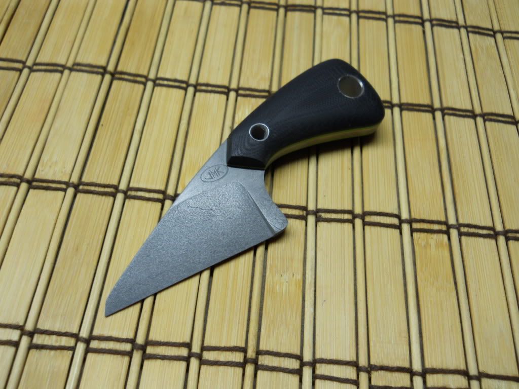

Here is a side by side with the first one ever back in October I think. It's ugly but I still carry it every day. As you can see it gets some good use.
Mmm, I like it. Reminds me of the little Pikal I used to have. I like the tubing as pins. Sweetie.
Looks great as expected! I think I like your first one even better...
