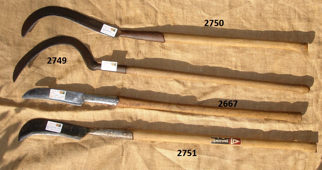

Looks like you've re-discovered a tool known to the English-speaking world as a "slasher". :) Should handle burdock without any trouble. The stuff isn't too difficult to cut until it's fully gone to seed and lignified. Once it's all brown and woody it likes to "shatter" and send irritating little hairs everywhere along with the burrs themselves. Those hairs itch like fiberglass. They're just awful.

A slasher is a form of light billhook on a pole. The closest North American equivalent is the "ditch bank blade", which is like a double edged machete blade bolted into the end of a double bit axe handle.

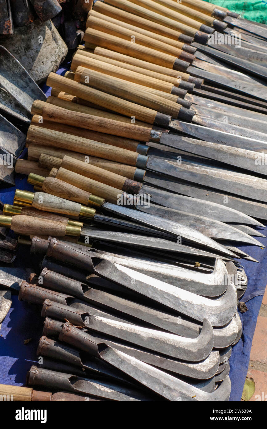

I like this northern Thailand hilltribe billhook style. I have one or two that are somewhat thicker and a bit shorter/heavier. This one has about a 12 inch blade, maybe 5mm thick up by the socket.

That Thailand bill hook looks like it cuts well. How does it handle with that handle? Any hand shock? Is the blade offset making it hard to cut with?

That Thailand bill hook looks like it cuts well. How does it handle with that handle? Any hand shock? Is the blade offset making it hard to cut with?...
The socket on those is generally pretty well centered with the blade, though the one in that picture looks to be a bit off. I don't think people grab them hard enough to get much shock. The blades tend to be thick and wooden handles are put on, at least on the curved ones and billhooks. Around the house, they often just use them without any handle.

Those look simple and easy to produce, yet nice and functional. Do you own any with the wooden handles? Have you handled one?
... Those look simple and easy to produce, yet nice and functional. Do you own any with the wooden handles? Have you handled one?
If you are referring to the traditional Thai/Lao/Burmese blades, they are not easy to produce. Especially the billhook type. Hand forged from small but thick pieces of truck springs which are hot cut using a chisel. A 6 inch x 1 inch x 3/8 inch piece may become a 12 inch long blade, plus tang. I helped forge two blades and it is a lot of work in that heat and humidity. Modern ones may be cut from plate, but not the ones I have.
I have some rat-tailed tang knives with foot-long handles. The socket knives I haven't handled yet. But I do have one or two 3 ft long pieces of tropical hardwood handles at the ready. I also have a hammer handle that is some sort of endangered rosewood species that I brought back many years ago.
