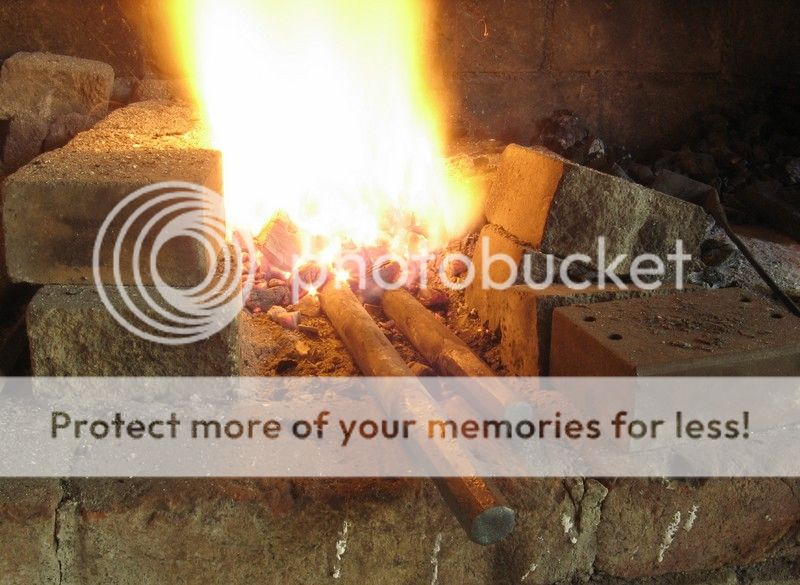

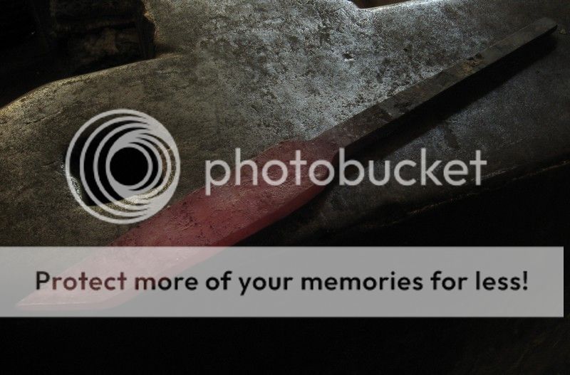

heating up round bars of W2 and forging it down to rectangle shape.

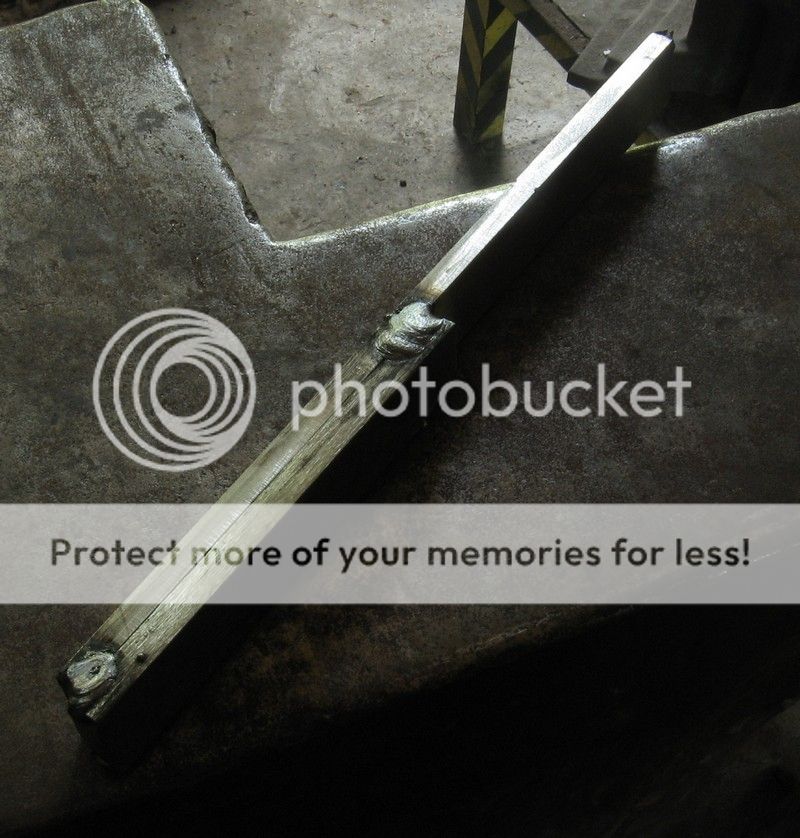

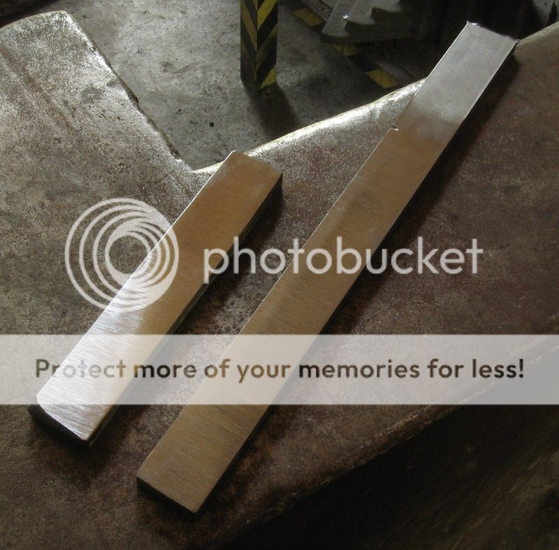

cleaning the surfaces with grinder and welding corners...again (left is steel and iron is on the right)

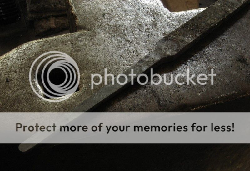

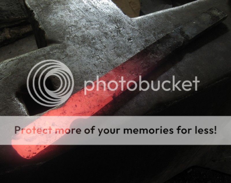

forge welding in two to three heats and starting on the tang by hand

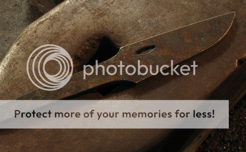

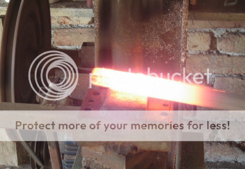

and finishing it on the power hammer
after 30 to 45 minutes, this is what I end up with

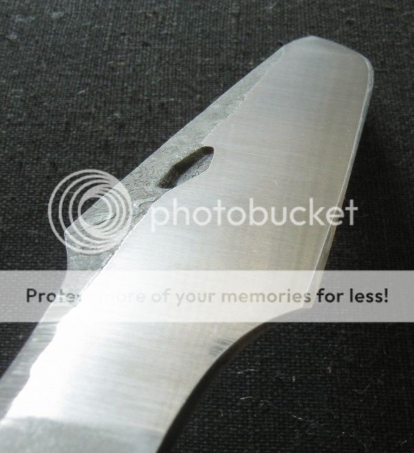

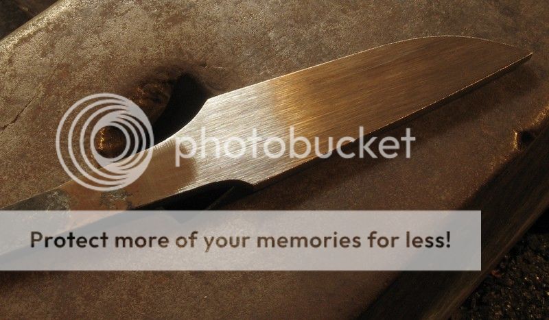

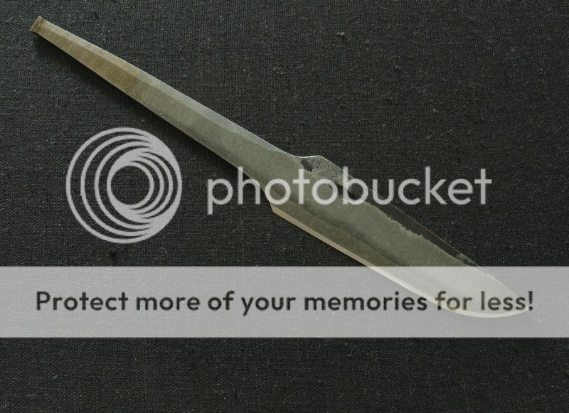

after some grinding, ready for HT

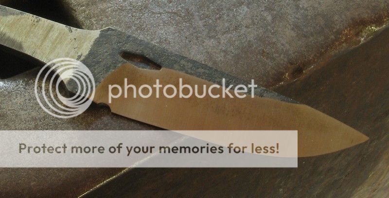

it is a bit slower to grind a bevel after quenching but since I quench in water more blades survive that way.

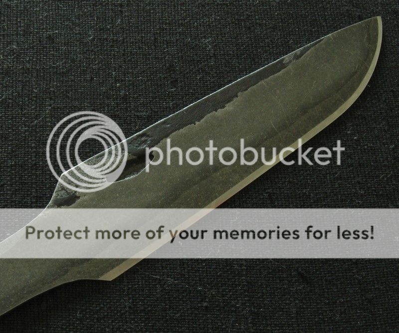

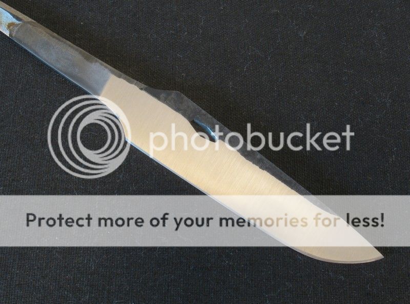

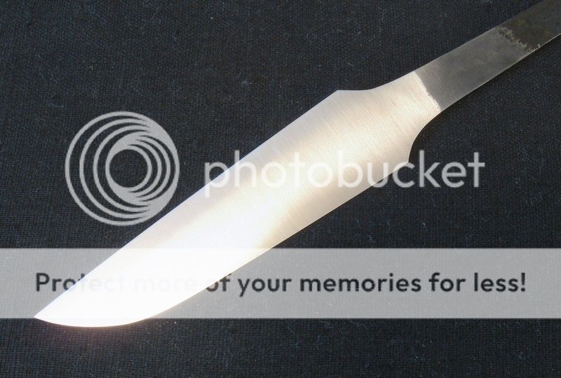

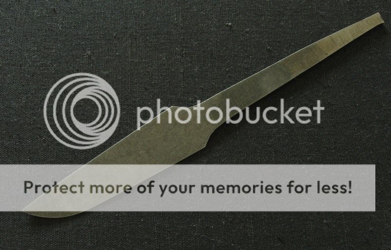

end product...first is finished with stone wash and second with just rough paper (220). since they are meant to be users it think there is no need to go on 2500 grit. maybe later in some special pieces.
they both are around 100 mm, and 60 HRC.
