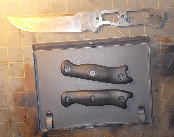

Picture of tweener Micarta next to stock handles.

I seem to like thicker handles than some. I love the Becker handle shapes, but both the full sized ones, and the tweeners need liners for my hand to be comfortable.
But yeah, DVD cases, videogame cases, or even those cheap terrible "cutting boards" they sell at places like walmart can be great liners. Basically you just need something the right thickness that you can cut to shape :).
