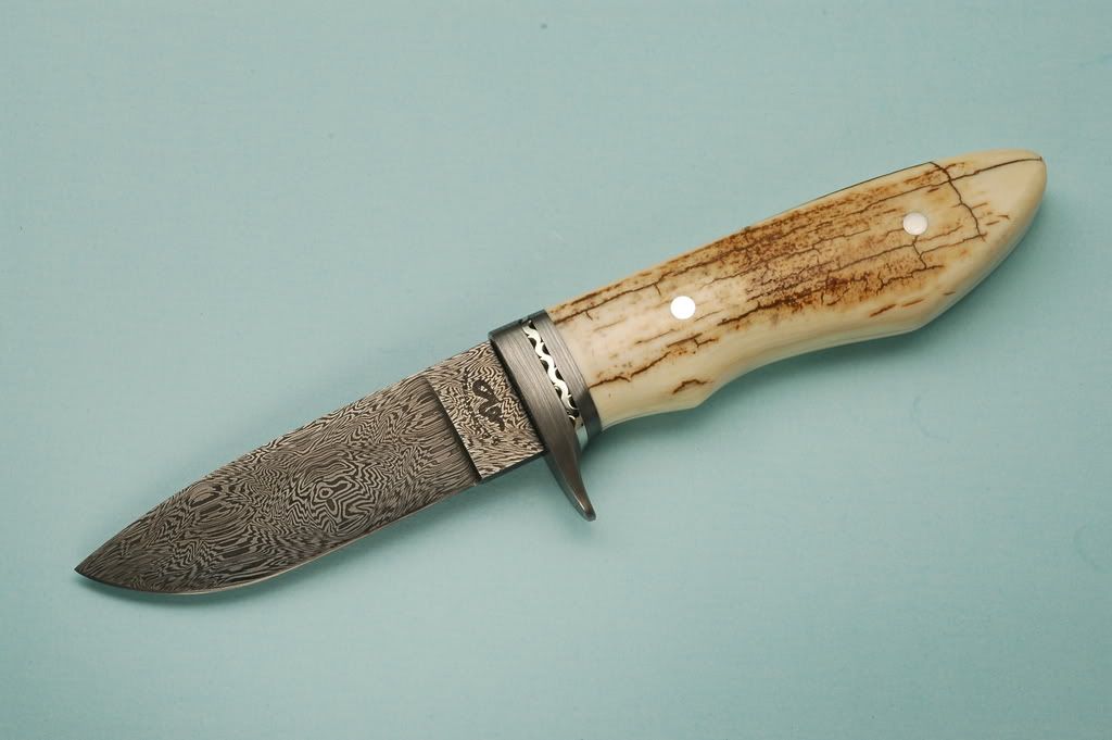

This first one was requested by a client (almost a patron) who wanted a personal hunter for actual use. He wanted damascus and mammoth ivory, but a Loveless shaped blade. Making a fully stock removal blade did not particularly appeal to me, nor does copying another's style too closely. So I made the damascus and forged the tip, put in a bit of a distal taper, and drew out the tang. The rest was indeed stock removal but flat/convex ground instead of hollow ground. We'll see how he likes it after I get a sheath made.
