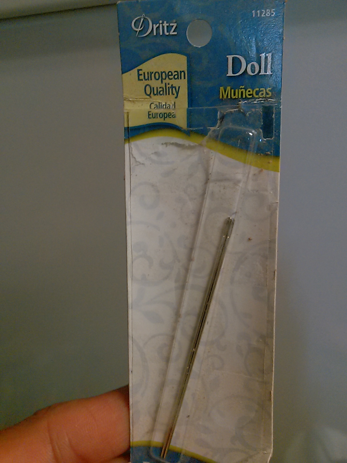

These are my go-to needles.
They can be found at Walmart. I use the largest needle in the pack for 1mm thread and the next size down for .8mm thread. They don't dull, but they do go through a lot of heat cycling. Haven't had one break yet, but I've bought a few packs just in case. I clip them much shorter than they come from the package. They (especially the smaller ones) will wander if you use them full length, but they are perfect if you chop em down.
