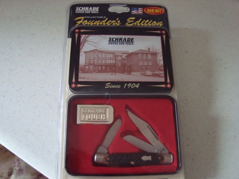

Schrade was known for selling knives in packaging with the knives partially opened.
You would also see it in the displays. So, for as long as these knives would sit on the shelf or in the package, they are partially opened.
I have not had any issues with knives that were packaged that way. But then again, maybe they also weren't intended to sit in the packages for 10 or more years. I open them like that very sparingly, usually for pictures and nothing more.
Glenn
This one had to be like this from at least 2004 to a few months ago...
I wouldn't store my knives like that anyhow though. It is telling though in a way.
