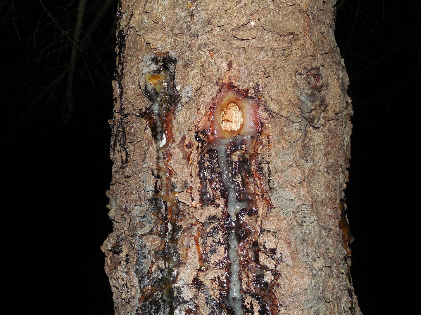

Right by camp there was this guessing naturalized Spruce which must have insulted a woodpecker. Some of these holes get totally filled with pine tar over time which can provide a good amount with little effort.

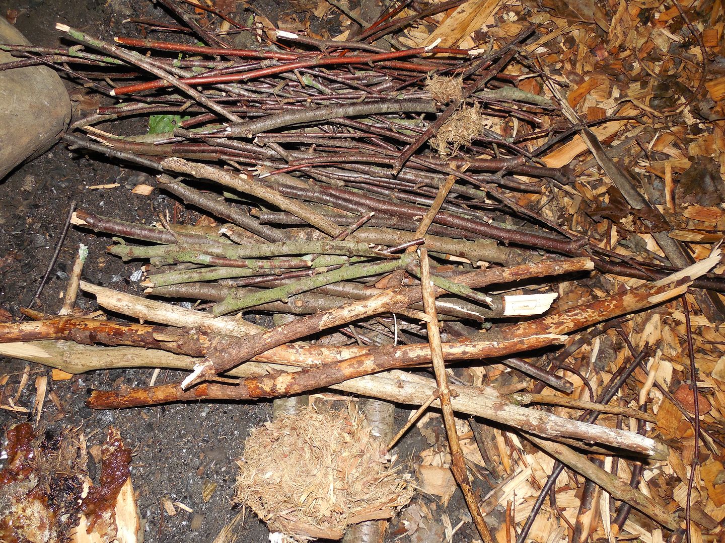

The standard twig fire fuel on a two stick platform. I intended to use this to start a larger fire rather than my sole source of fuel.

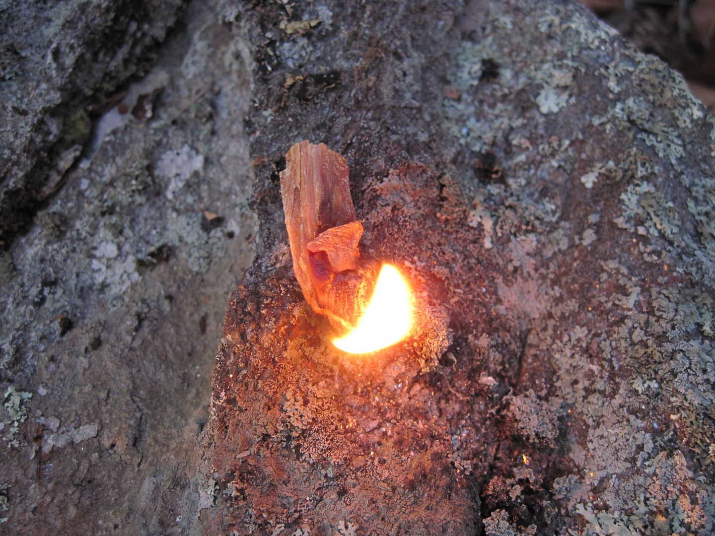

We have a few fire boards and spindles aka proven sets. I used the two stick mullein fireboard. There is a tinder nest made from fluffed up cedar bark.

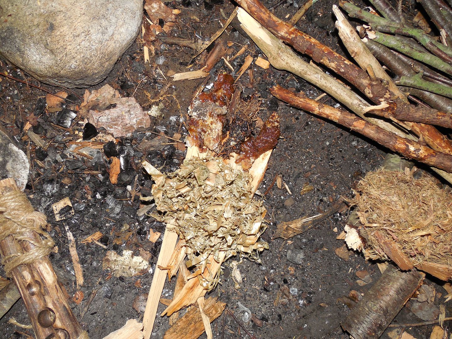

The foraged hydrocarbon laced materials. The sticky nature of pine tar makes putting it on sticks much easier for me to work with.

1. Spin a coal but the source of ignition really doesn't matter.

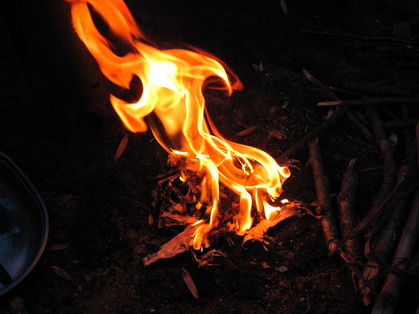

2. Have the Yellow birch bark rapidly expand the flames from the cedar bark.

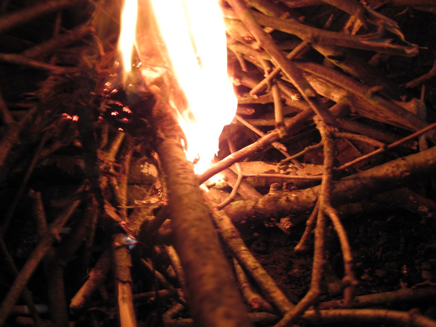

3. Toss on some thin kindling then pine tar to get over waist high flames in a hurry.
The natural foraged accelerants really worked great. Very often they do hence why people use them.
