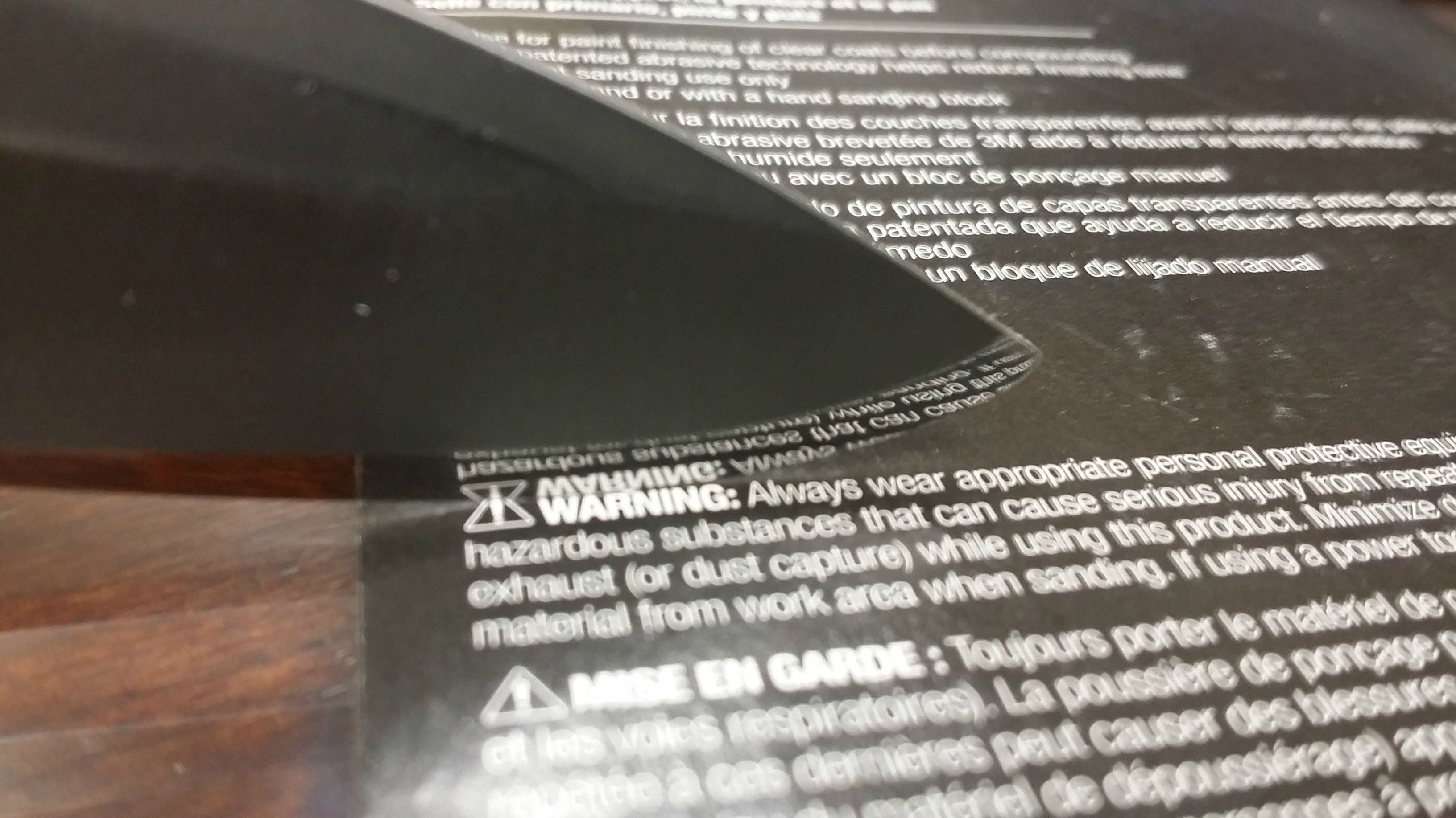

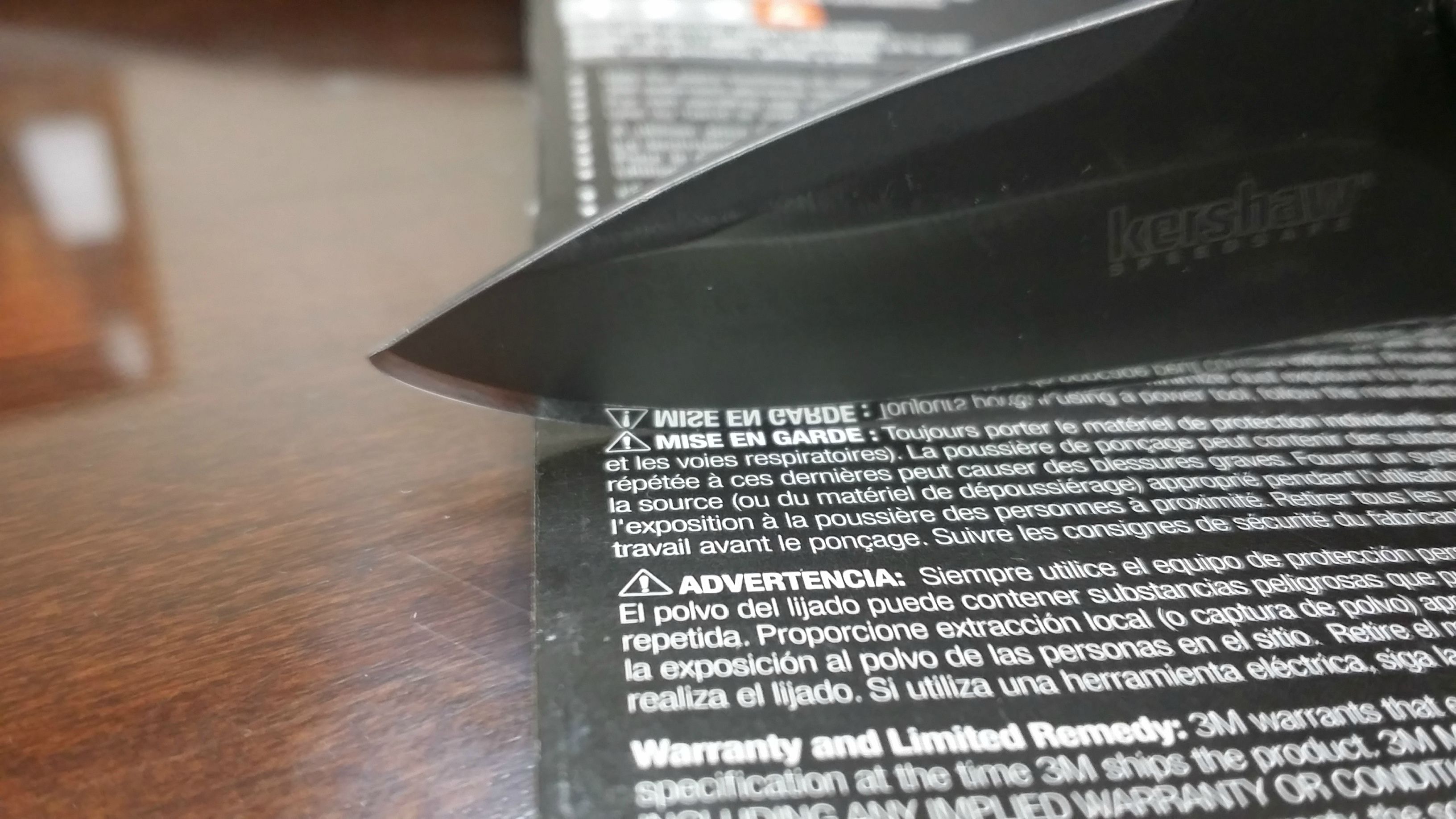

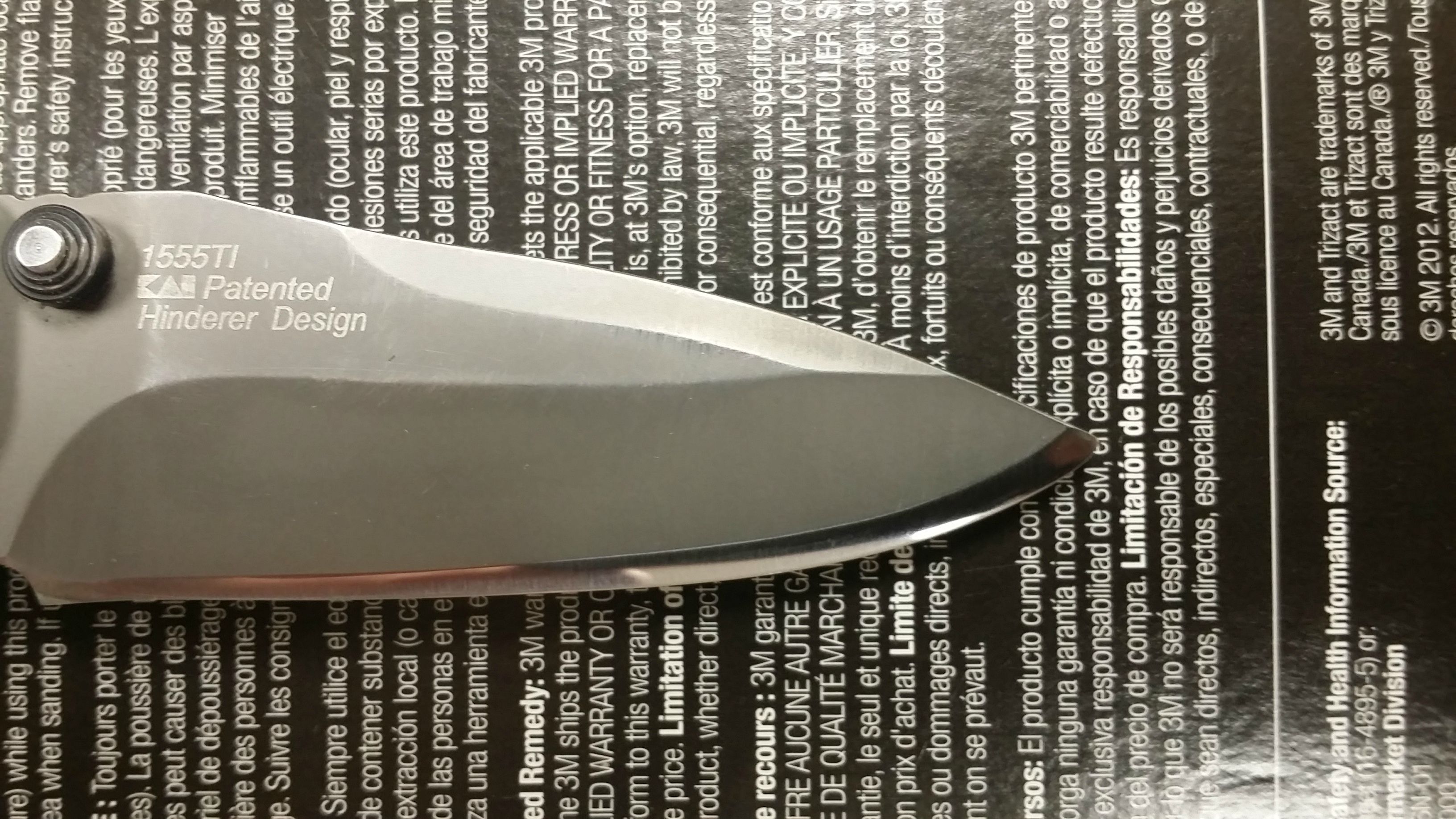

Also, I'm attaching some pics of my EDC that I sharpened a few days ago. It looks great IMO, but I'm running into some real problems with the tip. I'm right-handed, but the finish that I get with my left hand looks much better.
Thoughts?

Kinda hard to tell from your pics, but the easiest way to learn to work the tip area is mark it with a Sharpie, hold the knife in different positions on the table, and learn what position removes metal in what area. Getting all the mods you mentioned won't help unless you learn the basics of how it works. Little practice and I think you'll be fine.
When I was using my Lansky guided system I found that it caused the same exact problem. The guided system is actually forcing you to sharpen the tip unnaturally.
I started free handing my tips and latter I went totally freehand. Why? Because a sharp tip is formed when the stone or blade is tilted. IIRC, the knife is stationary and the stone is moved over it This would make more sense with a pic but I will try. When you are sharpening the knife and the belly the stone lays more or less flat (side to side) in relation to the "primary" grind, or as some people call it, the back bevel. This is the wide bevel that thins the knife from the spine thickness toward the cutting edge. But when you get to the tip, the stone should not be flat. It should be tipped toward the spine (again, I am talking side to side of the stone.) so that the stone is only working the tip! This may seems complicated but it was the easiest thing for me to grasp. Just sit with a knife that still has its tip and a stone a really look at when this comes into play. What I just described is the natural, right way to do it.
Not the best description but at least I tried. If you have any questions just ask.
I'm right handed too and I have to work to keep the bevels on the tips more or less equal. I attribute it to my left hand not being able to hold the knife on the table as consistently as my right hand.
Guess I don't understand this... the stone on the EdgePro (Lansky too) will pivot or rotate side to side, so you can work "just the tip" if you want. Probably the most common error on either device is not setting the position of the knife tip correctly, which can result in an angle change, but that's usually overcome by adjusting the position. (The other common problem is running the stone off the tip which can dull it or change the profile).
The Edge Pro can be pretty close to freehand sharpening in most cases... it's just a reverse of freehand... the knife is held stationary and the stone moves around it. Even the Lansky can do this if the blade is properly positioned. Of course there are exceptions, but they'll handle the majority of knives.
I had to read you question twice to understand what you are saying. But you are correct, the stone can swivel. Maybe force was the wrong word. Maybe I should have said encourage. If you don't know to swivel the stone you will just sharpen the tip the same way that the knife above was sharpened. And you will have the same dull tip. I have a knife like that from my Lansky days. I remember MY biggest problem when I was using the lansky was that I could not see the tip as I was working. So even though I could swivel the stone, I couldn't see if I was doing the tip correctly.
