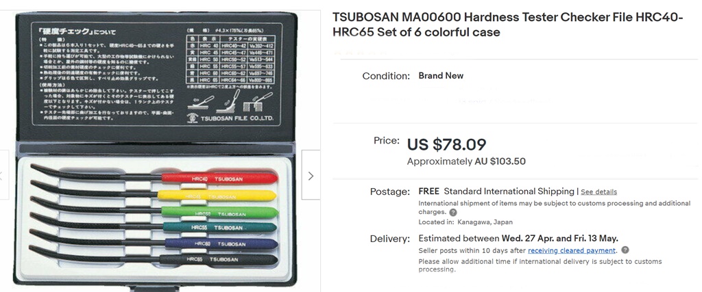

My kingdom for a rockwell hardness tester ... ( I cant afford one )
But my guess is ............ Soft .. Too damned soft !

I did order those Japanese files .. Various Hardness levels for testing steel .
Wont give you a precise result , but at least some idea of how buttery the steel is - or not !
Hmmm looks like my reply to this post never ended up posting. Thanks for the insight. I think that since getting back into knives after almost 10 years I overestimated how much stropping is needed to get an edge back. I think I was over-stropping the hell out of my edges and not getting good results. I used to get amazing stropping results but since coming back I was stropping each side like 10 times, and then moving to the other side and doing 10 more and spending too much time on each side. I really should be doing more like one or two strops on one side and then going to the other side shouldn't I instead? And do that till I get my edge back, or if it's not coming back go back to the stones.
I'll be interested to see how those hardness tester files workout for yea!
