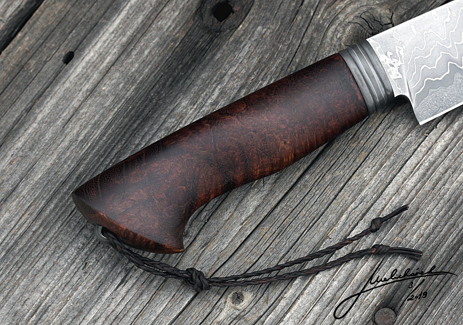

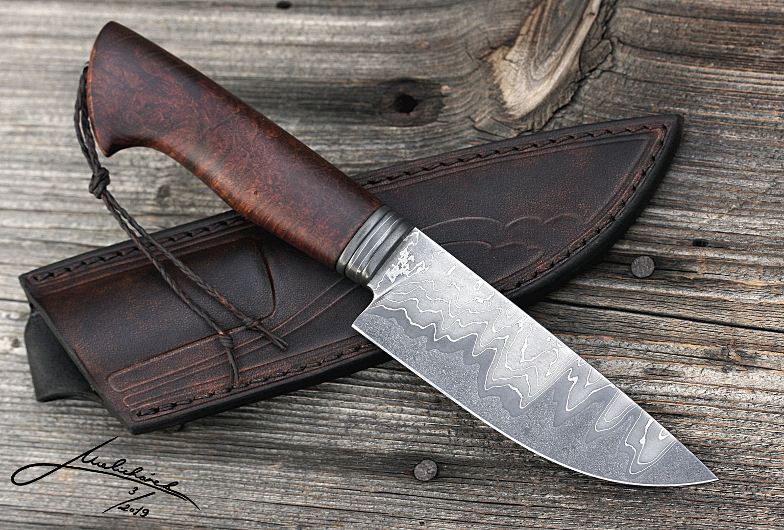

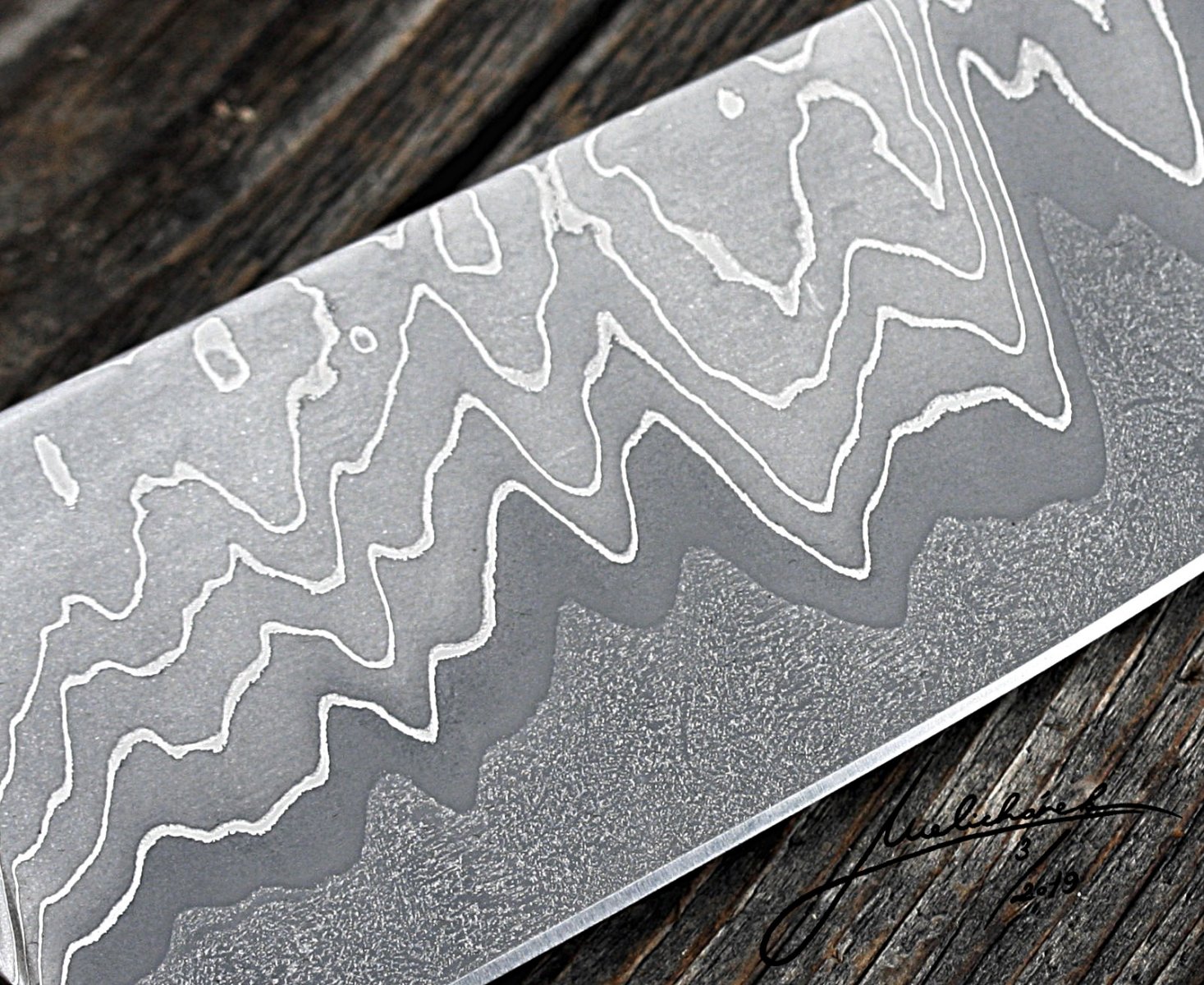

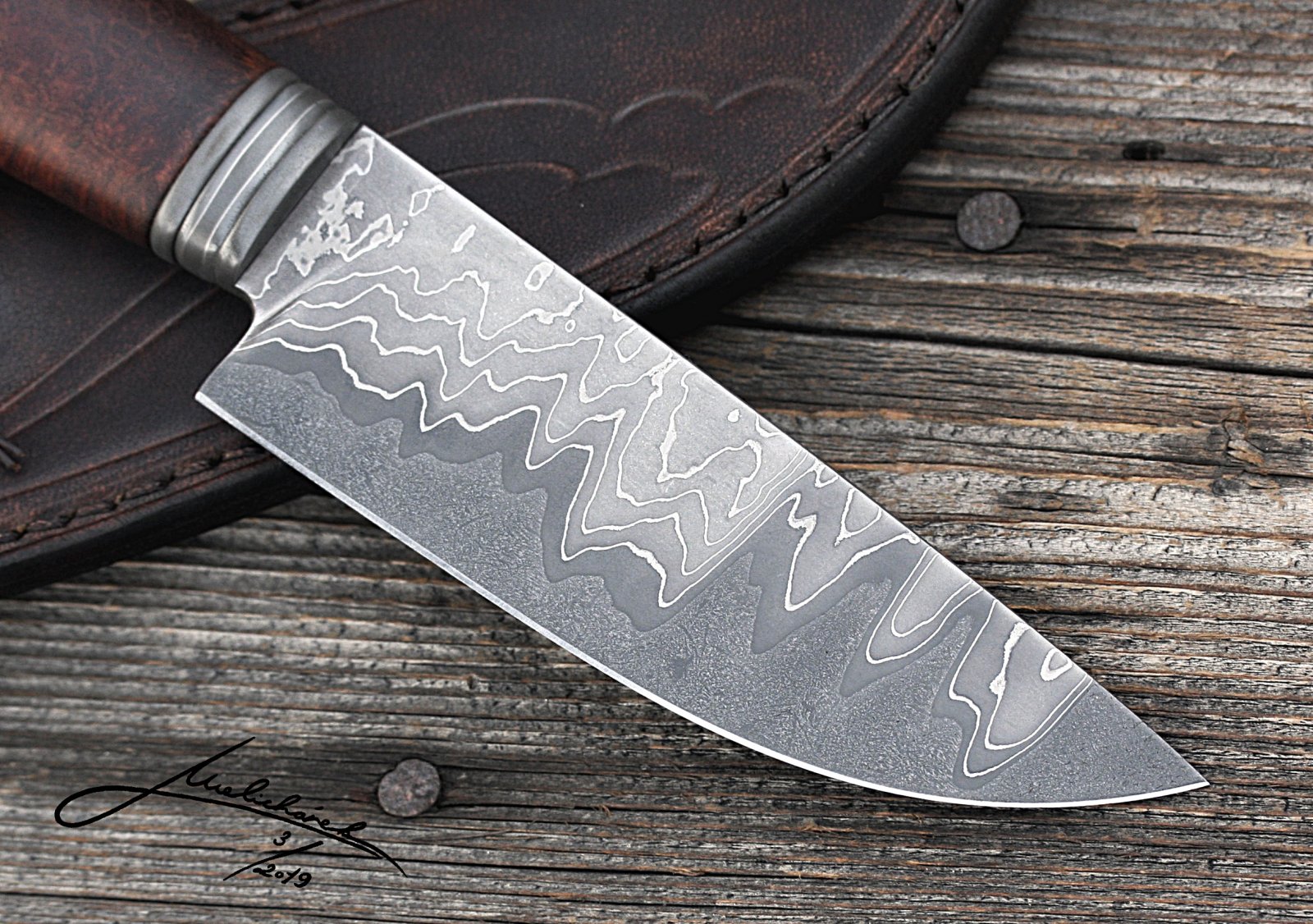

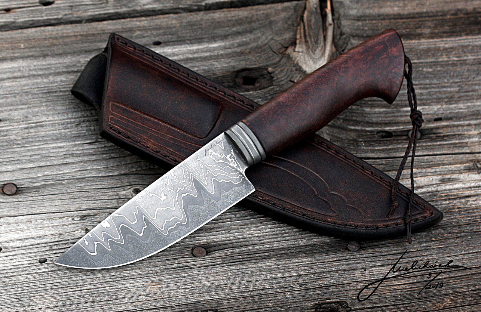

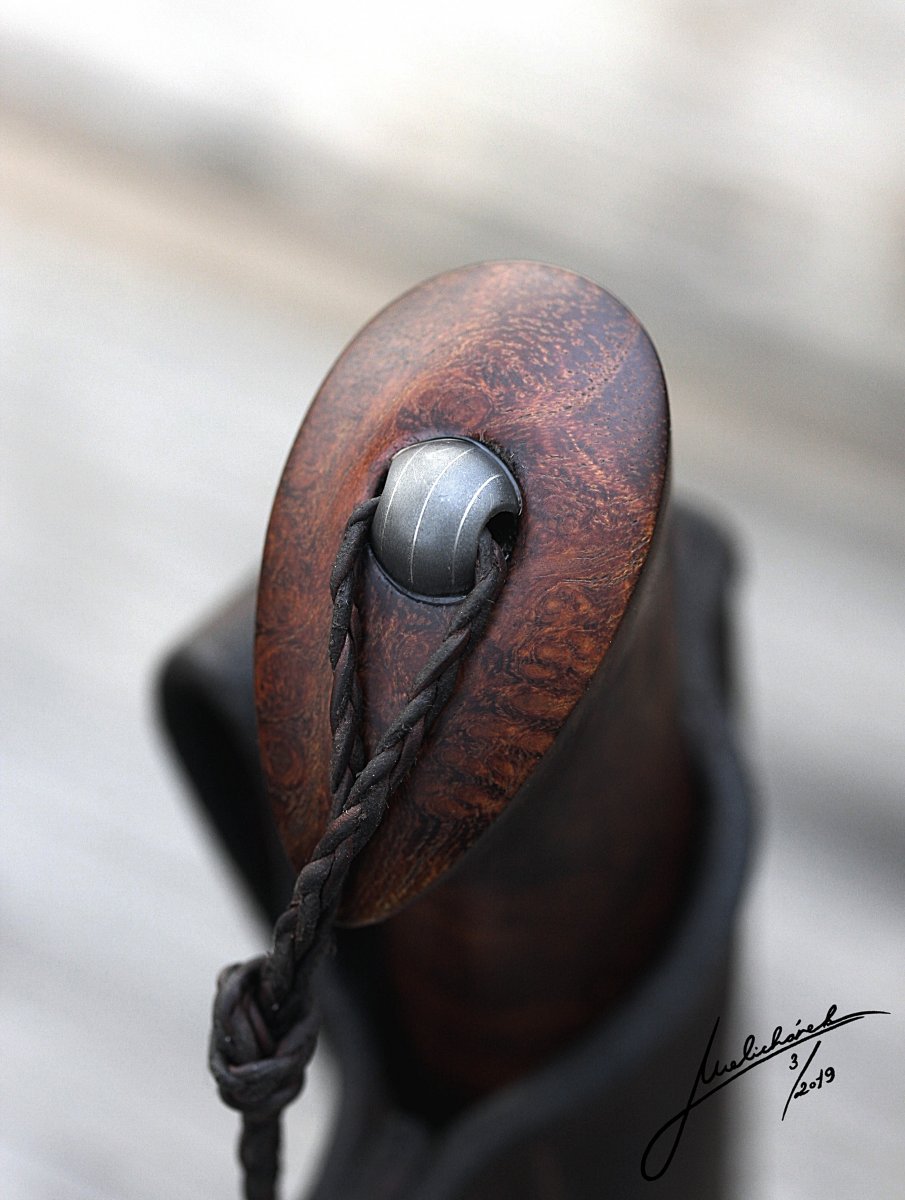

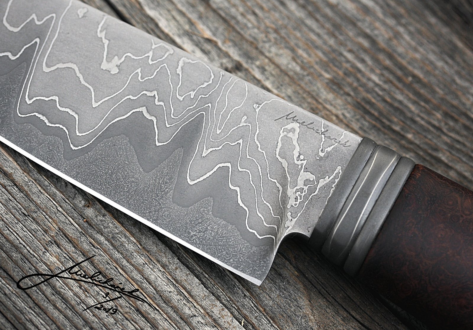

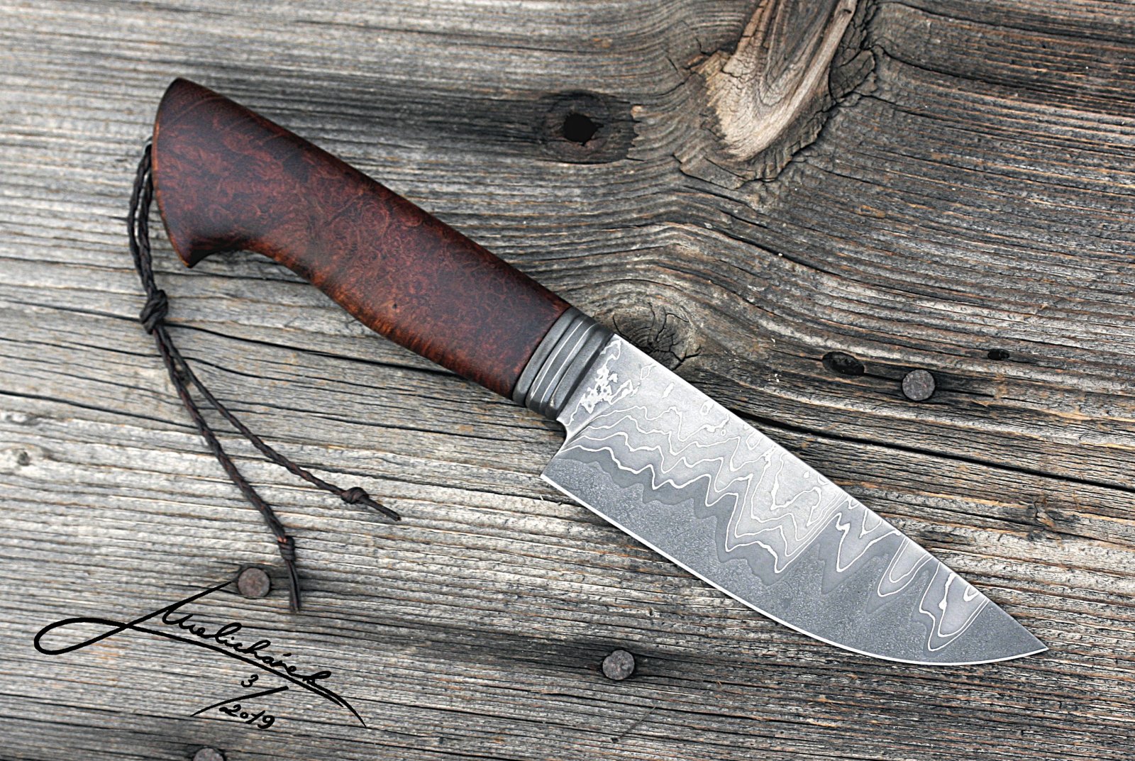

Hi everyone !
Today i finished this hunter knife, with corrosion resistant "san-mai" blade
Thanks for watching and see you with more knives soon
bb Petr
Uira

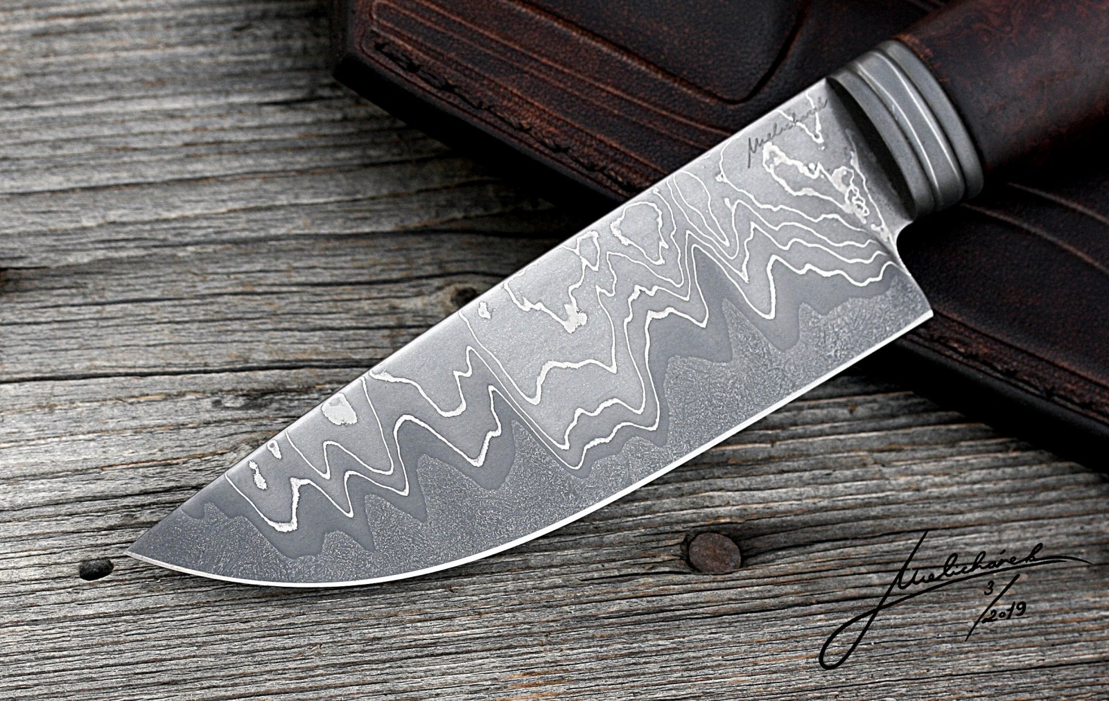

Blade - Corrosion resistant laminated steel- core 1,2379 (D2) + sides 1,2083 + 1,4301

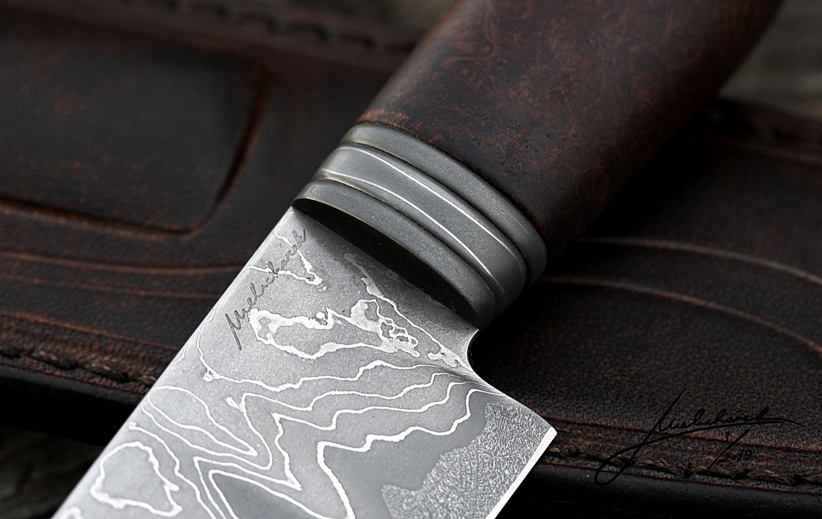

Guard and pommel - Corrosion resistant laminated steel 1,2083 + 1,4301 , D2 rings

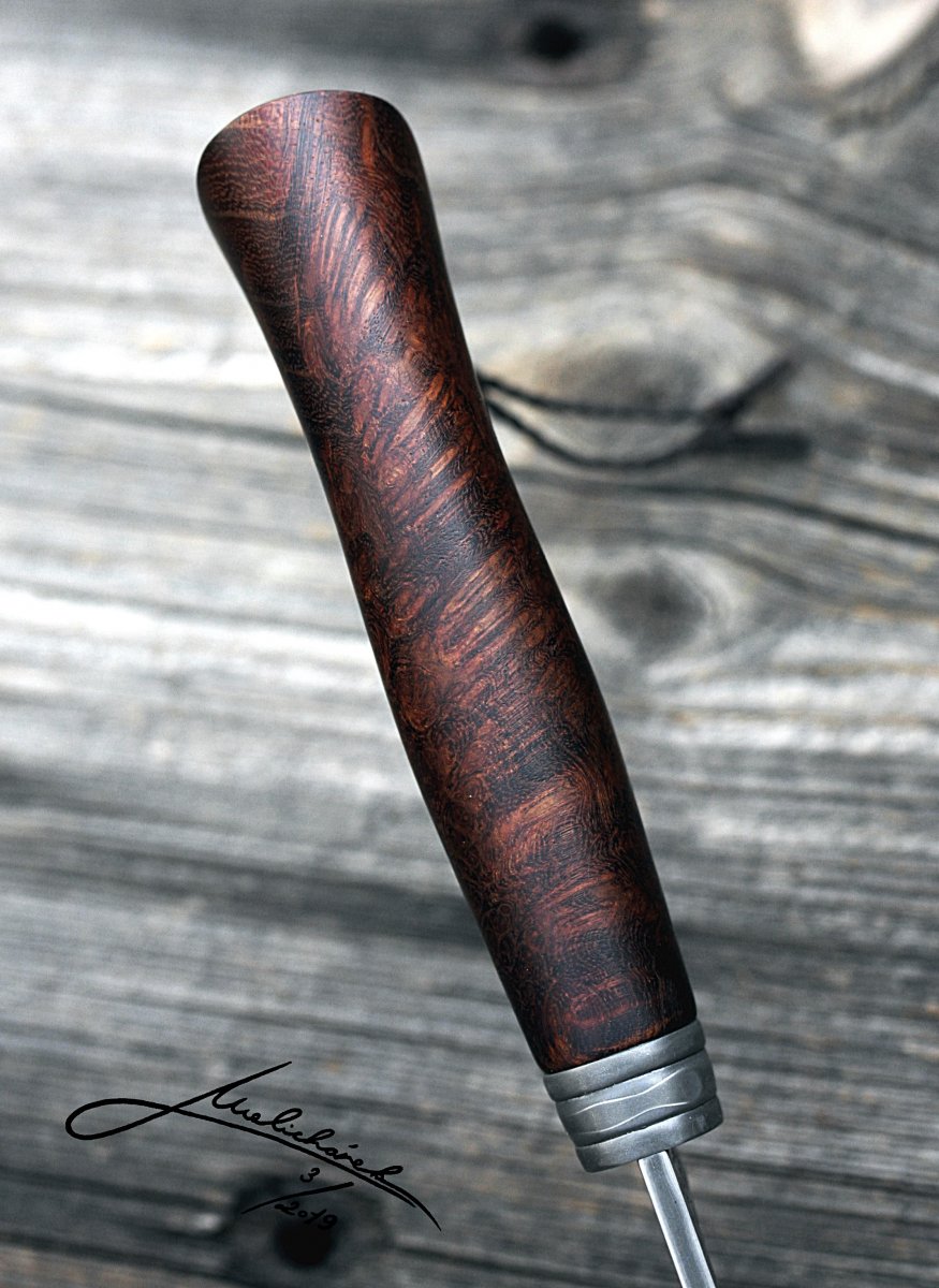

Handle - Black locust burl - "amonia" treated
Average length - 26 cm (approx- 10,24 inches) , blade - 13 cm (approx- 5,12 inches).
Blade width at widest point 40 mm (approx 1,57 inches ) mm , blade thickness 3,8 mm (0,15 inches).
