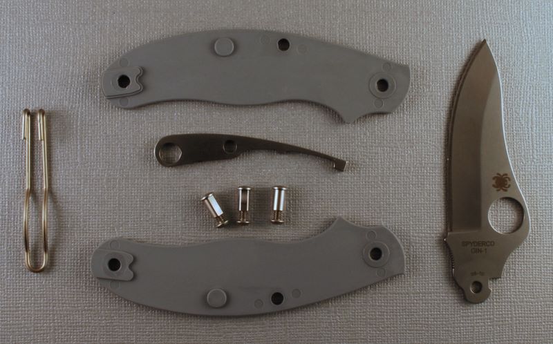

FWIW, this is what one looks like taken apart...

Thanks for posting this picture.
Are all of the screws the same size?

Question for you....how easy are they to put back together?
I want to tumble polish the blade, but I had a hell of a time putting my Stretch back together....nightmare actually :)

I took it apart to send to someone in the UK. Customs over there had actually seized one as a gravity knife :rolleyes: so sending it in pieces seemed the wise thing to do. ;) Gent who got it said it went back together quite easily.
My suggestions to him, based on disassembling it were as follows:
The three D-bolts and screws are all identical, so there's no problems with where they go and all are T-9 Torx, so all you will need is that one driver.
You need to keep the D-bolts on the left, but that should be fairly obvious, given that the holes in the left scale are D shaped while those in the right one are round.
If I were doing it, I'd put the backspring in place first and screw the handle halves together to hold it in place. Next I'd add the clip and clip screw at the rear. Finally, while using a slim object inserted in the handle to press upward on the spring, I'd slide the blade into place and insert it's D bolt. That's really the only "tricky" part and, once the D-Bolt is in place you just need to add the screw to secure it.
Spring is nowhere near as strong as that of the G-10 version, washers are built into the FRN, so there are fewer things to line up, but reassembly is probably easier if you have a vise to hold the "slim jim", or a helper. However, IIRC, he managed without either.

I do, and I don't know if it's just the properties of GIN-1, but it looks dirty for some reason...like patchy dark spots. It's been in the tumbler overnight, I'll pull it out and take some pics. I use treated corn cob, doesn't remove any markings and polishes the blades up nicely with no effort :)
I think the scale pattern looks really good. I hope it gets used on future FRN models.
I got it back together pretty easy, but used a vice to compress when putting in the lock bar pin. I couldn't get it back together putting the blade on last.
