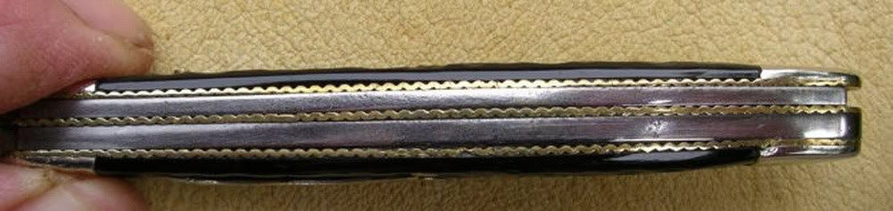

do you think this Hibbard Spencer Bartlett might be an Ulster ?
roland
hi,just an interesting thread and the only liners ive seen like that were the same or close too were on the imitation stag handled kent fish knives,that i collect,any connection,thanks
I can't be sure, but given the handle shape (Camillus maybe?) and the stamp (looks very Ulsterish), but those milled liners look Schradish. I really like the shield too. It sure is a sweet looking knife. Is it a 3 1/4" frame, or 2 3/4"? I can't decide.
it's 3 3/8"; 1/8" longer than my Ulster 58OT, so i guess that rules out Ulster.
roland
