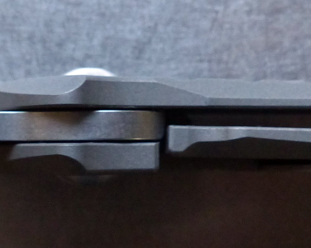

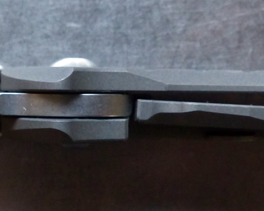

Quick comparison to Southard Tolk.
The handle lengths are quite similar, but Umnumzaan is a tad thicker, while the blade stock thickness is exactly the same.
It is also a tad heavier than Tolk, but does not feel as heavy as Spyderco Gayle Bradley.

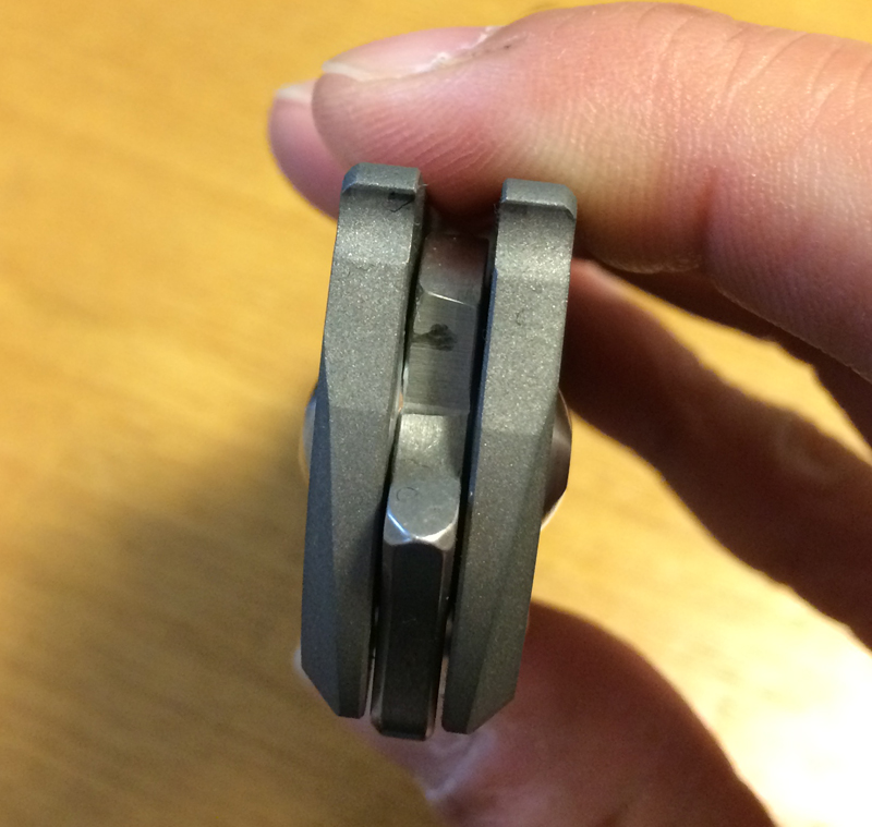

The lockup is about 50%, which is nice.
The lock bar tension is much stronger than that of Tolk, such that my thumb becomes sore a bit from closing it a couple of times.

I thought the lockup is about 50%, but I can push it to 70% after opening/closing few tens of times.
I also see some wears on the blade tang.
Nevertheless, the lock is not sticky, and I guess this is normal for Umnumzaan.

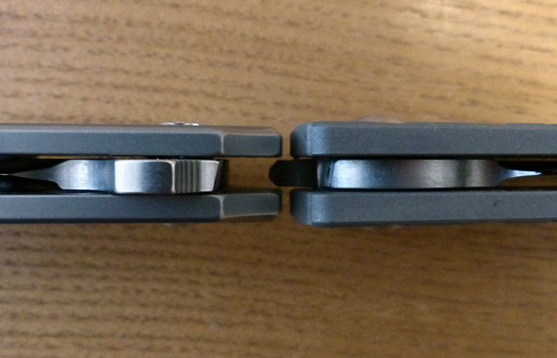

Comparison of similar sized knives with Umnumzaan.
Umnumzaan's handle is a little bit thicker than that of Tolk, but much thinner than Spyderco Galye Bradley's.

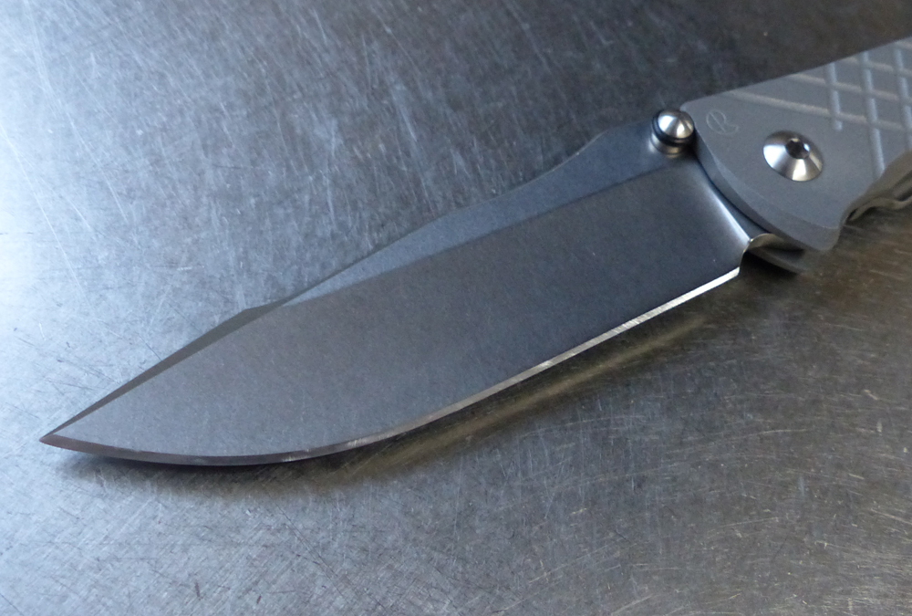

S35VN is new to me.
I reprofiled the edge to 15DPS I believe, and it was not really difficult to do so on EdgePro as compared to M4 or M390.
I initially polished the edge to #2000 but noticed that the edge at #400 seemed quite nice.
I think I am going to stay with this finish for Umnumzaan.
The receipt paper glides through the edge.

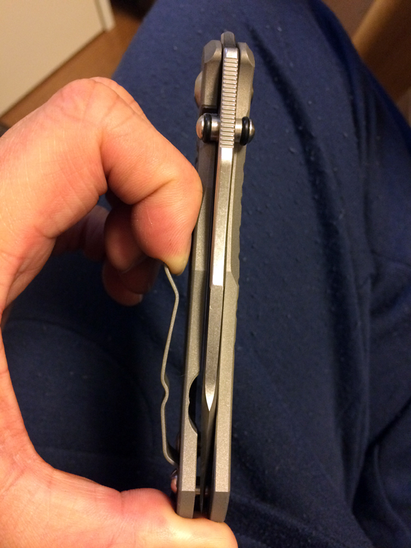

The lock bar tension felt very strong, and disengaging the lock really hurt my thumb.
Then I read a thread describing that the pocket clip may be pushing the lock bar.
http://www.bladeforums.com/forums/showthread.php/447637-Sebenza-Lock-Bar-Tension
Holding the clip away from the spring did make a difference, so I tried to bend the clip to loosen a bit.
After that, it is much easier to disengage the lock, I think.
I don't know if this is a right way to deal with it, but just wanted to share my experience.

Your lockup is perfect. The Umnumzaan uses a Ceramic Ball interface.
Here is a thread where you can see how it works.
http://www.bladeforums.com/forums/showthread.php/883466-Umnumzaan-Macro-Shots
Thank you for the info, marthinus.
Very nice thread.
I understand now that is how the ceramic ball interface works and am quite comfortable with it.

Your lockup seems fine to me, and you will see marks on the lockup surface on the tang, just part of the ballgame on a framelock.
