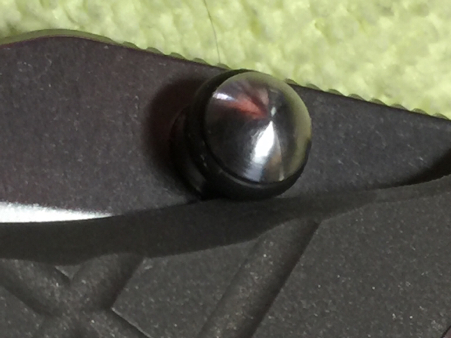

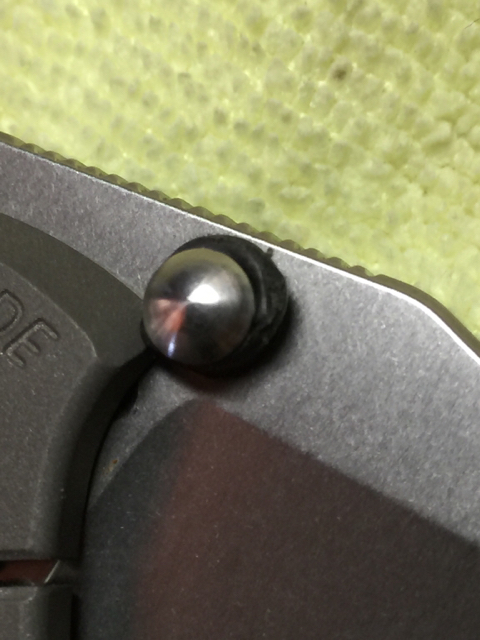

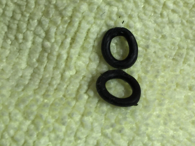

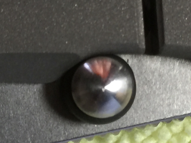

I am sure there is a thread about this somewhere already, and if there is I apologize, but I got an Umnumzaan that had the orings kind of mushy, or maybe spongy is a better word, they went flat as I pushed them with my finger; I had never seen that in the other ones I have; does anyone know what they are made of?

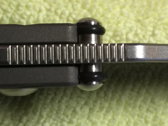

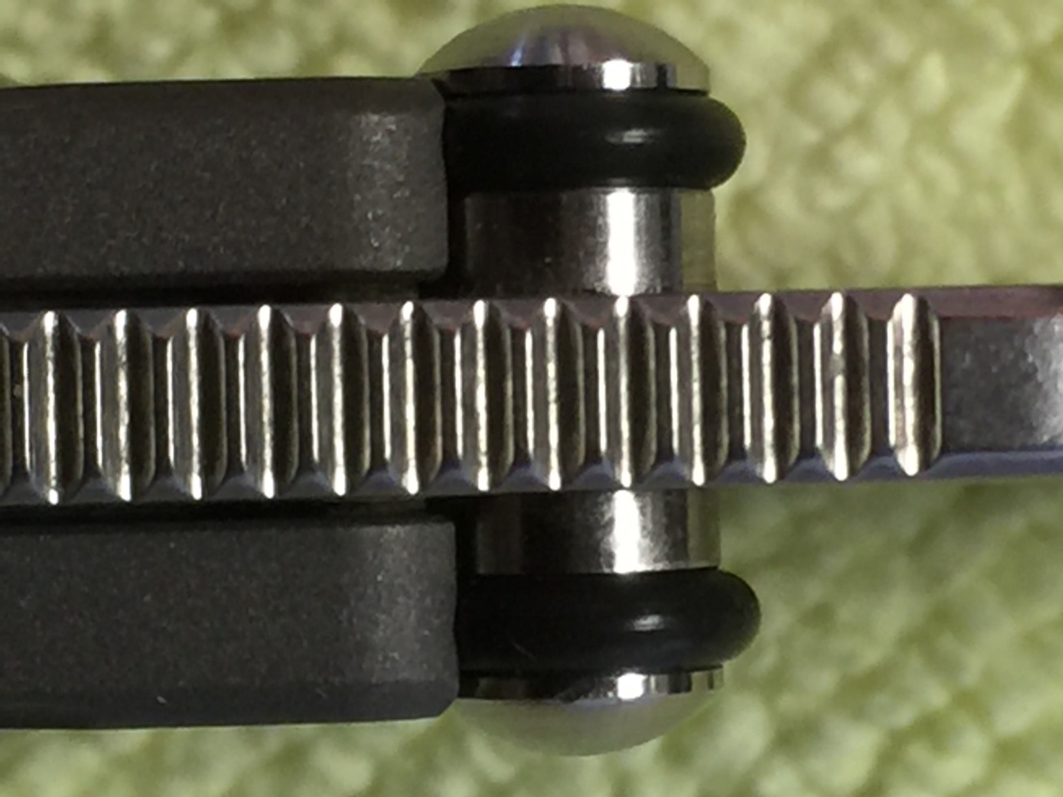

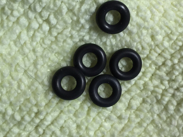

Some kind of rubber I'm sure, maybe buna? It beats me. I was too lazy to call CRK to ask, and to order replacements; so after some measuring I found out that an -006 would fit in the grooves perfectly, so I bought some viton orings a couple of days ago, and they came in the mail today.
Man what a difference!! The blade makes absolutely no noise when I flick it open, nor when I close it; the only thing I hear is the lock bar falling into place when opening the knife.
Here is a picture of the old ones:
And here's the new ones
I can actually see a tiny gap between the stud and the handle when it's closed:
Anyway, I thought I'd post about this and find out if any of you guys have tried non factory orings on your Zaans; so far I like these a lot, they actually do work as shock absorbers; I guess that was the intent of the design but never really felt it work before.
I'd love to hear what you guys think, I'm sure I'm not the first guy doing this, maybe I should have used original parts but these were .04 cents each and they work awesome. Plus viton is some pretty tough stuff. What sayest thou?

I have the viton rings as well and they are a little more firm and quiet than the original rings. Seems like they may last longer, and they cost almost nothing anyway so I have a lifetime supply.
The only slight negative is that I notice the blade does not rest as deeply into the handle when the knife is closed. It feels like is might be possible to snag the tip and open the knife or accidentally puncture something. It hasn't happened to me, it just looks like it might.

You bring up a good point, if you get the wrong size o ring it changes the way the lock engages, it engages earlier, and also the detent ball doesn't fall all the way into the hole in the tang; just got to be careful with the oring size; these are working great for me, and you are correct, viton lasts a long time and withstands very high temperatures as well as many chemicals, you probably already knew that. As always, Chris Reeve thinks about everything, and if he decided to use what is currently being used is because it is probably the best option for this particular application, I don't doubt for a moment that he considered using viton.
There is nothing wrong with the current orings being used by CRK, actually I think they should remain original if possible, I changed them because the ones I had in the knife I got were deteriorating, which leads me to believe that they were changed to another material by a previous owner, because I haven't seen this happen with my other zaans.
Pretty sure I have the right size, its just that the viton is a little firmer that the original. The lockup (and detent) works great but with almost no sound at all.

Yeah, it's kind of confusing how they did the numbering for orings, as long as you get an -006, (that is dash zero zero six) they should fit; it took a little measuring, here is the info just in case:
ID: .114 plus or minus .005
OD: .250
Width: .070 plus or minus .003
Or ID is 1/8 and OD is 1/4, but don't get confused and just get a -006, the SAE numbers are in inches and o-ring size is determined by the AS568A spec, and so on. And the sizes are called "dash" whatever, like in -006.
There are also metric sizes, but ignore those unless you like to play with conversions.
Sorry, not trying to make this a mechanical issue, or complicate it more than it needs to be; I'm a mechanic by trade so I tend to over analyze everything.
Also it is a good practice to use some silicon grease on them before you put them in.
I hope that helps.
