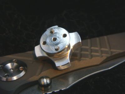

Thank you for posting that link. I'm refining my take down tool and whenever I have it where I want it, I may post it again. I was disappointed also that I couldn't just simply purchase the tool. I emailed CRK with no response so...my tool.

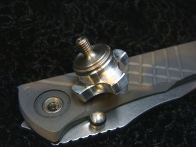

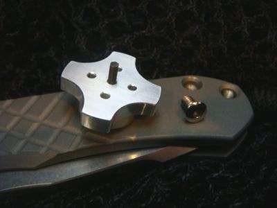

Thanks for posting. Your takedown tool sure looks like a winner...Any available?
Hope you don't mind me posting pix of your nice work.
The post is long overdue...I have not been on BF but briefly now and then. How things have changed!
The pivot tool has changed many times since the version you posted.. As far as availability- I cannot answer this question in the CRK forum. PM is best for all involved. I hope you understand. Just not the place to do so.
