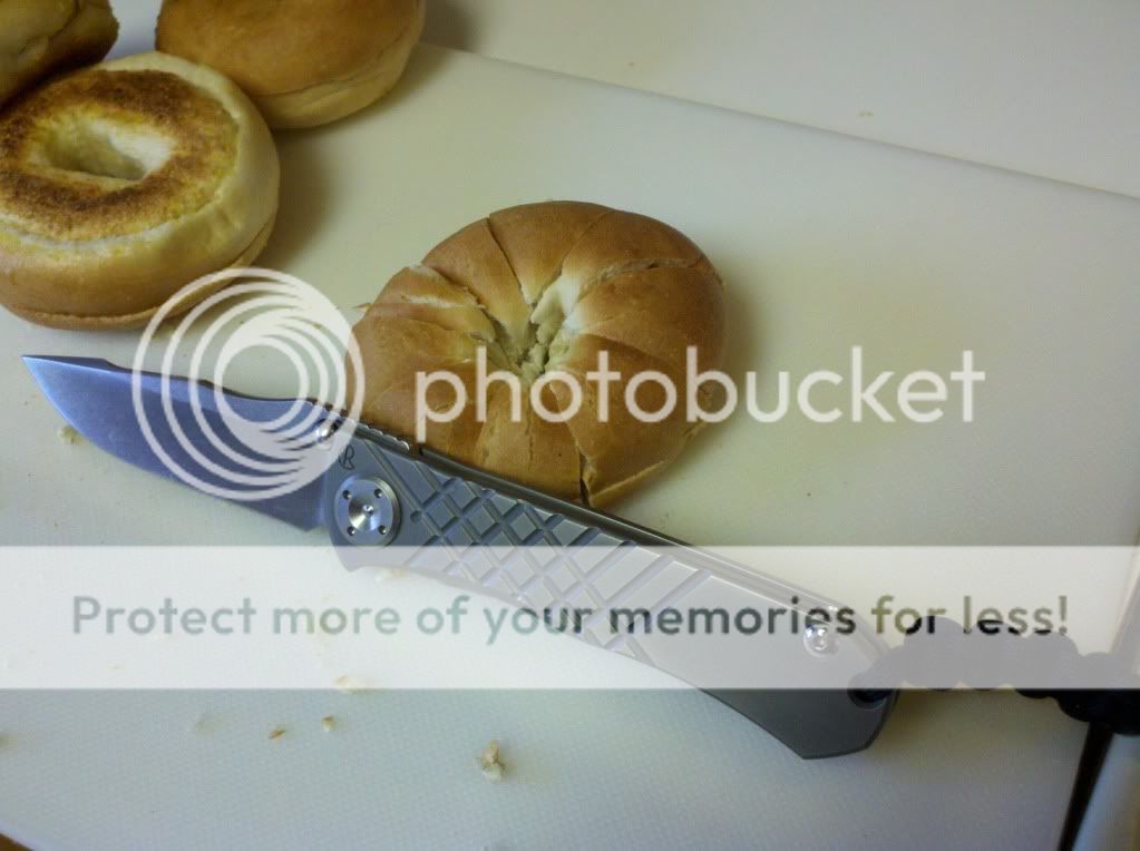

Just wondering what needs to be done to polish the scales on the umnumzaan... is it just simple sand paper up to a finer grit?
Im thinking about doing it to mine, but am a bit worried I may screw it up beyond repair...
Also, ive seen others sanded down umnumzaan's (in this one case, just to remove the grip pattern) and it still looked grey like stock, just without the grooves...
So, those that polished theirs... did you do it on the stock titanium scales?
Thanks a bunch!

This looks like a Scotch Brite treatment to me. I'm not positive thought.
That would be correct. Sandpaper would look polished. That looks great compared to mine..At least I don't have to worry about mine getting scratches anymore :D
I always just reblast mine with glass beads, It is a alot smoother than the original finish.
I have been using super fine steel wool (#0000) on my Sebenzas.
It gives them that nice worn look.
You can also use an industural eraser (like the ones they sell to clean crock-sticks) Gives it a nice look too. Sorry I don't have a better picture at the moment. Hope this helps.
I just used some Scotch bright on my zaan tAke off a ton if scratches. Looks just Like that one in the pic

I used 320 wet/dry paper and finished with '0000' steel wool.
Ive used scotchbright on others and it works well also. The steel wool really smooths it out as a last step. The key is to not be too aggressive and take your time, Ti is fairly soft.
