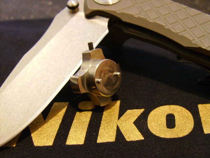

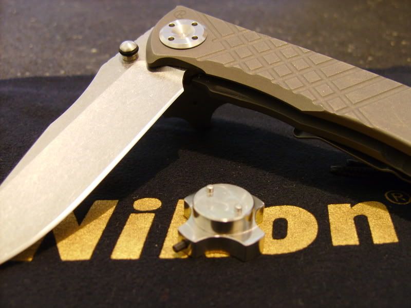

This thread is too long to go without pictures of the original tool. I recall seeing it, but can't seem to find it anywhere.
Here is a picture of mine made by Bill Hyde
