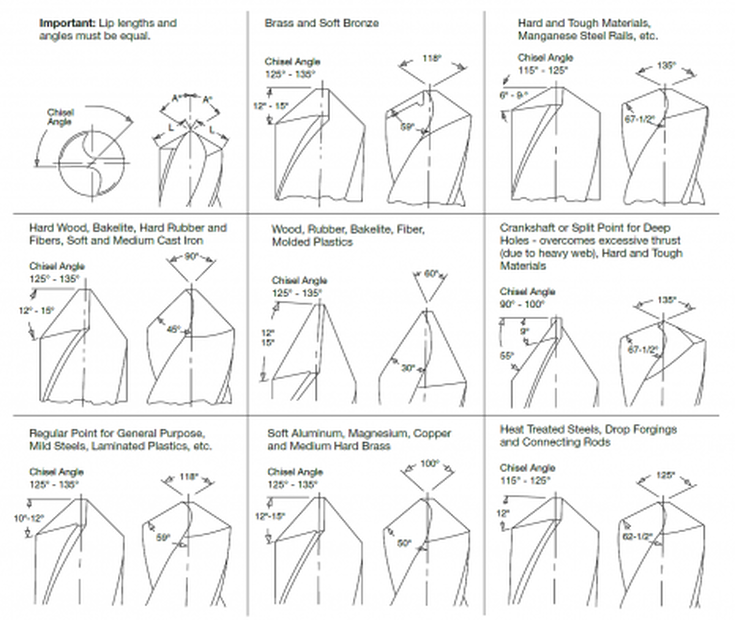

Another thing that makes drilling a problem is the wrong bits. You want good metal drilling bits. Cheap sets are often useless for metal drilling. Most are "universal angle" which is 118°. That works for wood and soft metal, but will do poorly on steel and not at all on stainless steel. You would want a 135° tip angle for knife work in steel. A set of Drill Hog bits isn't cheap, but will last a long time. If you only need drill bits for knife work, buying 10-packs of stub-length bits in three sizes is the smartest thing to do -1/8", 3/16", 1/4"

Actually 118 deg carbide drills are almost unheard of. 140 degrees is the most common by far and the SGS 3 fluters are 150 degrees.
The closer you get to 180 degrees the straighter and more accurately located the hole will be. (Less wondering upon starting) Carbide drills are made for high performance and accuracy so they tend to be flatter. This isn’t a concern when using a drill press though as there are many other factors limiting the performance of the drill.
118 degree drills tend to not perform as well because they typically are not split point drills. So it doesn’t have as much to do with the angle as it does the grind of the cutting edge. 118 degree steel drills can punch holes in stainless steel all day long in the correct application.

I agree that 140° would drill better. Thanks for te info.
I checked, and all the carbide bits I have are 118°.
I looked online and see both angles on Granger and other suppliers. I guess I never noticed the 140° option when I bought the ones I have. I'll definitely look at that spec when ordering again.
Here’s an interesting bit of info I found about drill bits.
