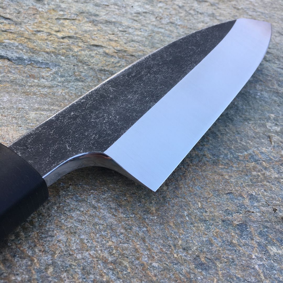

I don't make many kitchen knives and almost all of them go to Eatingtools in Brooklyn.
Here are a couple firsts for me. A Deba and a less common Unagisaki, which is used specifically for filleting/butchering eel. They are both CPM 3V, chisel ground with hollow backsides. The thick spines and choil are generously rounded and polished.
The Unagi has some of my shop made rag micarta and an antique black micarta bolster.

Very cool, Ben! I always enjoy seeing the variety of knives you make as you always know how make them your own, and they always turn out great. I hope you share more of you kitchen cutlery here in the future. For whatever it's worth, I've always found that large bevel/chamfer at the choils on the thicker Japanese kitchen knives to be very appealing.

They are very visually appealing for sure, and quite comfortable as well!

those ura look lovely!
Thank you Dave. It was a first for me. Blending it put with only a 12" wheel was tricky!
