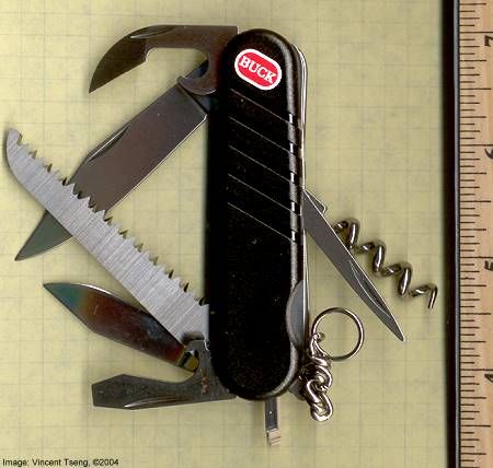

I have always regarded Wengers equal in quality to Victorinox SAKs (Swiss Army Knives) - just that I had a personal preference for Victorinox.
BUT - UNBELIEVABLE!!! Dept....
From doing the all tools open photo of a SwissBuck (made by Wenger) -
for just those few minutes - would you believe that it has severely weakened the backspring on the main blade/small blade/corkscrew?
I wouldn't have either -

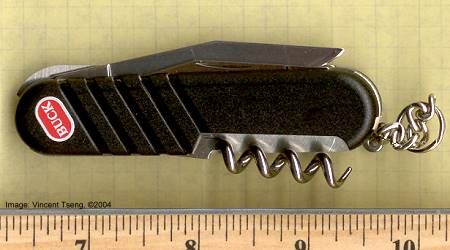

except BOTH the main and small blades now have play in the open-close direction when fully open - the corkscrew will not snap back into the place....
and I am not exaggerating - I have obviously tried to cure this by well lubing the joints, to not much improvement -
Here's the proof -
Look at the positions of the corkscrew and main blade - no, I have not propped those tools open - try that on any Victorinox and it's just not possible as those tools would have snapped shut long ago......
Now this might just explain why the nailfiles on my like new Wenger Cyclist and used "Forrester" now have play in the open-close direction when fully open - since I had all the tools open for photos on both of them.
If you have access to SOSAK - please see this thread
UNBELIEVABLE! - and that's put a severe negative connotation for me on the quality of Wengers......

I really would not have thought what happened was possible -
BUT if you're willing to risk it -
please try opening all the tools like in the photo above -
leave them like that for about 10-15 minutes -
then close all the tools and see if you've managed to induce any play in the nailfile/small blade, main blade or weaken the snap of the corkscrew -
but please beware that there is a risk........

Just to be clear this is NOT an isolated incident -
It was just that I was not aware of this problem until this particular SwissBuck -
I have had TWO (other) regular Wengers backsprings severely weaken due to opening all the tools half-way.
A "like new" Wenger Cyclist and a used "Forrester" where the effect was noticable play in the nailfile in the open-close direction when fully opened - they are still that way.
(Now that I think about it, I'm pretty sure I would have noticed any play in the nailfile before now - since I normally check the action of all the tools - especially on the Cyclist that I've had for a number of years from new.)
I did not suspect the backspring weakening from the mere few minutes of having all the tools half open - to take photos literally only takes me a few minutes - 10-15 minutes MAX - as I use a scanner attached to my computer - and I am so used to doing these photos that it's "routine".
I have definitely done this to numerous Victorinox SAKs with no noted detrimental effects -
I have only done it to 7 Wengers - and 3 of them now exhibit play - or weakened backsprings.
I do realize that 7 is hardly a large sample - but 3 out of 7 even if it may not be statistically significant -
it's terrible for me - I now have 3 Wengers (one of them is the SwissBuck) that I now consider marginal.
I never would have thought this - why would I have bought so many used Wengers at a time - if I didn't think Wengers were basically "equals" of Victorinox at least in action/quality?
As of right now I am very disappointed with Wengers.....
and I am very UNlikely to want to buy another Wenger, right now......
FWIW -
It makes a difference whether the tools are all opened fully or half-way -
Look closely at the action of the backspring when opening or closing the knife -
Opening the all the tools does NOT put stress on the backsprings - if FULLY opened -
it's opening the tools HALF-WAY (like in my photos) - that puts stress on the backsprings
The main blade, small blade (or nailfile) and corkscrew (or phillips) combination opened HALF-WAY puts maximum stress on that backspring in opposing directions.
Try THAT and leave it for about half an hour and see if it weakens the backspring noticably.....
again please be warned that I consider it risky, and it may "ruin" your Wenger SAK......
