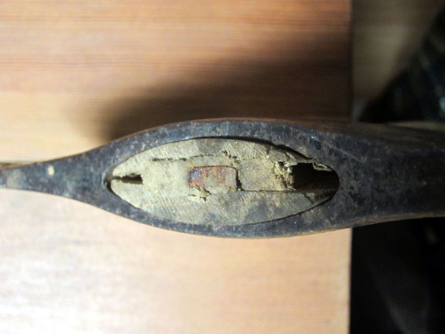

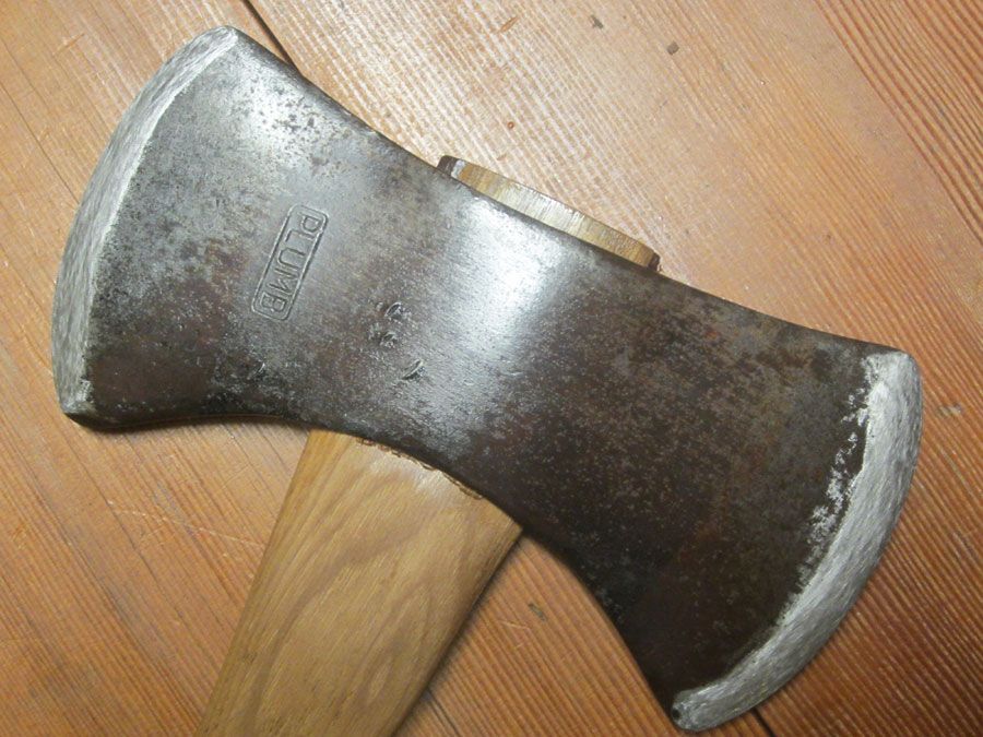

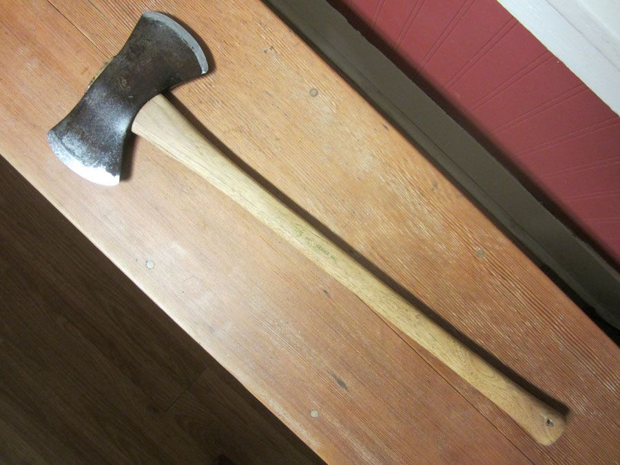

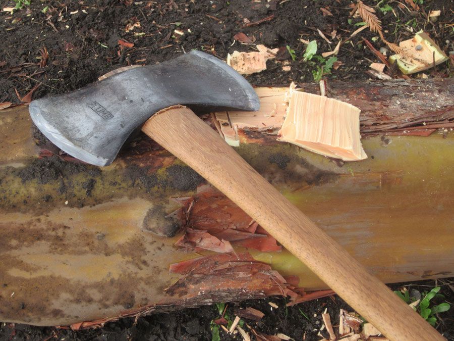

Uncle Don's Plumb cruiser came home with me yesterday. First, I seperated the head from the haft. Then I cleaned up the haft to be reused. The head was sharpened and nothing else was done to the head. It got re-hung using walnut for the wedge. A coat of BLO was applied to the haft. Thats it.

The head weighed in at 2lb 10oz and after the re-hang the total length is 27". Now it just needs a sheath and then it can live in my truck. I can't wait to come across something I can chop or limb with it. :cool:

I don't know yet. I haven't even swung it yet. The haft is quite narrow at nine sixteens by an inch and a quarter at about 6 inches from the end knob. It thickens back up through the grip so it feels pretty good to hold. I am going to put a couple more coats of blo on it before I take it for a test drive.

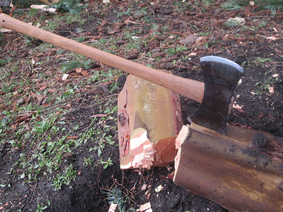

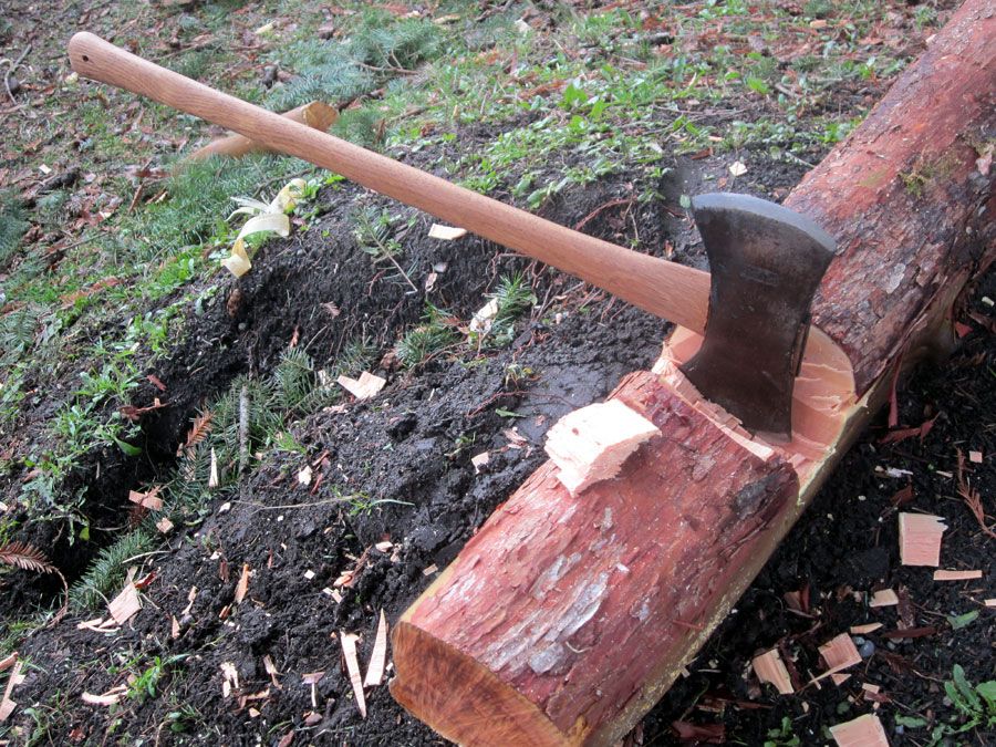

Its all ready for life in the truck now. I put a couple more coats of blo on it, 3 coats of tung oil and another buffing with the honing stone. I took it out for a test drive today. Well, it never left the yard but you get the idea.
It chopped through some wet madrona and was a pleasure to swing. Extremely accurate. I was acutely aware of that second bit but I suppose I will get used to it.

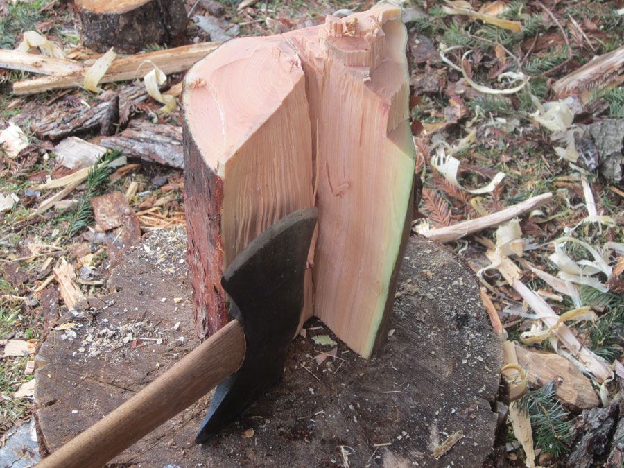

Splitting with it was an interesting sensation as if felt more like it was slicing the wood. I really didn't expect this cruiser to be much of a splitter. Boy was I wrong. Now I will need to find me a little bit taller chopping block.
I have a feeling it will be a slick limbing axe too.
I did notice after using it for a little while the head was coming loose so I reset the head and drove the wedge back in. I kept an eye on it and noticed that it kept coming loose or slowly slipping toward the end of the haft. I drove the head further onto the haft and sank the wedge even deeper. Hopefully this will rectify the problem. I did have the axe behind the wood stove while putting on the coats of blo and tung oil for almost a week. I am hoping that out in the truck the head stay put. I will be keeping a close eye on it for awhile.
